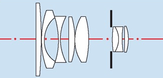

The 135 macro is a Heliar type design - and makes a whole lot more sense when you realise that it's intended to deliver a 1:1 repro size in an 8x10 print, not on the neg (which essentially every amateurish reviewer seems not to have managed to grasp).

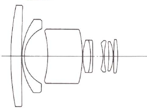

The cause of the gigantism of the 75/4.5 and the 55/3.5 is immediately obvious from their cross section - they are quite early retrofocus designs, and you can see pretty clearly what they are retrofocus derivatives of (e.g. the 75/4.5 is evolved from a tessar core).

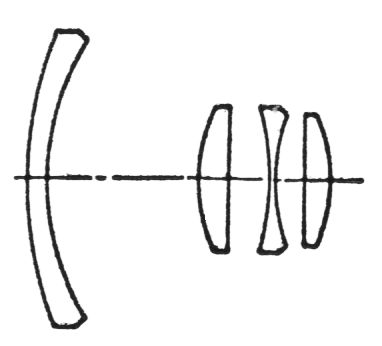

The 75/4.5 indeed is an early retrofocus design, very early.

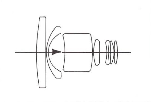

It is similar to the Super-Takumar 35/3.5 for full frame, which itself traces back to the first japanese SLR wideangle, a Takumar 35/4 from 1957
Which in turn is similar to a slightly earlier Voigtlander Skoparon (35 mm f/3.5, 1952)
Which in turn, evolves over this thing:

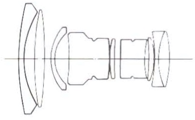

Now, the 6x7 55/3.5 is far more advanced, relatively speaking. The design comes from the 28/3.5, a patent from 1966 and at that point in time far more advanced (and compact) than the designs from Canon and Nikon. It does not really follow the early (angenieux) retrofocus designs. This Pentax design follows the (then) new theory of using long (thick) lens elements to reduce the dimensions of the front element. The Nikon blog "Nikkor - the thousand and one nights" talks about this strategy as well.
28/3.5 S-T (1966)
55/3.5 (1970), almost the same design except for a cemented 4th group.

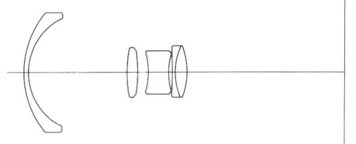

The Pentax 6x7 55/4.0 that overhauled the 6x7 55/3.5 is a different design yet it follows the same philosophy of using long (thick) elements. It was obviously designed with compactness in mind.
The 67 55/4.0 that followed the 6x7 55/4.0 is an entirely different design.
