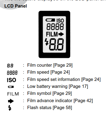

Battery is fine. I wish the 67II had a battery check though. The old 67 does.
