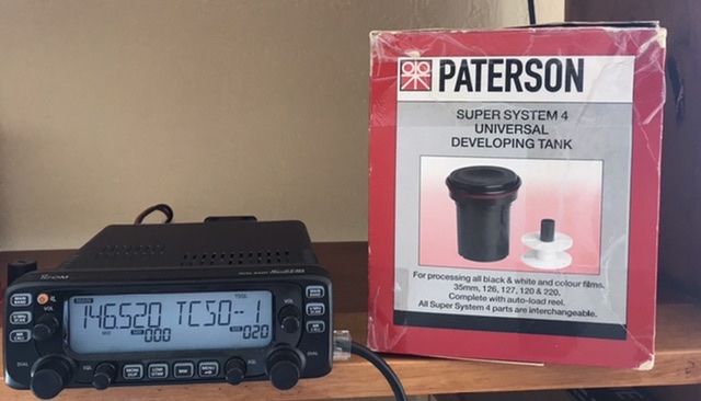

I use a Paterson System IV tank and reels. I never use the lid but yeah, it is stiff and that makes it difficult.

Is it a System IV tank and reels - discontinued in 1989 I think - or the current Super System IV version?
Why they didn't call it System V, I've never figured out.

Indeed. I have both System IV and Super System IV but only ever use the latter and...yeah, why didn’t they call it System V? Maybe they wanted to indicate that the new stuff was/is compatible with the the older? IDK.
