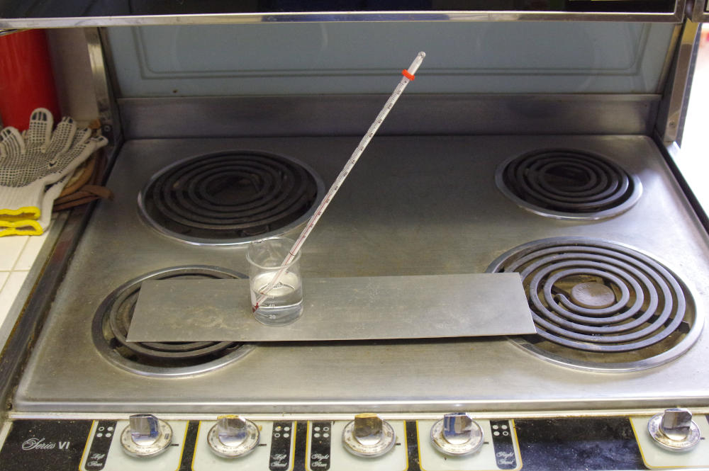

My chemicals are 8-10 years old, and some are suspect because they were stored in bottles made of HDPE instead of glass or PET. The Phenidone turned light orange when dissolved in PG, making me suspect that my old PG has some water in it. When mixed with stock solution, the orange vanished because the sulfite restored the phenidone.
I don't have a hot plate, so I used a strip of scrap sheet aluminum on the stove.
I turn on only the left burner, at a medium-low setting, and the temperature of the sheet metal ranges from too hot (left) to too cool (right). I slide the beaker to the left or right to maintain correct temperature. I call this arrangement "the poor man's hot plate." I stir with the thermometer, so I can constantly monitor the temperature of the PG solution.
I like your hot plate solution Mark. This is great.
Also glad to hear that this worked how you wanted. It’s nice to have a developer you can quickly mix when needed and then be inactive for months, come back and mix another quickly. This looks like a good way to do that.
