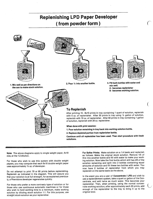

LPD was very hard to obtain for quite a while. I believe it is easier to find now.
The replenishment instructions can also be hard to find.
This might work:
I must have been living under a rock, I've never heard of LPD. I'm going to give it a try.
I suspect you’ll like it as many of us do, though it’s also fair to say at the end of the day it’s just a good paper developer, not a miracle or anything. But it is that much, a really good paper developer and much more resistant to oxidation than many so an excellent choice for those who print like I do - sometimes like an obsessed mad man for a few days then maybe not again for a month or more.
This might work:
Thanks for posting this Matt, that's the document that I use for establishing my routine.
