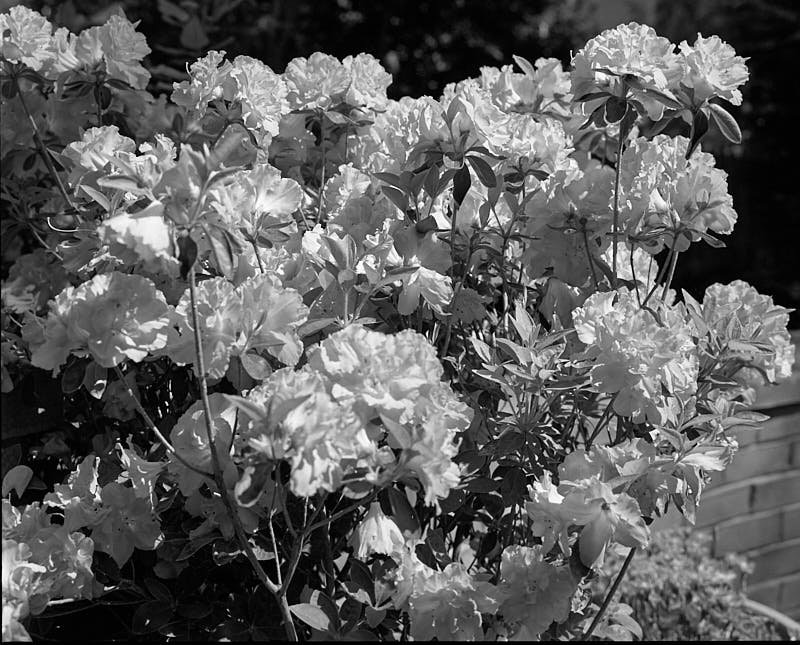

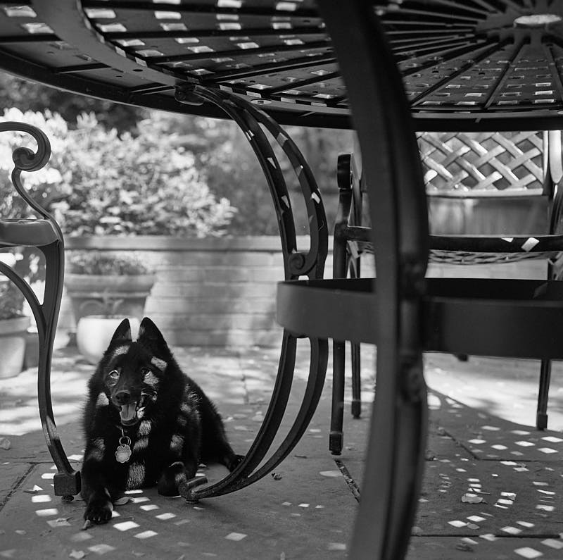

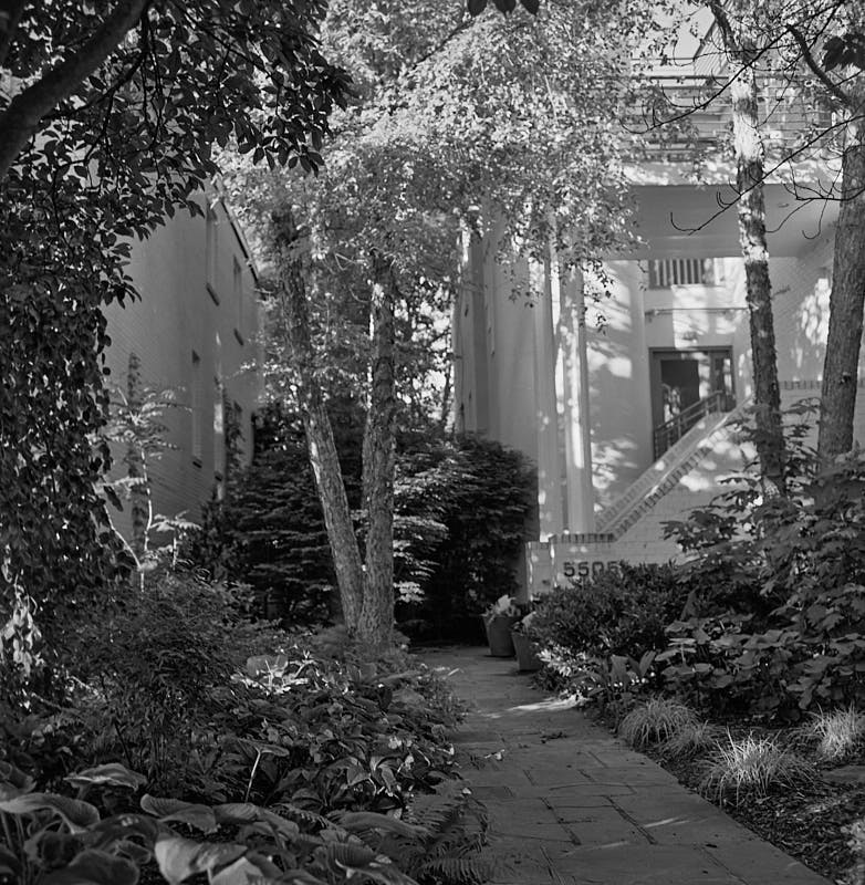

Let's see if these will work:
My dog, the Hosta and Azaleas are all from TMY-2 and the Street Garden (Image # 2) is Delta 400. These are 164KB JPEGs.Took a while to figure out how to reduce it to this, but here you are. All were shot handheld with a Rolleiflex 3.5E that is "new to me". Nice camera! Who'd have thunk it? Thanks!
They look nice.

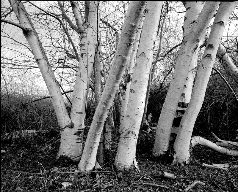

Just to be contrary, this was shot on TMY as well, developed in replenished HC-110, and scanned a few years ago with a $100 used Canon 9000F scanner using Vuescan:
I post this to point out that:
1) posting any image here distorts it - not surprising given you are trying to squeeze it into 800 pixels or so on a side; and
2) there are a massive number of variables that you need to deal with when you go from unexposed film to exposed film to developed film to scanned film, and you have very limited control of many of the variables that are dealt with by the scanner and scanning software - just because you don't request adjustments doesn't mean that the scanner and the software don't make them.
