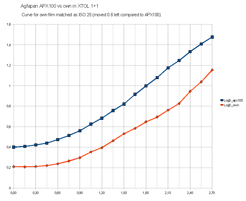

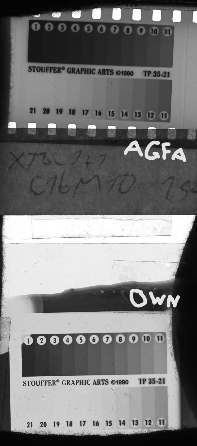

Curves!
Curves.
Without hypo sensitization which was failure. Test coating was a bit uneven which may affect results a bit. Test exposure was 1 stop more than for APX100, (so if they matched, it would be ISO50.)
Epson V700 scanner, profiled with a Stouffer scale, was used as a densitometer. X axis is not actual lux-second scale but should be considered relative.
Density readings may be a bit off, too. They sound a bit low to me. But the curve shape and logH range are interesting. Contrast is quite close to APX100.
But, despite having the first visible step at ISO25 compared to APX100, when looking with bare eye, it's probably better shot at EI16 or EI12.5 due to curve shape.
