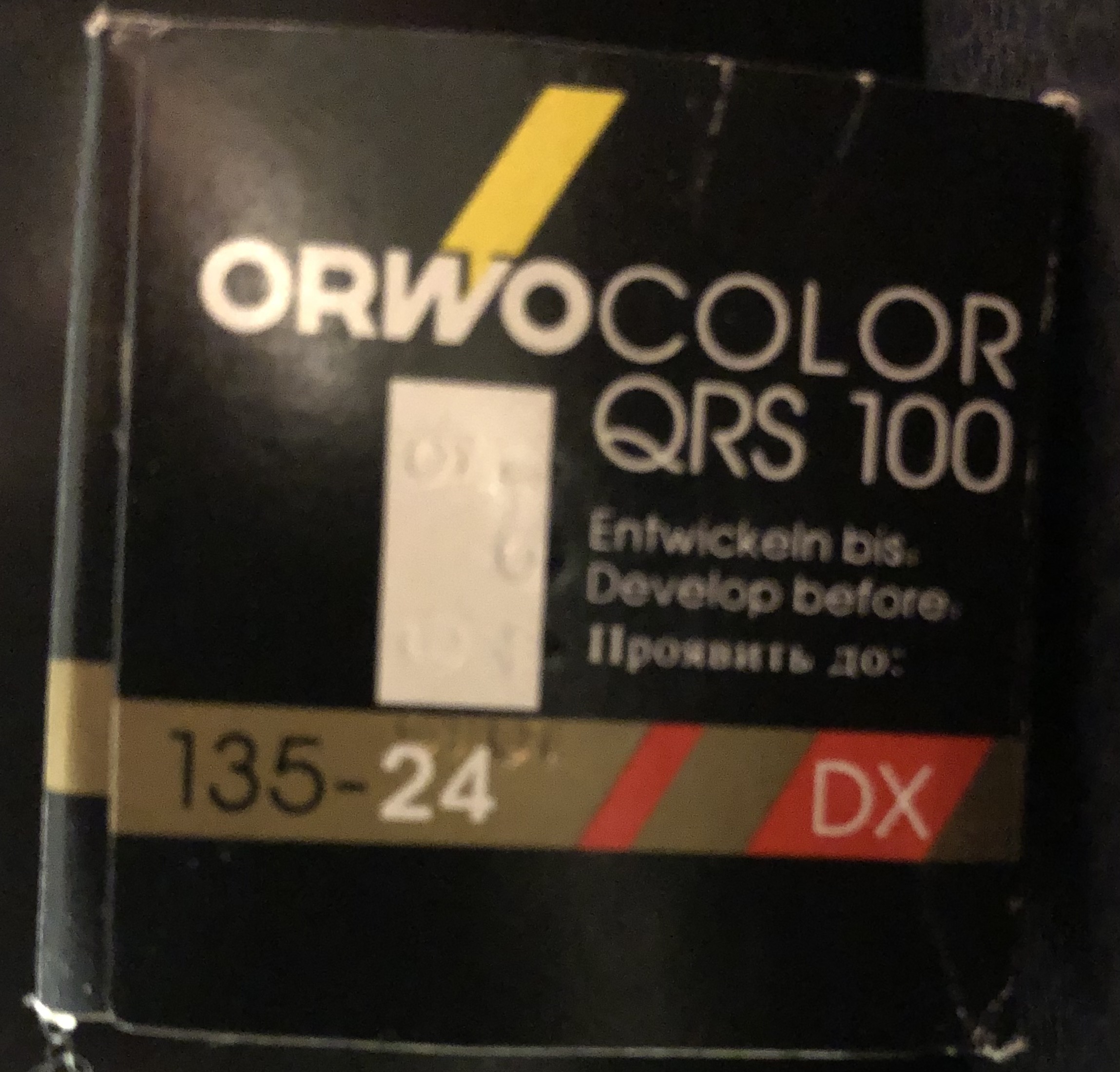

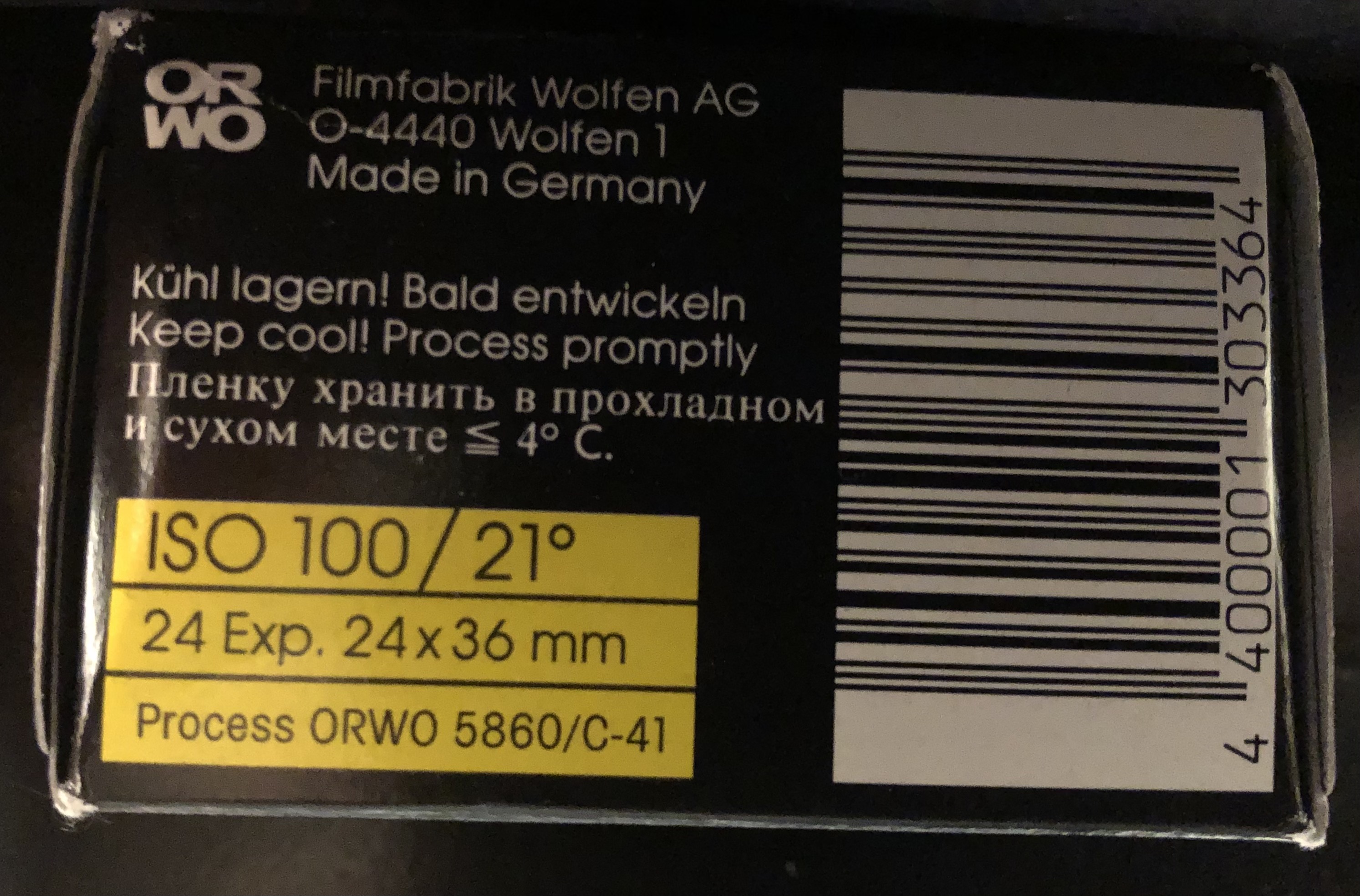

I have to hand an Orwocolor QRS100 24 exp. 35mm. box, expiry 3/96? (printing not clear), which states:
"Filmfabrik Wolfen Gmbh, D-06761 Wolfen. Made in Germany"
"Process; ORWO 5861/C-41"
I used quite a few of these films about 20+ years ago for general holiday-type pictures(they were being sold off very cheaply in the UK at the time). The negs are in store at the moment, but I remember that the quality of the results was excellent, quite comparable with Kodak, etc., consumer films.

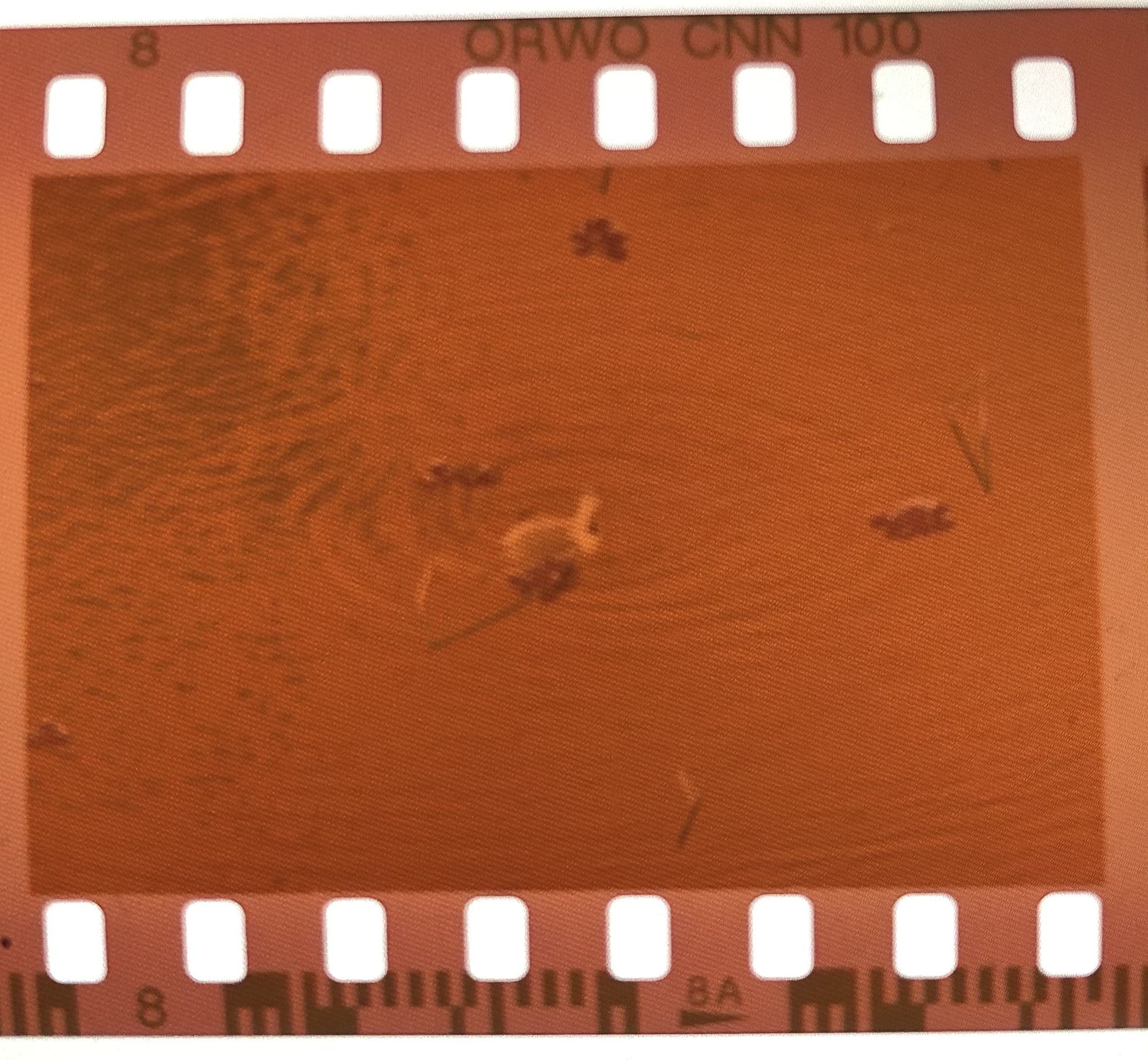

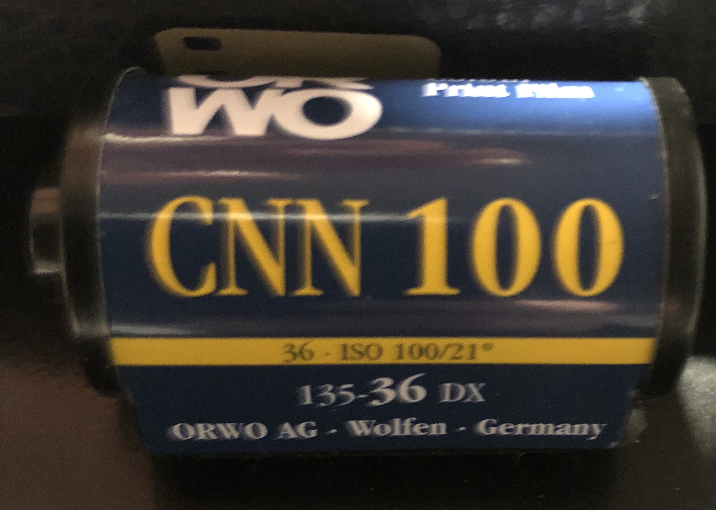

just a few iPhone pictures of what I have found (I certainly have more, in particular some CNS, but not at that location.. or maybe I shot them all): side and back of QRS 100 box, unexposed roll of CNN 100, one frame in a processed CNN 100.
As I said, foc.
The telling hint is not the edge signing but the name of the manufacturer.
Thank you for posting the photos, it was just what I wanted.
You are very welcome. This fora are made for helping each other to the best of our abilities. Mines being very limited, it makes me happy when I can help.
