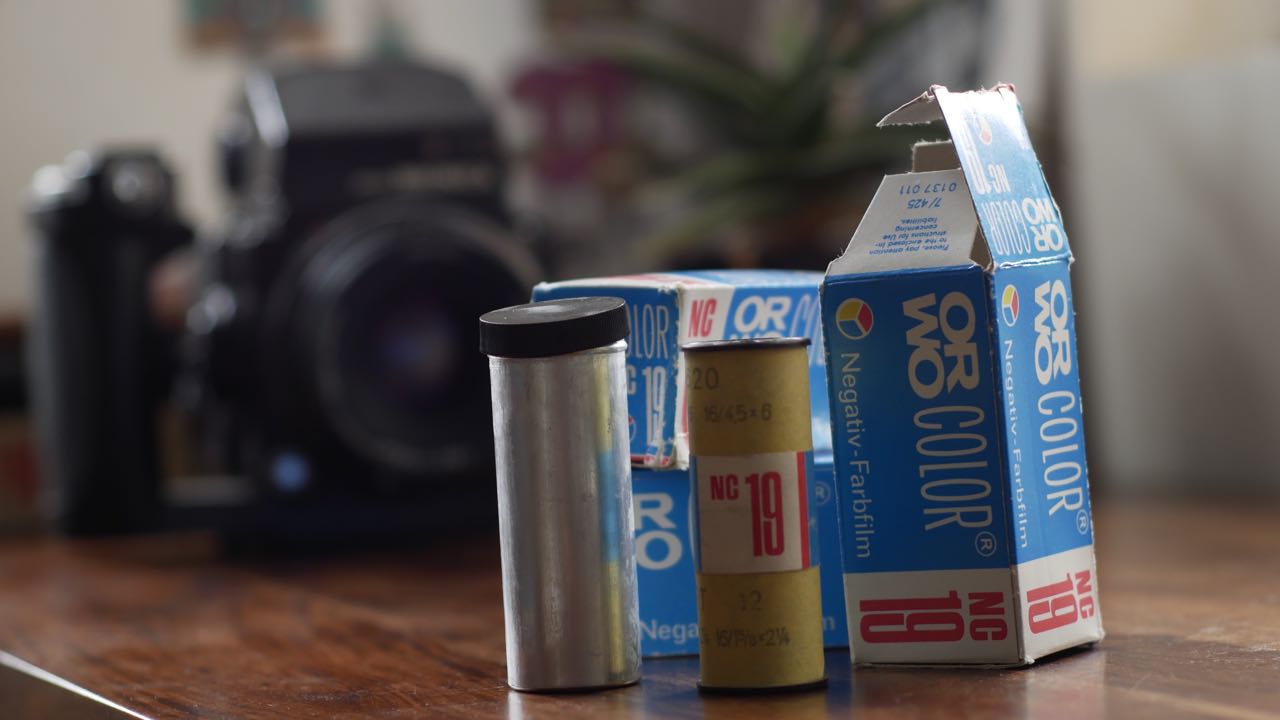

I saw this and thought it was an interesting read.
https://kosmofoto.com/2020/11/orwo-planning-return-to-colour-film-production/
Do I hear affordable 100 foot bulk rolls of C-41 maybe? If not, can ORWO make it happen please?
