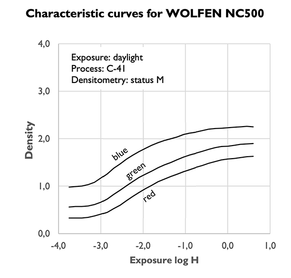

These orange masks are quite dense, I have seen D=1.0 in some C-41 film data sheets. It would not surprise me at all, that advanced scanners are optimized for this, i.e. more light sensitive in the blue channel, but at the same time less able to handle strong blue light.
The Vision3 films I've developed (in C-41, which may be the reason) have even denser masks.

The film does indeed lack an orange mask. But it has a dye filter layer.
Orwo NC500 "datasheet":
Maybe film lacks the orange mask, but the spec sheet does have it :wink:

color separation, yes - a coupler mask, not necessarily.
Can you give us an example? Which film had a distinct orange tint when developed but didn't have integrated coupler masking?
Secondly, your developed NC500 had RGB densities in line with the published datasheet?!
