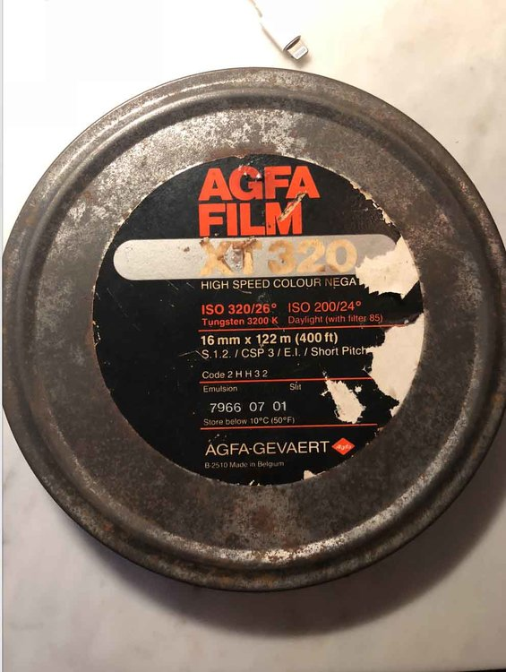

I found this on the net... so it was a TUNGSTEN film...
If Orwo NC500 is daylight balanced then we cannot say it's just the same formula as XT320.

Out of Africa was shot on;
AGFA-XT320
(& Eastman Color Negative II 100T 5247/7247 Film)
Presumably that explains the 500 iso in c41.

XT320 was actually a "nice" film. I belive that was the stock used in 16mm for this famous Video..

The detective work suggesting something similar to the old Agfa XT320 sounds plausible. If they really are making a remjet-free film which has effective speed of 500 when processed in C41, I might be up for that. But count me among those who is puzzled by the wording used and the sudden appearance of lots of different film options under the ORWO banner.
