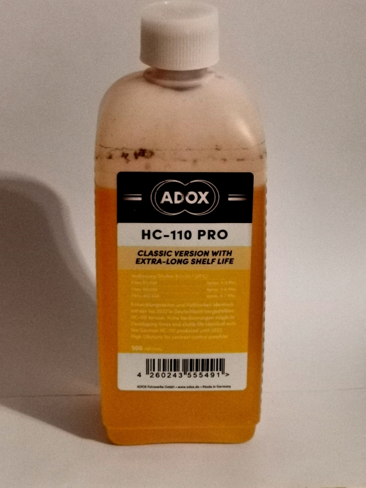

I'm reviving this thread as I am slowly looking for a replacement for my HC-110 (cat 501 0541) syrup.
Am I right in thinking that of the three HC-110 versions sold by @ADOX Fotoimpex, only ADOX HC-110 PRO Original Syrup has the same long shelf live as the my old HC-110?
I've been trawling through many threads and it seems the new Kodak version (listed as "HC-110 successor") will not last as long due to its water content, and if I understood post #27 above the same is true of Fotoimpex 110.

It seems to me that you are correct on all counts.
This version is described as original syrup and everlasting:
I cannot verify from the SDS that this is identical to the former Kodak syrup as Adox now give only an abbreviated SDS but it gave identical results in my side by side test.
Here is mine at 1 year old:

Hello Alan
Thank you very much for sharing your test info. This bodes well indeed.
