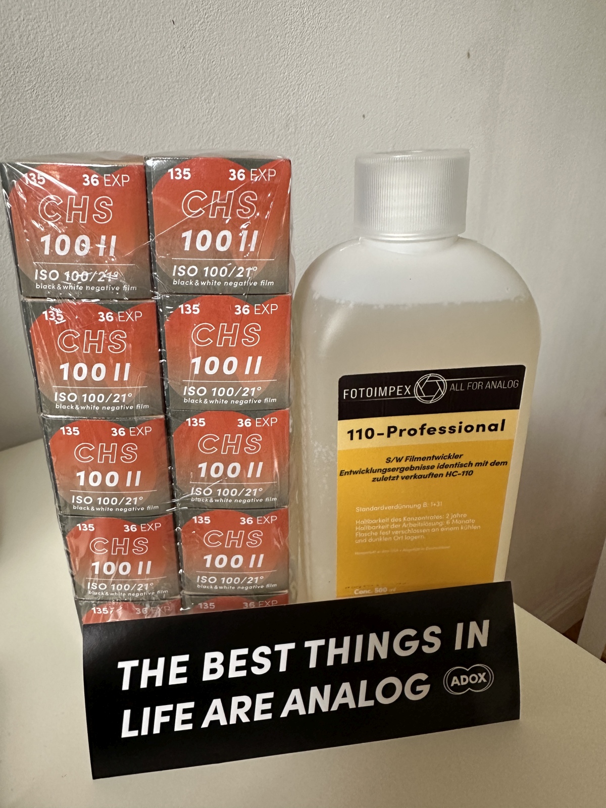

If this is the same formula that was produced over the past three years, does that mean it's the original viscous formula or the more recent, less viscous formula? I assume the latter and therefore not the 'original' formula but I guess you'll find out for sure when it arrives.

“we purchase the original mixture from the exact same manufacturer who produced this for Kodak over the past three years.” Says Fotoimpex on the site

Yes, but this can be interpreted a couple of different ways. Both the old and the new formulas can be considered "original" as they were produced for Kodak. But since they are purchasing from the manufacturer who made the more recent formulation, my guess is than it's that version, which isn't the old viscous formula with great shelf life.
The other thing that perplexes me a bit is that Kodak presumably had some licensing or other legal protection to prevent such a "knock off".
Yup, that is my interpretation. Curious to hear what @darkosaric actually receives.

"Kodak chemicals are temporarily unavailable this is why we purchase the original mixture from the exact same manufacturer who produced this for Kodak over the past three years."
So, it is clearly stated that this is not the old viscous version.
It is not old thick viscous version, it is newer - more liquid version.

The FOTOIMPEX Product is the thinner and clearer version which is made in the USA.
We just released the old "water-free" thick syrup as well under the ADOX brand. This version is made in house.
They can easily be distinguished by color and how they flow in the bottle.
