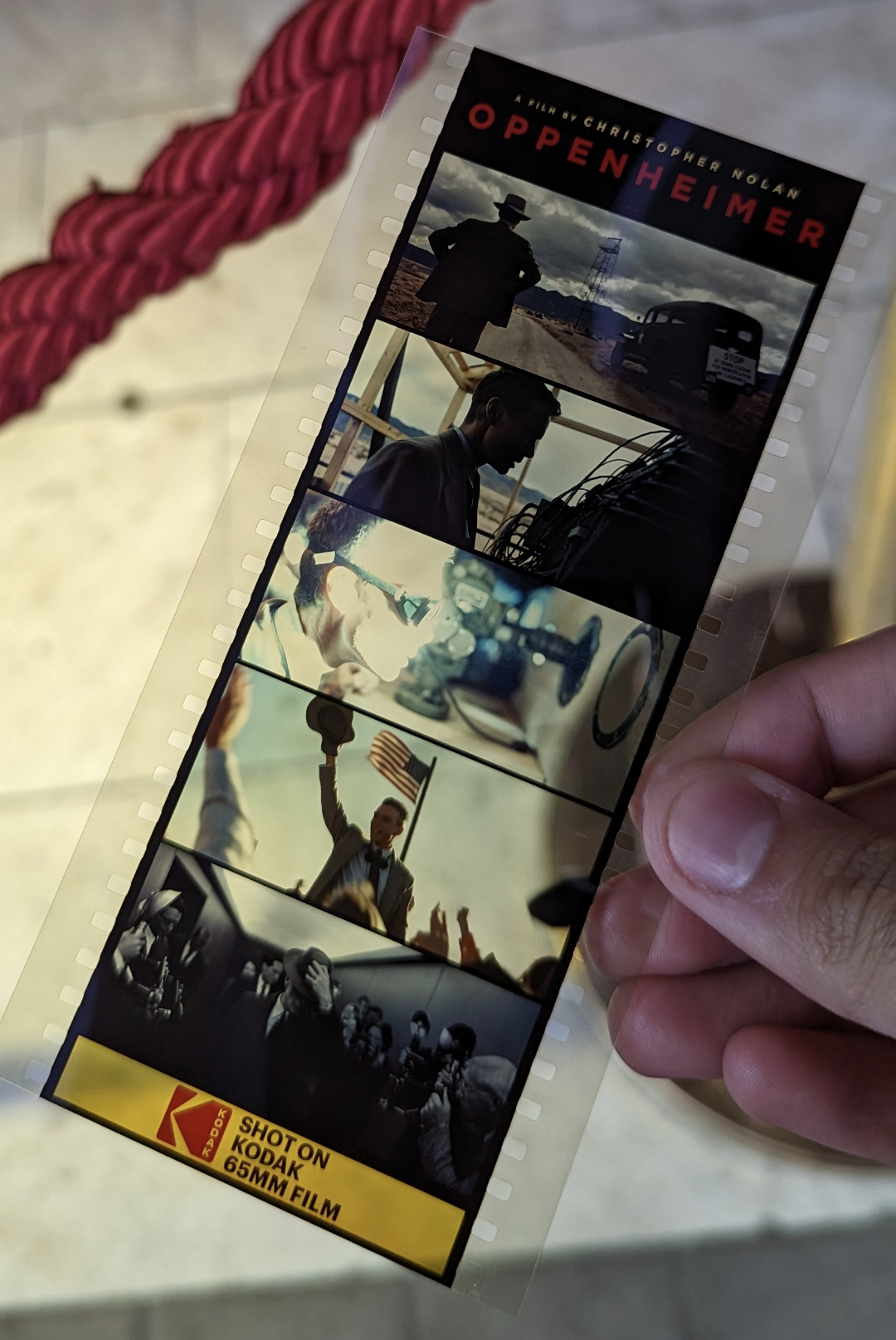

It was cool to see Double-X projected, but there were some traces (shadow Dmax and a slight tone) that the movie was on color print film. A fun fact introduced by the cinema host was that the 70mm print was shipped to Europe in about 6 reels (IIRC) totaling 6000 meters of film.
And also these are hitting eBay for interesting prices! At the moment it's a keepsake but 120 USD would make it for the most profitable screening I ever went to.
I'm thinking it might be worth the drive just for the souvenir (if indeed they're giving those out at the IMAX film locations worldwide)!
