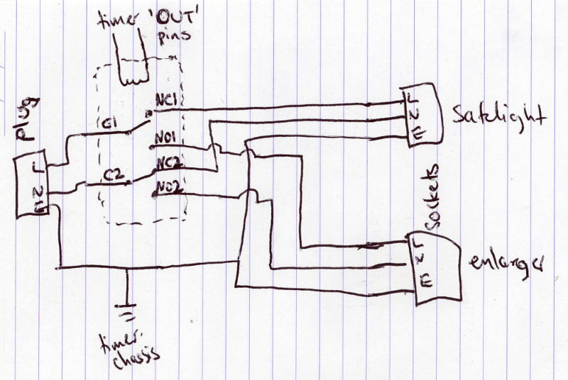

So I just wrote an email full of Mouser part numbers to someone and figured it would be best posted here too for anyone doing a build at the moment.
If you want to turn a safelight off when the enlarger is on, you use a DPDT mechanical relay with 5V coil. Assuming you're buying from Mouser, get 653-G2RL-2-DC5 and wire it like I've shown in the attached scribblings: power supply to the common pins, safelight between the NC (normally connected) pins and enlarger between the NO (normally open) pins; earth always connected to both loads. If buying a relay elsewhere, the important specifications are:
- 5V coil with about 65 ohms resistance
- contacts rated for >=8A at >=115VAC (USA) or >=240VAC (elsewhere)
- DPDT
Look at page 4 of the datasheet for that relay (link is on Mouser page). From the pinout:
- timer "OUT" pins connect to pins 1 and 8
- supply Live connects to pin 3
- safelight Live connects to pin 2
- enlarger Live connects to pin 4
- supply Neutral connects to pin 6
- safelight Neutral connects to pin 7
- enlarger Neutral connects to pin 5
All connections to that relay must be soldered and use mains-rated wiring; I recommend stripping open a 3-pin extension cord and using the 3 wires from inside it.
Before powering up, make sure that the ground connections are solid:
- input plug to timer chassis
- input plug to both output sockets
- input L/N should show continuity to the safelight L/N
and make sure there are NO shorts:
- input L/N to chassis
- enlarger L/N not showing continuity anywhere.
- there should be at least 5mm clearance between any mains circuits (L/N lines) and the chassis or any other wiring.
Grounds are NOT OPTIONAL. Use a metal chassis/case for the timer and always connect it to a grounded supply.
That will work for enlargers up to about 500W (115V). If yours is bigger, you need a bigger relay.

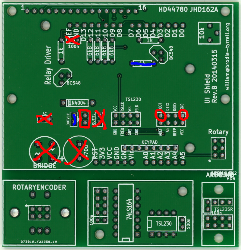

Have a look at the attached scan of the PCB that I've marked up. You can leave off the 100n capacitor; it's not actually required for the timer and is on the board only to support other things that the same board is used for. Where there are blue lines on there, put in wire links. The two circled pins are where you connect the foot switch. Use a high quality (Apple/Samsung not generic chinese $5 thing) USB phone charger as the power supply and that means you can leave off all the power supply parts on this board, and don't need a transformer in the box. The pins labelled "OUT" (with red rectangle highlight on scan) are what connects to the relay coil.
In terms of transistors, any BC546, 547, 548, 549 will be fine. Any version from any manufacturer, with any letters at all after the numbers. For the purposes of this circuit, they're all compatible.
For resistors, pretty much anything goes. Easiest to obtain will be 1/8W metal-film or 1/4W carbon; for example on Mouser, 71-RN55D-F-1.0K and 71-RN55D-F-6.8K
For wiring to the foot switch, relay, etc, I recommend buying something like eBay 251661434781 and Mouser 855-M20-9724046 (snap off shorter lengths as required). You'll also want a couple of 855-M20-9774046 (snap-off lengths as required) for the pins that plug into the Arduino and LCD. And you'll want a couple of 855-M20-7821646; one to solder onto the LCD and another for the encoder board; again you just cut it to length with sidecutters (sacrificing one pin with each cut) so that it has the right number of pins; 2 strips of 3 pins are used for the encoder.
