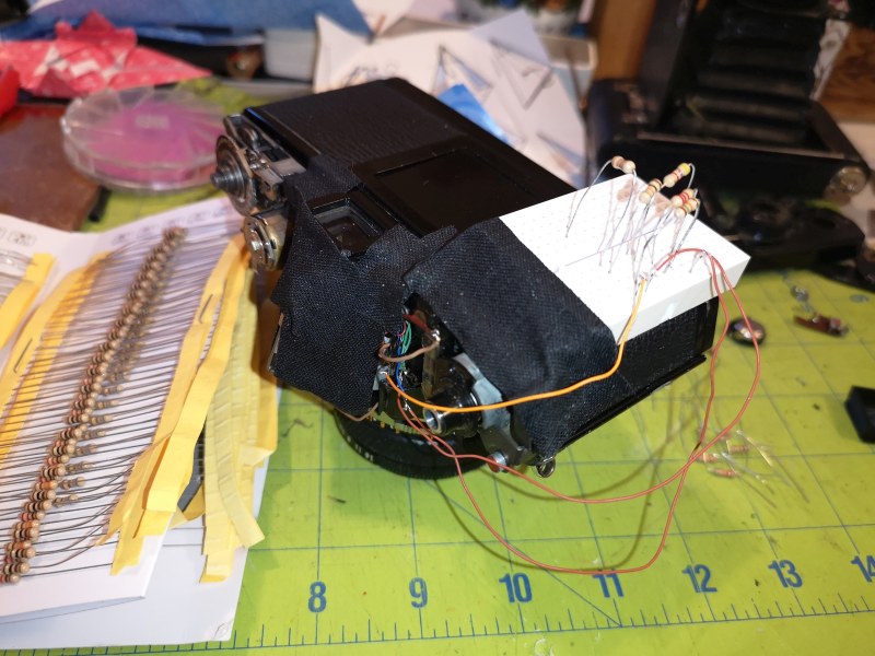

So here are the resistor values I settled on:
R1: 3.3K
R2: 14.5K
R3: 17K
When figuring out values, R2 is said to affect high light values, R1: mid, and R3 low. I settled on R1's value at 3.3K because other values would throw R2 and R3 out quite a bit. I established R3's value next with a low light setting since it seemed to have the biggest effect on the meter overall, then tweaked R2's value with an EV 16 scene.
One thing that threw me off is light entering the viewfinder can affect the meter reading. Once I remembered that, I used an eyecup and things started to line up. I'm very happy with the accuracy of the meter now and am actually inspired to use my OM-1 again.
Because I'm working with the original OM-1 (non MD version) which had what it looked like to be modified R values installed, these values may not work in other OM-1 cameras. It would be interesting to see how other OM-1s stack up. If I was going to do this again here's how I'd do it:
1. start by metering on an EV10 or so scene and lower R1's value until it shows around one stop overexposure
2. raise the value of R3 until exposure is correct.
3. meter an outdoor scene around EV16 or so and modify R2 until it reads correctly.
4. Try metering an EV6 or so scene. If it's a little high, tweak R3's value lower and go back to step 3, then check the EV10 reading.
Once you settle on the values, you can either order the correct resistors, or combine them in parallel or serial to get the right value.
Removing the top plate of the OM-1 requires the removal of the rewind knob (unscrew while bracing the rewind shaft in the camera), the 2 screws under it, the hot shoe nut, and the film advance lever. Be sure you don't move the ASA adjustment.
Then, to set it up for calibration, desolder the 3 leads and solder them to pins that can be plugged into a breadboard. I found it helpful to bypass the on/off switch since in an OM-1 it's a microswitch, but the MD and later versions have a circuit board switch that can be turned on easily. I also installed hockey tape over the prism to prevent any light getting in which would affect the meter.

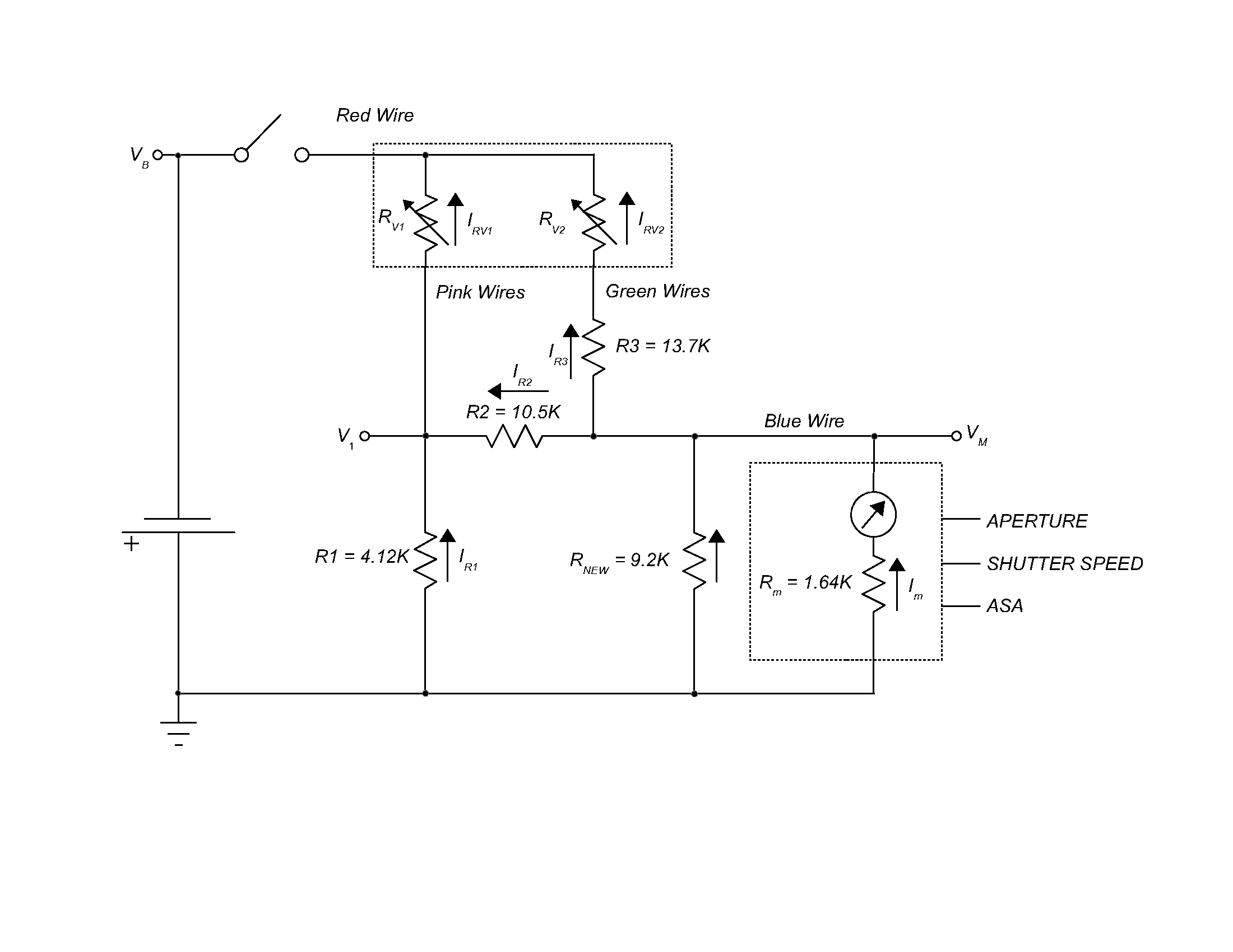

Anyway, here is a quick update on the Silver Oxide battery modifications. I went back and recalculated everything with the correct (updated) schematic, which is shown below.
First I tried adjusting the values of the existing resistors to compensate for the voltage change. The best I could do by trial and error was by changing R3 from 13.7k to 17.4k. This voltage curve had a 10% voltage error at EV0, but was within 5% from EV4 to EV16, which is probably good enough.
However, adding a 9.2k resistor in parallel with the meter block (and leaving all the original resistors alone) produced a voltage curve that is within 1% of the mercury battery. This modification was suggested in one of the technical papers for adjusting the exposure meter. Pretty linear, easy to add, and relatively insensitive to resistance value. This is actually something I think might be preferable to adding a diode in series, so when I get around to it, I plan to make this modification to my OM-1n. I'll let you know how it goes. An Excel chart comparing voltage curves is below. Series 3 is the R3 mod, and Series 2 is the new resistor mod.

I'm curious as to how this will work. It's quite a different solution than modifying existing resistors. I'm not sure exactly how to read what it's doing, but it looks like it's draining off some current going to the galvenometer, maybe around 16% more current, which in effect is like replacing the galvenometer with one that requires more current.
The diagram below is for the original OM-1. The updated OM-1 and OM-1n have different R values, so I wonder whether they also have a different galvenometer with a different R value. If so, the add-in resistor value may need changing.
This modification would be much easier than replacing all the resistors, and would be a better solution than the diode, which seems to not only have temperature variability, but also doesn't maintain a steady voltage of 1.35 volts throughout the EV range.
The extra resistor provides a path for current to bypass the galvenometer, essentially draining away excess current that would otherwise pass through the galvenometer due to the increased voltage of the silver-oxide battery.
The value of resistor is selected so that the voltage at the input to the galvenometer when using a silver-oxide cell is close to what the voltage would have been with a mercury cell. The optimum value of the resistor does depend on the impedance of the galvenometer (and to a lesser extent on the impedance of the circuit coupling the galvenometer to the battery), so it could be different for different cameras.

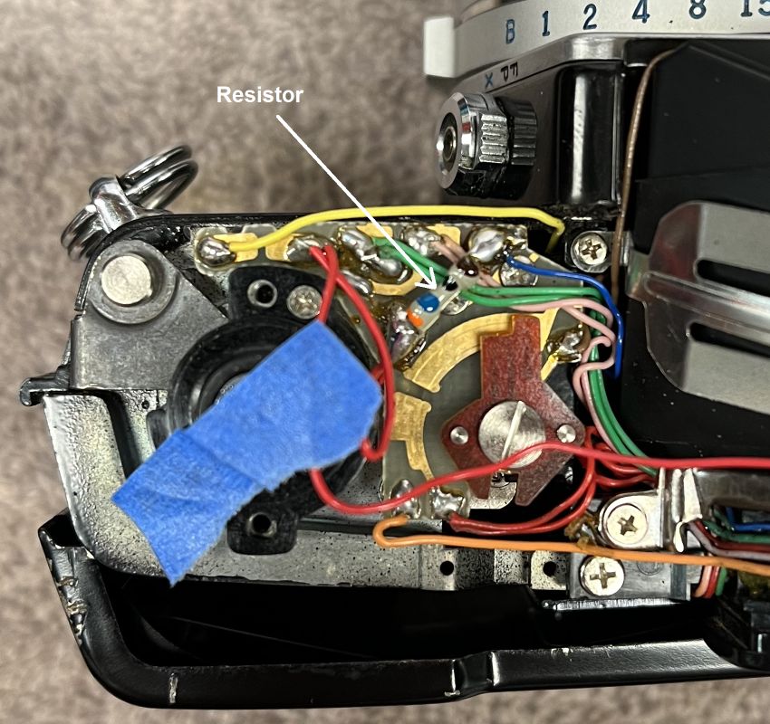

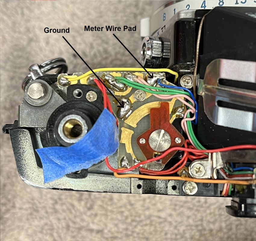

Not having a 9.2K resistor handy, I decided to use the 10.5K resistor from the donor OM-1 as the compensating resistor. Below are images of the circuit board before and after the modification. Fortunately, there is a pretty convenient set of pads to solder the resistor to.
After adding the resistor, the exposure meter is reading about one stop low as compared to my A1, so I'm thinking the resistor needs to have a higher impedance. This could be due to a lot of reasons. Some possible reasons that come to mind are that the circuit in the recipient camera may have different values of resistance as compared to the circuit in the donor camera, the unmodified light meter may have been poorly calibrated from the beginning or have sensitivity changes due to aging, or my calculations may simply be off. So, I plan to buy some resistors and start trying different values.
Does it read 1 stop low at all EV levels?
