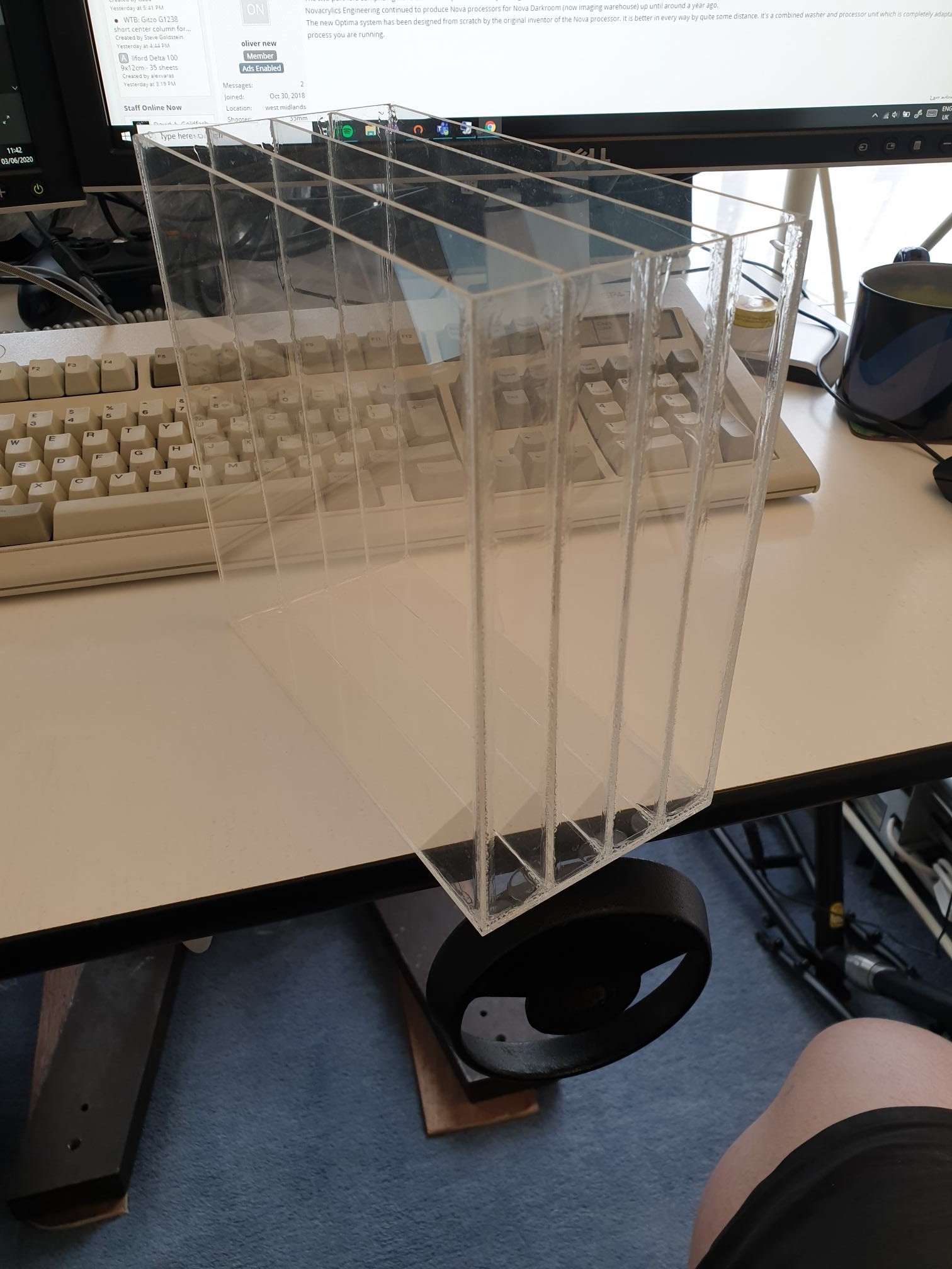

I ended up building my own much smaller unit as a proof of concept for a larger, more complex unit, which I plan to make in the future. Attached is a picture of the little gem. It works a treat for making photographic postcards!
