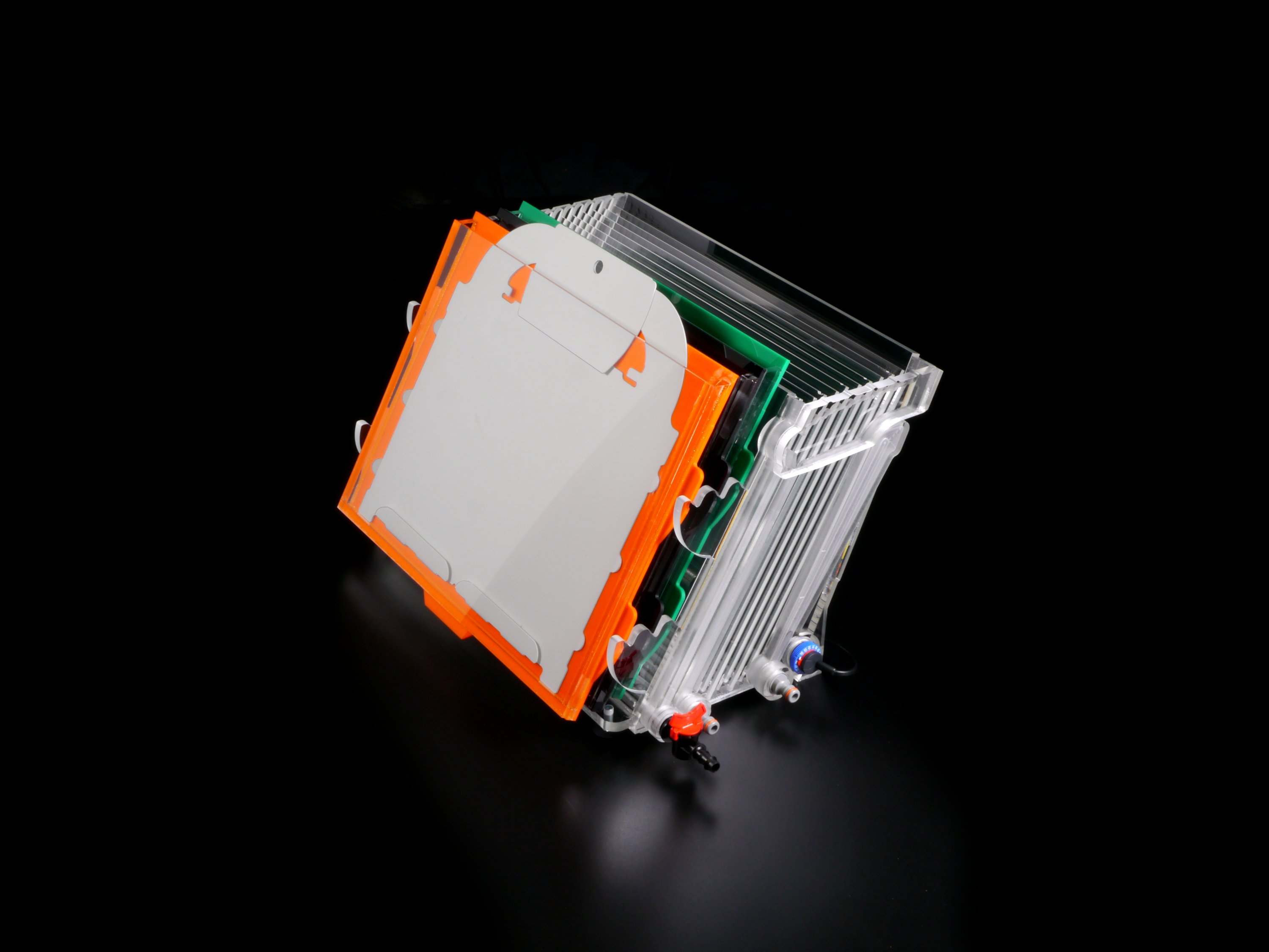

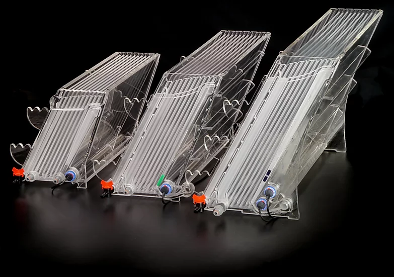

The company that used to manufacture the Nova processors now make something they call the Optima system. The lengths they have gone to in the design of this system in all aspects is really impressive. Uses eheim heaters which I think are USA compatible.
I have the all singing Optima 12 but they also do an Optima X which just holds the verical chemical pods.
Website is www.optimadarkroon.co.uk
