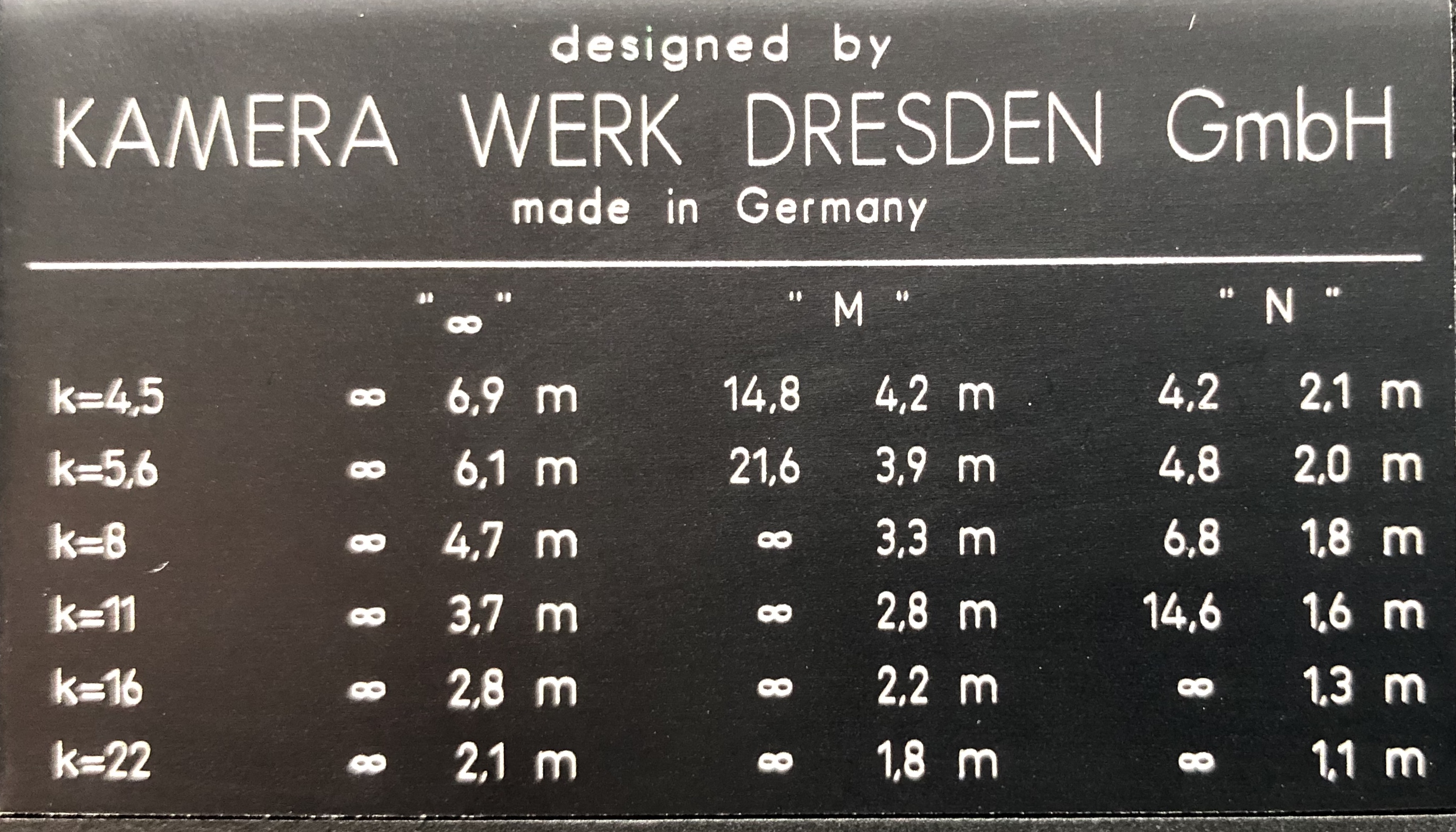

I need some help understanding the 3 focusing zones on a Noblex 150UX.
What actual distances do the 3 focusing zones (N, M, infinity) represent?
On infinity is the lens actually focused at infinity?
Can I focus in-between these fixed zones?
I make 8ft wide prints and have mostly been shooting at f8 1/2 and infinity but sometimes the lower 1/5th of the foreground is a little too blurry and I was thinking of focus stacking.
I'd like to limit stacking to 2-3 images (to save on drum scanning costs and limit changing rolls) - at my print size can I get away with with shooting 3 images at f8 in each zone?
I have a Fotoman rangefinder but never know exactly where to set the corresponding focus on the camera for maximum image quality. I almost always want the distant background in focus but often have a foreground element at 5-7 meters that also needs be tack sharp.

I dont know why you ask N, M and infinity when showing DOF-Table. forgot about ithat- only had the first model for 6 months for testing from a real friend.

Roundshot 65/70/220 grandagon 65/4.5. f16: 4.5- inf,. remember defraction may start at 11/16(must verify maybe its in my forum),
large DOF thanks to larger COC. scale has values but inbetween possible,
Widelux 1500(less sharp than Noblex(supersharp) :f8 10.1m(its not 10.1m but first added mark meant)=7.5-inf. -f11 inbetween 5.2 and 10(very little space to add markers)=5.5-inf. I calculated COC =1/48 mm. it all depend how sharp and tiny target is to verify if it can be read. maybe W1500 lens has smaller COC. i suspect even 1/25 but then my DOF-table would be untrue(for very tiny subjects when enlarged very big). Maybe someone with optical skills can interprete my formulas on the sheet i dont remember how i calculated DOF. I used a texas instrument calculator where formula was programmed.

DOF- table by Noblex cannot be true. Too optimistic at least the infinities.
til infinity 5,6 N 6.1m-inf. W1500 21.4m-inf.
f8 Noblex 4.7m -inf. W1500 15m- inf.
f11 N 3.7m -inf. " 10.9m-inf.
f16 N 2.8m -inf. " 7.5m- inf.
f22 N 2.1m- inf. " 5.45m-inf.

To achieve the figures on the DOF scale the COC has to be chosen as 0.06mm
The true focal setting at "Infinty." then would be 30m and at "N" 3m .
if 1/16 would be true the smaller DOF in W1500 would lead to larger COC meaning e.g. 1/5 which is unrealistic.
Noblex 50 have clearly tinier COC leading to smaller DOF than W1500(larger DOF, larger DOF.
1/Xn= COC
X must be larger/tinier COC than 1/Xw
n= Noblex 150 and newer-w=Widelux 1500
If 1/48 is true for W1500 (could also be 1/25)then Noblex must be 1/32 or 1/48. Pls could someone find the formula and calculate.

I am not sure whether I understand your question?
The Noblex has these three focus settings - in between might work but are not in the manual - and you have the table on the camera with the distances (metric system) which will be in focus. If you want to increase the focuse near to you, either stop down or switch to “m”.
f8 with the focus at infinity will render everything from 4,70m to infinity sharply onto the film, anything nearer to you will be blurry. If you switch to f11 and to “m”, anything from 2,80m to infity will be focused.
The viewfinder of the camera is not for focusing. With the Noblex, you always have to guess distances or measure outside the camera.
About your print size: 8 feet wide is quite a challenge. Considering that one negative is only about 12 cm wide, you are roughly enlarging by factor 20x. I am not sure how you do the stacking, but I would not expect the prints to be 100% crisp. But a 8 feet wide the print is viewed from a certain distance, so you should be fine.
noblex images are razorsharp. 8 feet 20x is no problem at all. Rainer K. lampinen told his technopan(inside is the later S3Pro-maybe they had an agreement not to produce 8 exposure times version under Horizon brand) could easily produce images which were 6m long more than twice these 8 feet.
I have some documentation from Kamera Werk Dresden on the Noblex 150 cameras. Both of the documents specify distances associated with the three focus settings as 2.8m, 6.5m and 17.2m, respectively. One of the documents uses the term "middle admission distance" to refer to these numbers, while the other uses the term "maximum of sharpness". So I think it's reasonable to interpret these as the actual focus settings.
Each of these distances has associated with it a further specification referred to as "unscharfenkreis" or "spot diameter" - I believe this is a circle-of-confusion specification, presumably used to calculate the depth-of-field numbers provided, though I have not tried to run the calculations myself to confirm that. Interestingly, this specification varies - 0.05mm for the M and infinity settings, but 0.07mm for the N setting.
yes 1/14 for N close and 1/20 for M midrange is highly interesting. Noblex lens is sharper better resolution than W 1500. so DOF less optimistic. but the opposite is showing the table. W1500 table showing less optimistic. should be larger DOF then since larger COC. something really strange here. pity i have no Noblex. Had one on my list but other more important investments and cams more urgent. would have liked to test with Technical Pan.
