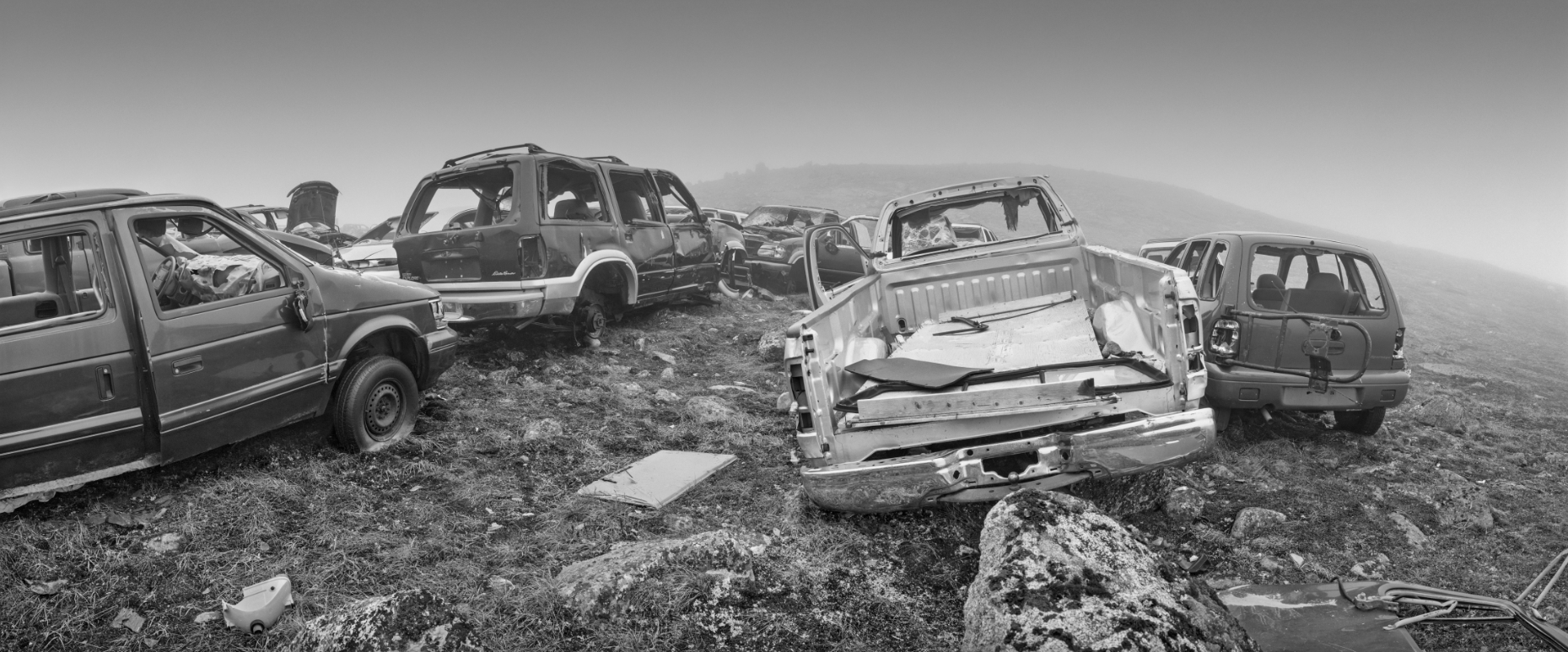

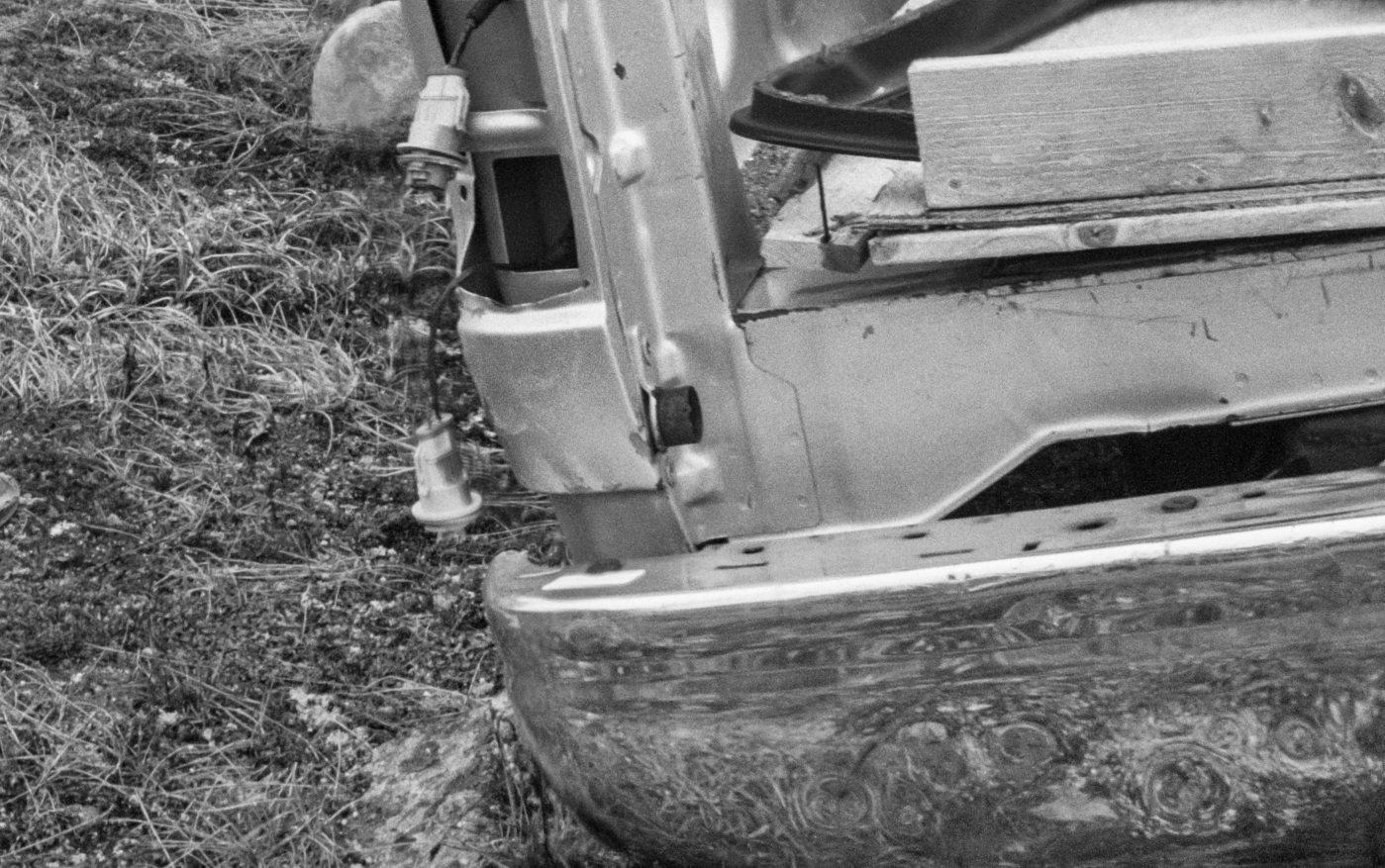

Here is where bracketing helped and improved the sharpness on the very back edge of the truck and foreground rock. But I could probably have gotten the same result with only one frame shot at f22 / infinity.
