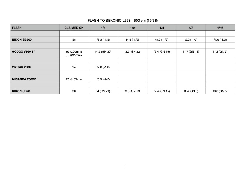

Finally I did a test of the output of my SB 800 in manual mode again - inspired by Chan. I also tested a few other flash guns I have to hand, including a Miranda which is the first piece of photo equipment I ever bought and still going strong, in 1987 (Oh if only I'd stopped there!).
Test was done in my regular living room, at 6 metres. I can do it again in feet if easier, and can do it at 10/11 feet as Chan did. This was just spatially convenient.
I did everything at 35mm @ iso 100 - the Vivitar 2800 doesn't have a zoom adjustment but probably covers 35mm. Despite a lot of searching I could not find a manufacturers specified GN number for the Godox at 35mm, although I did find a comment on dPreview extrapolating that it is likely 35 at 35mm. The published spec is 60 at 200mm, at iso 100.
First observation - the SB800 is pretty close to the LCD spec throughout the power settings (always under-exposed according to the Sekonic but not by much). Actual measured output is listed and in brackets the degree of under-exposure compared to the LCD specification.
Second observation - I didn't expect the SB800 to be more powerful than the Godox, a lightly used unit that is about 15 years its junior. The Godox is also physically bigger.
Third observation - The Godox entries only list the output read-out as measured by the light meter. It was late at that point - not sure if I forgot to write in the Godox LCD proposed f-stop, of it doesn't actually list one on the display. I'll clarify later.
The Vivitar and the Miranda only have full output in manual mode. The Miranda has a clunky manual zoom head (the front fresnel can be slid forward) - but the stated GN at the 35mm position is 25.

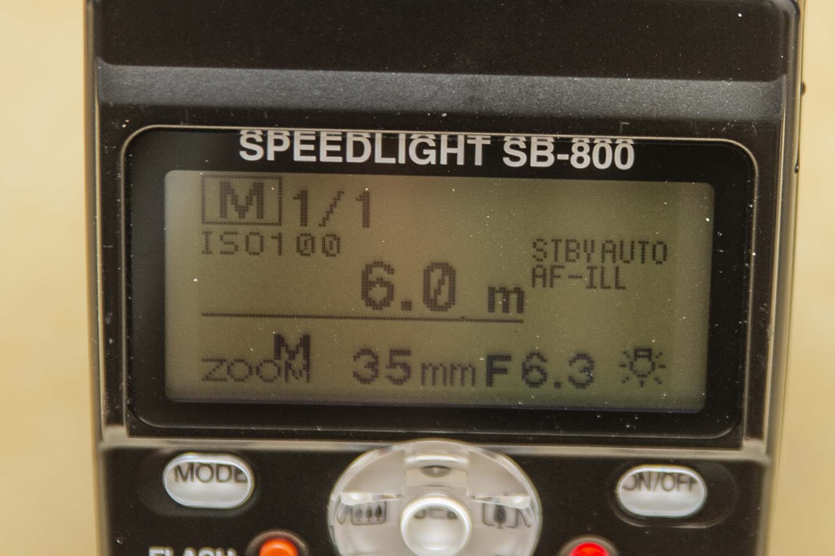

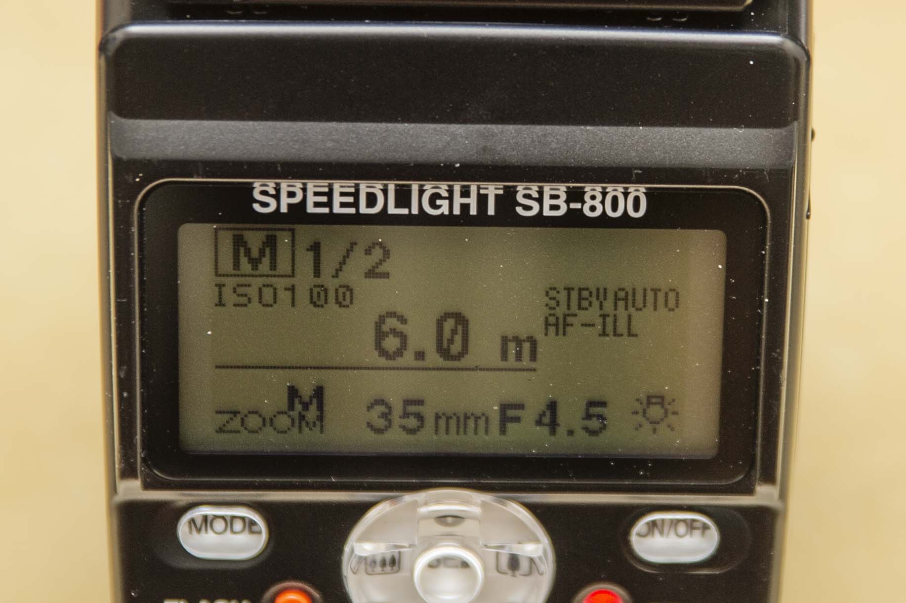

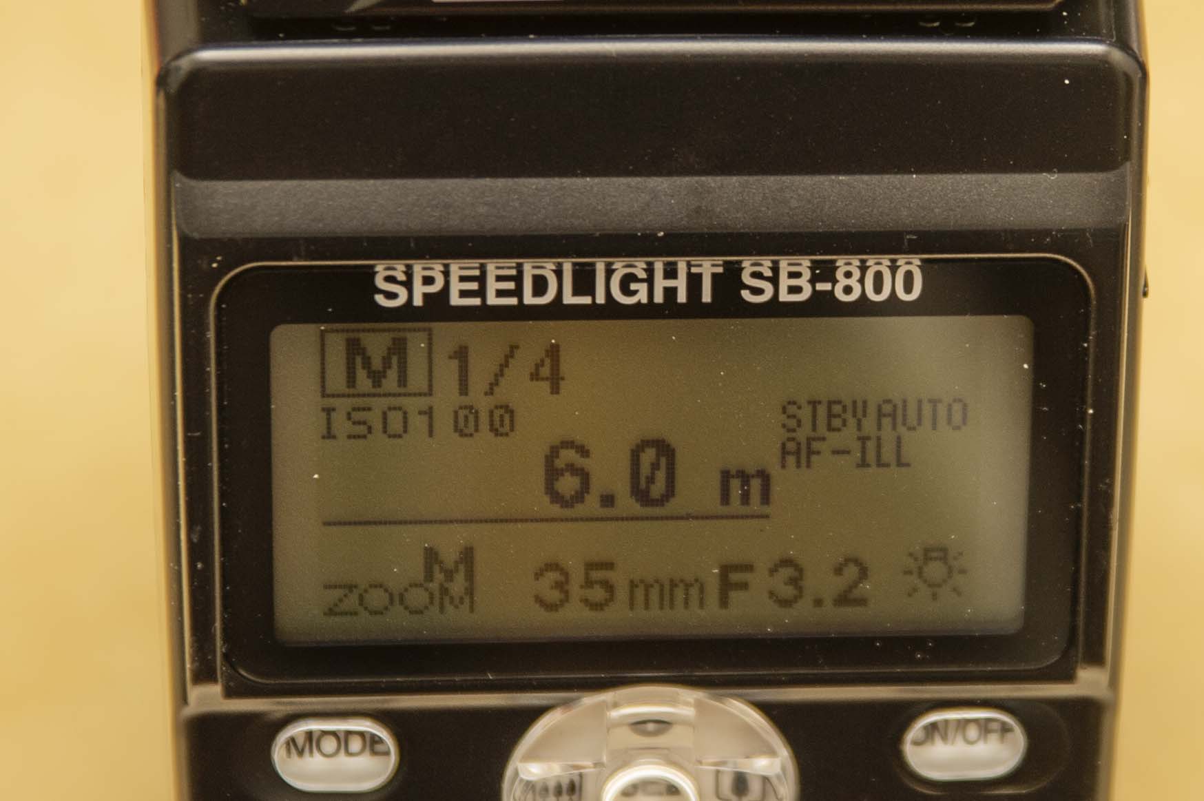

The display and your measurement for the SB-800 matches exactly
I attached the display for 1/1, 1/2 and 1/4
View attachment 376091View attachment 376092View attachment 376093
Chan,
The uncanny consistency of our read outs gives me the distinct sense that I mislead everyone on how to read my test results. I think I mis-remembered my entries for the SB800. The first figure (which matches your read-out) is in fact my SB 800 read-out, and the value in brackets is the shortfall from that value at the Sekonic meter! So under-exposure, albeit generally not bad.
I found another flash gun in a box - a Nikon SB-20 flea market special. I tested it the same way, and updated my results here. It's pretty good for a flash from the late 80's. But it doesn't come near its stated GN number.

Chan,

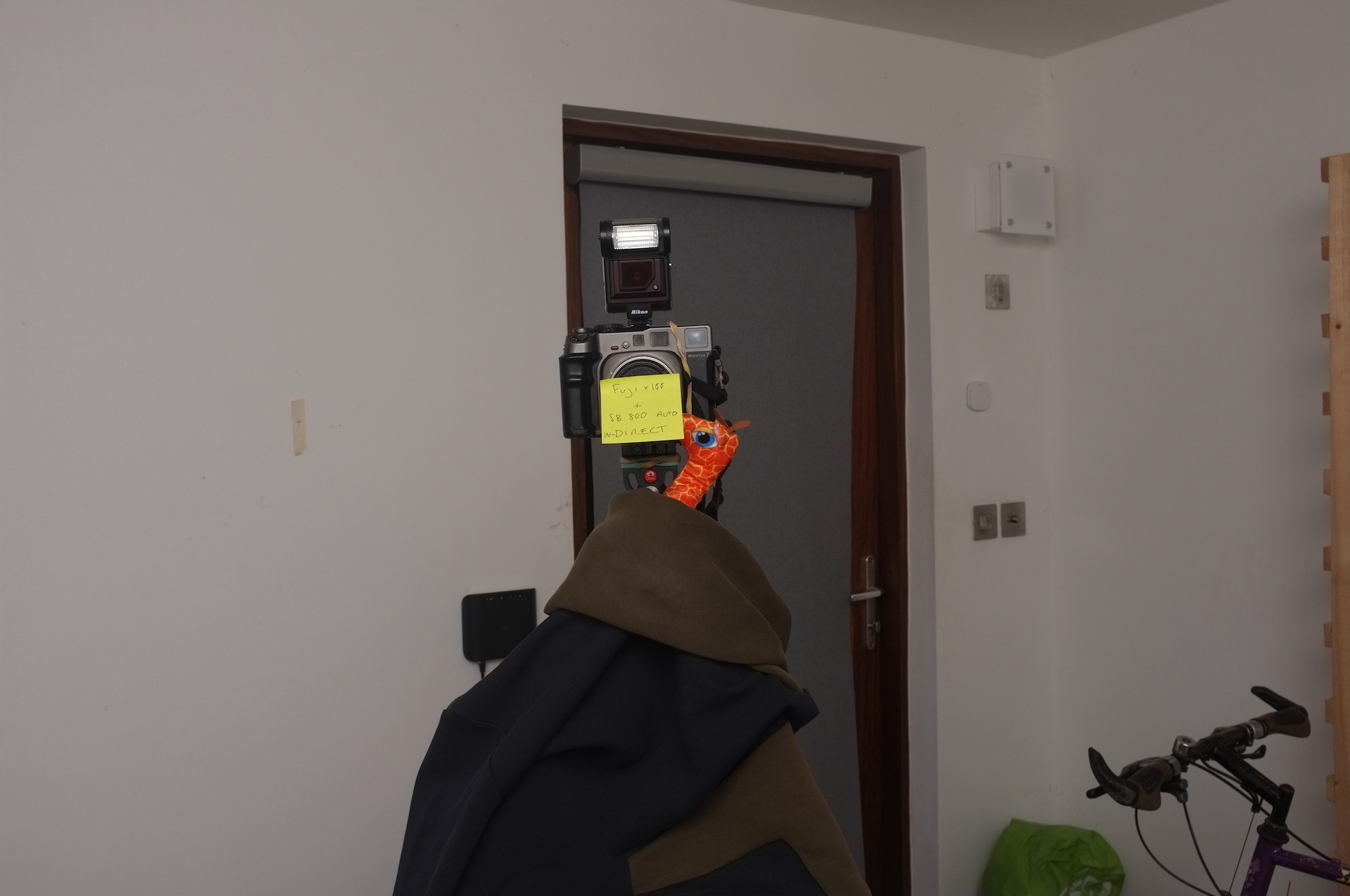

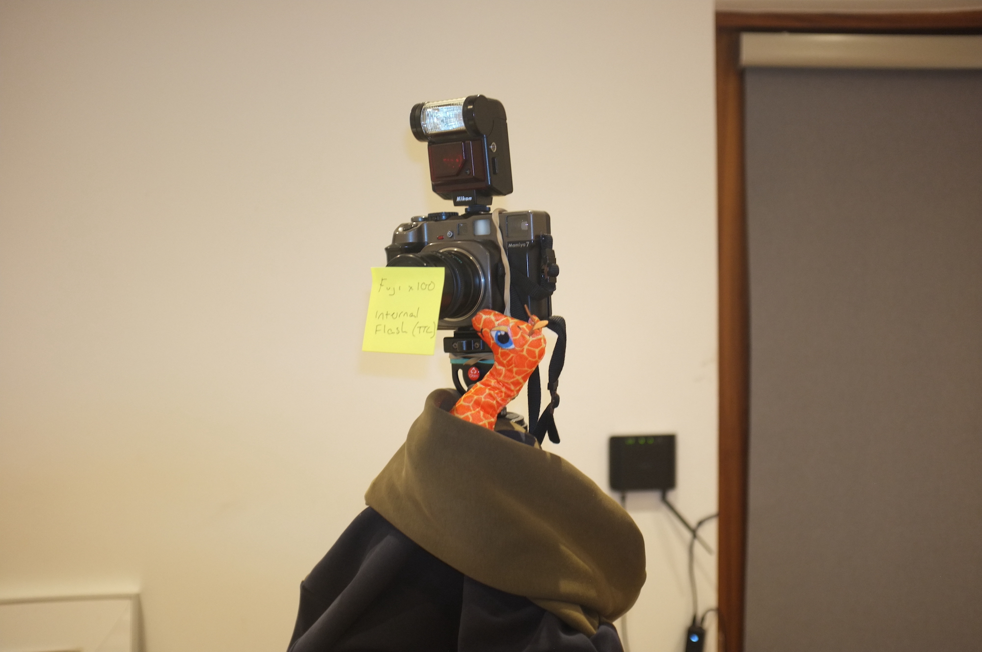

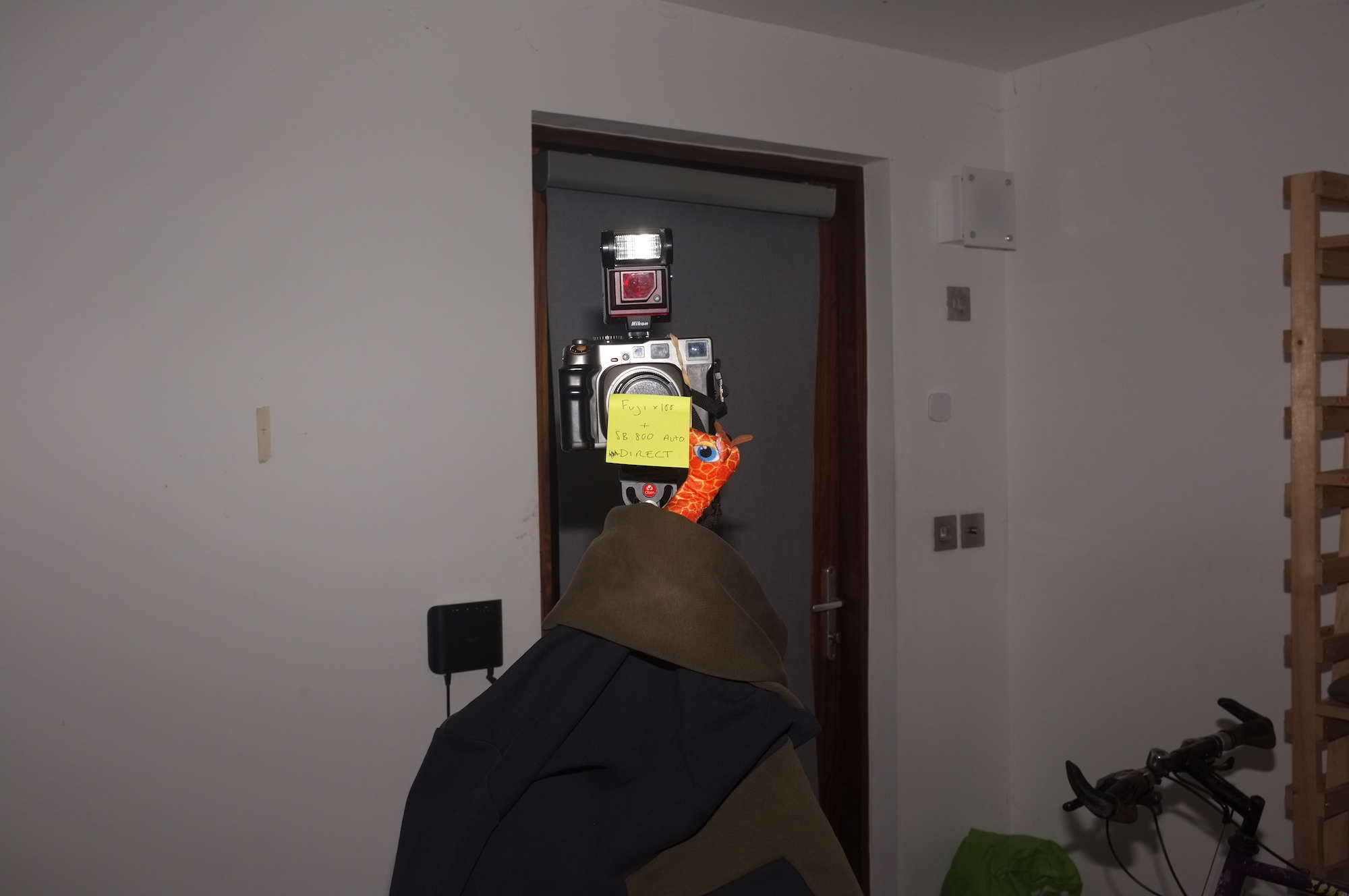

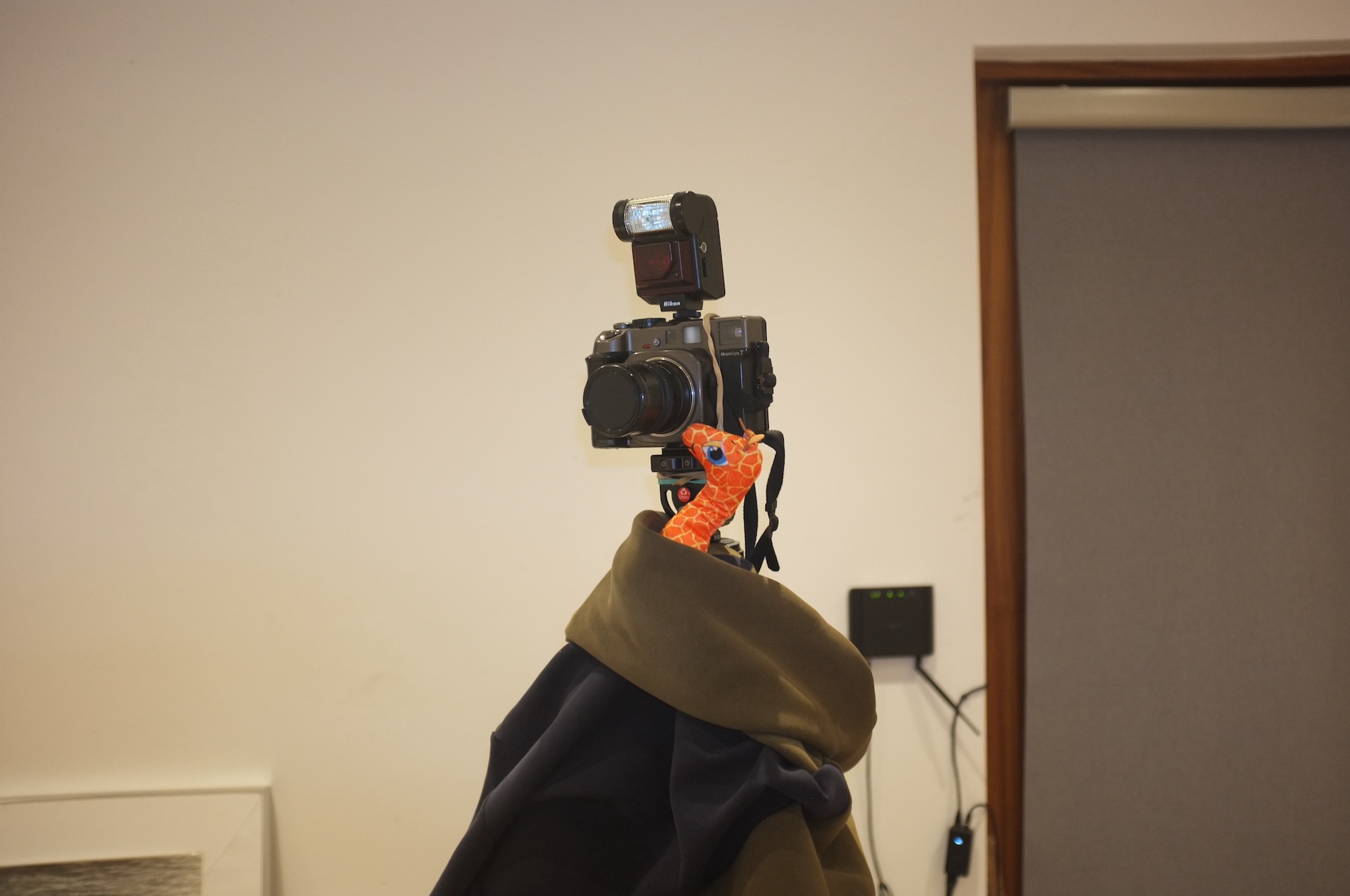

I also tested the auto mode of the SB 800, using an old Fuji x100. Shots are Fuji in program mode without flash / with internal flash forced on (TTL) / with bounced SB800 in auto-mode set to the same fixed ISO 200 @ f.8 of the camera / direct SB800 in auto-mode set to the same fixed ISO 200 @ f.8. For the SB800 shots I set the shutter speed to 1/125.
I think the bounced SB 800 shot is probably the best.

Dark subject against white walls will always be tricky... somewhat under-exposed as one would guess.

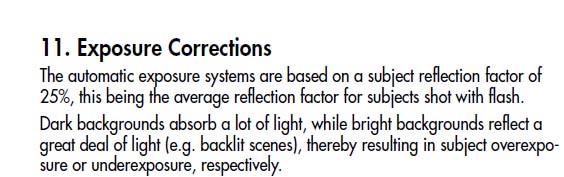

Just found this statement from the manual of the Metz 45-CL4 and it based on the average subject reflectance of 25% instead of the normal 18% so the light needed is about half a stop less.

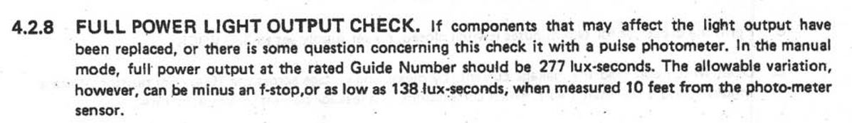

As an update I found this in the service manual fo the Vivitar 283
And if everything is in specs perfectly both the flash and the Sekonic meter then the Sekonic meter with the Lumisphere should read f/10 that is f8 and 6/10 which gives it a GN of 100 according to the meter. (not 120 as published by Vivtar).
