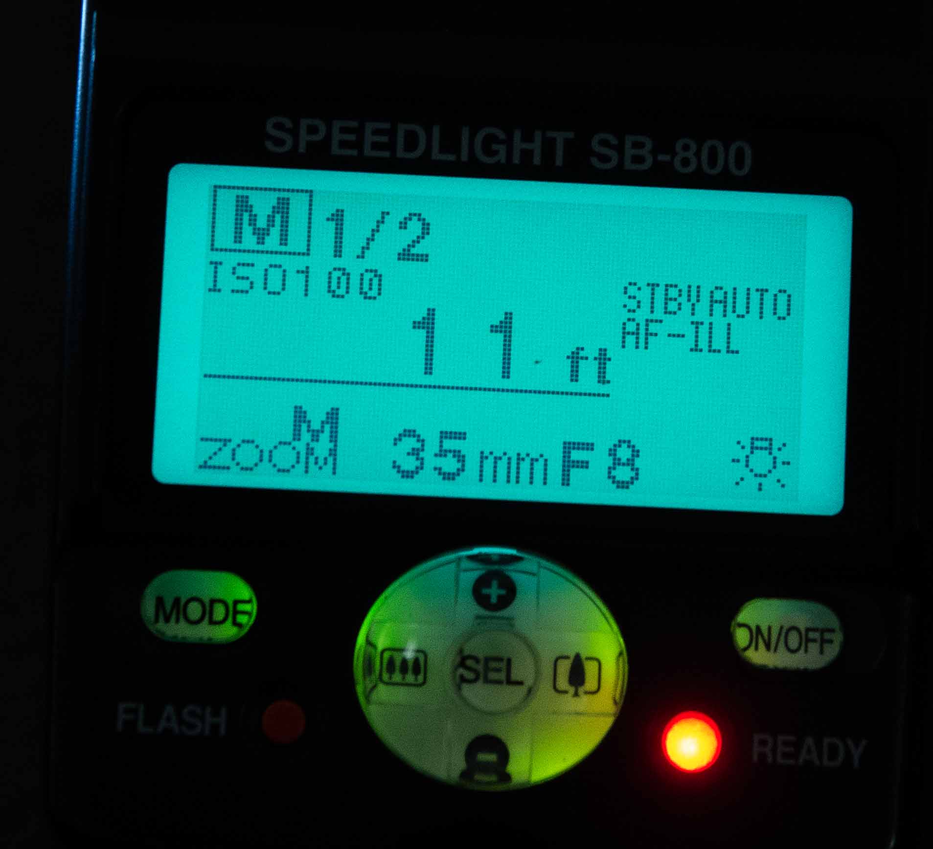

I understand that the OP did this. For example he set the flash on manual, flash head straight forward, 1/2 power, at 11ft. The aperture should be f/8. He would then put the flash at 11ft from his Sekonic meter and made the meausrement. He found the meter said something less than f/8.View attachment 375814
Using the data provided in the spec sheet and GN table in page 42 of the manual, shouldn't the LCD display indicate f/11 or more (rounded from the calculated f/12.5) rather than f/8 in your example?
GN for 100 ASA at M1/2 for 35mm zoom = 88 (ft)
Could the software that calculates the LCD recommended manual aperture be wonky? Perhaps the EEPROM has a bad value stuck in it's craw.

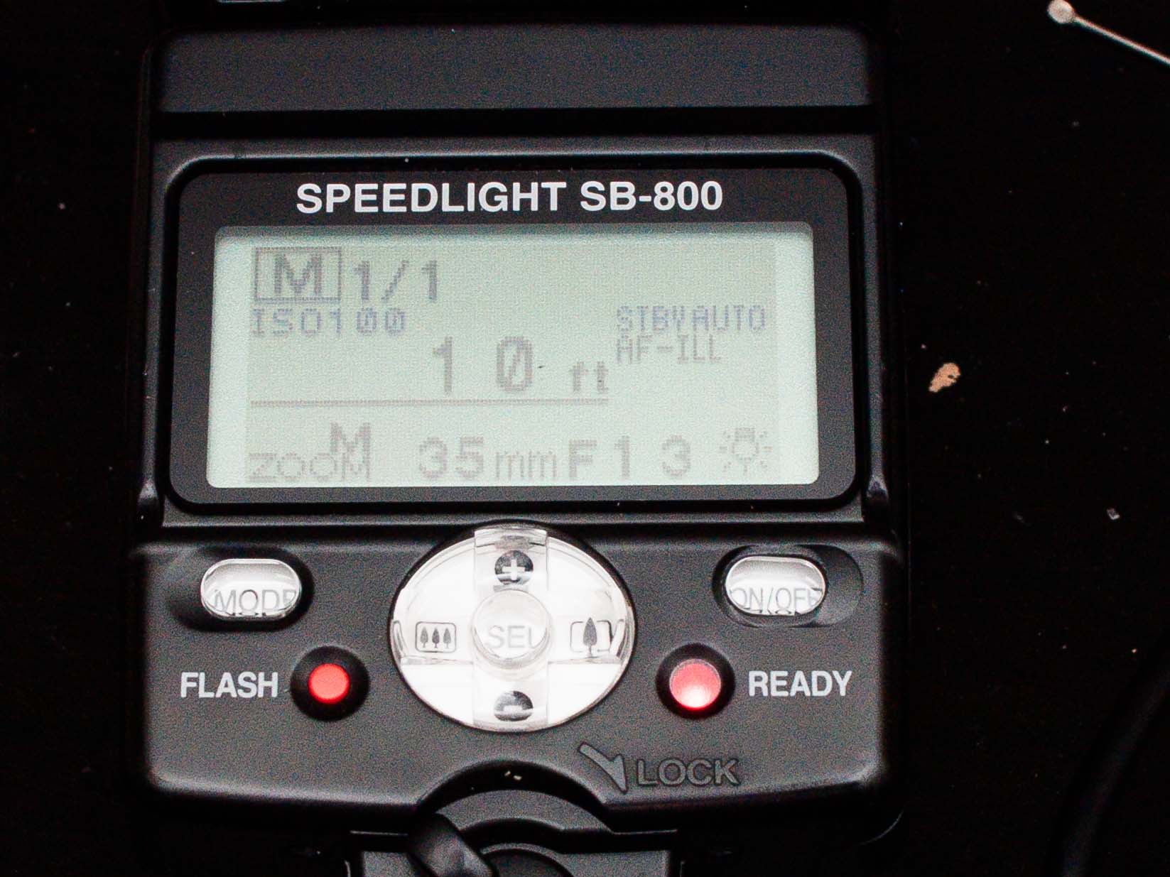

The full power GN in feet is 125. At 1/2 it's 88. GN88 at 11ft is f8. 88/11=8. It would indicate f/12.5 only if the power is set at full power.
This image shows when the power was set at full. 10ft at f/13 (the GN is 125 so the f stop should be 12.5 but rounded off to 13.

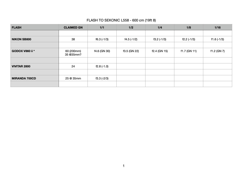

Finally I did a test of the output of my SB 800 in manual mode again - inspired by Chan. I also tested a few other flash guns I have to hand, including a Miranda which is the first piece of photo equipment I ever bought and still going strong, in 1987 (Oh if only I'd stopped there!).
Test was done in my regular living room, at 6 metres. I can do it again in feet if easier, and can do it at 10/11 feet as Chan did. This was just spatially convenient.
I did everything at 35mm @ iso 100 - the Vivitar 2800 doesn't have a zoom adjustment but probably covers 35mm. Despite a lot of searching I could not find a manufacturers specified GN number for the Godox at 35mm, although I did find a comment on dPreview extrapolating that it is likely 35 at 35mm. The published spec is 60 at 200mm, at iso 100.
First observation - the SB800 is pretty close to the LCD spec throughout the power settings (always under-exposed according to the Sekonic but not by much). Actual measured output is listed and in brackets the degree of under-exposure compared to the LCD specification.
Second observation - I didn't expect the SB800 to be more powerful than the Godox, a lightly used unit that is about 15 years its junior. The Godox is also physically bigger.
Third observation - The Godox entries only list the output read-out as measured by the light meter. It was late at that point - not sure if I forgot to write in the Godox LCD proposed f-stop, of it doesn't actually list one on the display. I'll clarify later.
The Vivitar and the Miranda only have full output in manual mode. The Miranda has a clunky manual zoom head (the front fresnel can be slid forward) - but the stated GN at the 35mm position is 25.
I will test the SB 800 in auto mode later with a Fuji x100 Mark 1 that I have. Voltage-wise I think it's safe (?). I can use a remote trigger maybe.

Interesting. That should give you some confidence in the SB-800. Yet it still begs the question of why you saw bigger differences from the Sekonic initially. Both are professional equipment and should be reliable and accurate.
The 2800 is a bit surprising. I have one but rarely use it because it is flimsy and limited capability. But a stop lower makes me wonder... was the wide-angle panel in place? Regarding angle of coverage, you probably make a good assumption on it being roughly equivelent. The manual says
