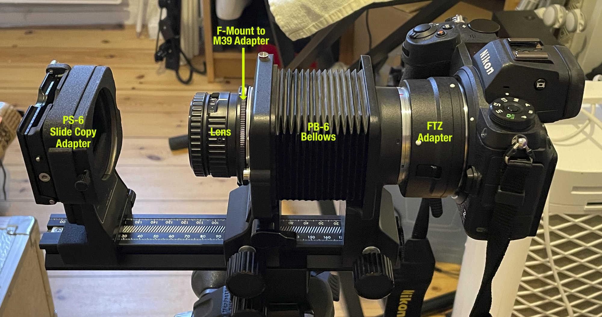

@Ian C, @gorbas and @Dan Fromm,
Here's a picture of my setup (the FTZ adapter is, in fact, an FTZ II):

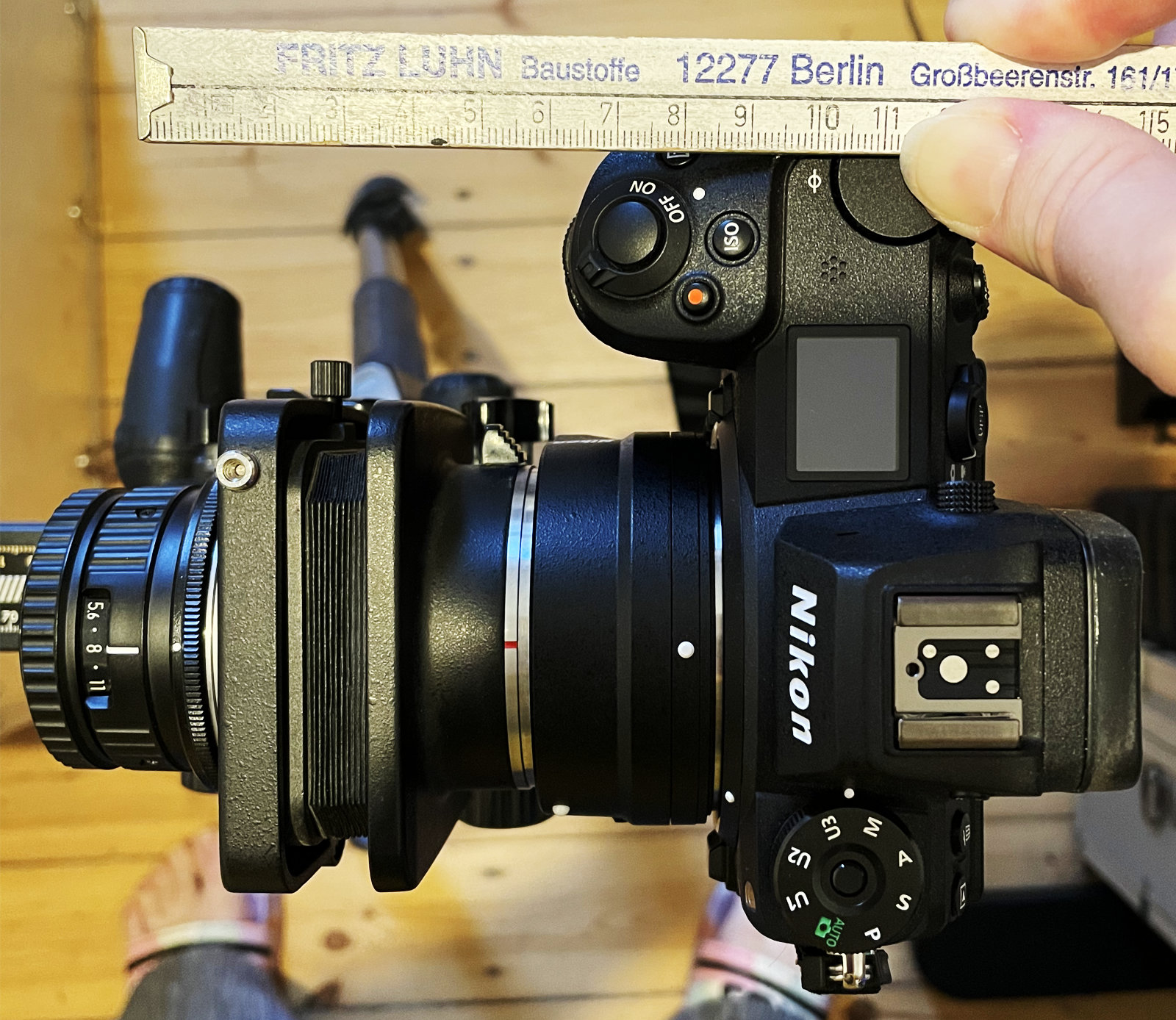

When using the 50mm El-Nikkor, even with the bellows fully contracted, the distance between focal plane (sensor) and lens' nodal point exceeds 100mm, which makes it impossible to get the whole slide or negative in the sensor:
On the other hand, with the 80mm Componon-S, the right distance between focal plane (sensor) and lens' nodal point can be achieved, but then there's no way to focus on the slide or negative, as the rail is too short for the PS-6 to be moved farther away from the lens:
https://www.photrio.com/forum/attachments/img_3401-jpg.416598/
OP, thanks for posting this.
Your rig is more surreal than I expected, and that seems to be the way Nikon intended it.
The PS-4 has a bellows at the rear. The bellows' rear clips into a 55 MicroNikkor's filter threads to keep out stray light. What in your rig keeps the darkness between lens and PS-6 slide holder in? I've checked the PB-6 manual and apparently the PS-6 doesn't have an integral bellows. What was Nikon thinking?
