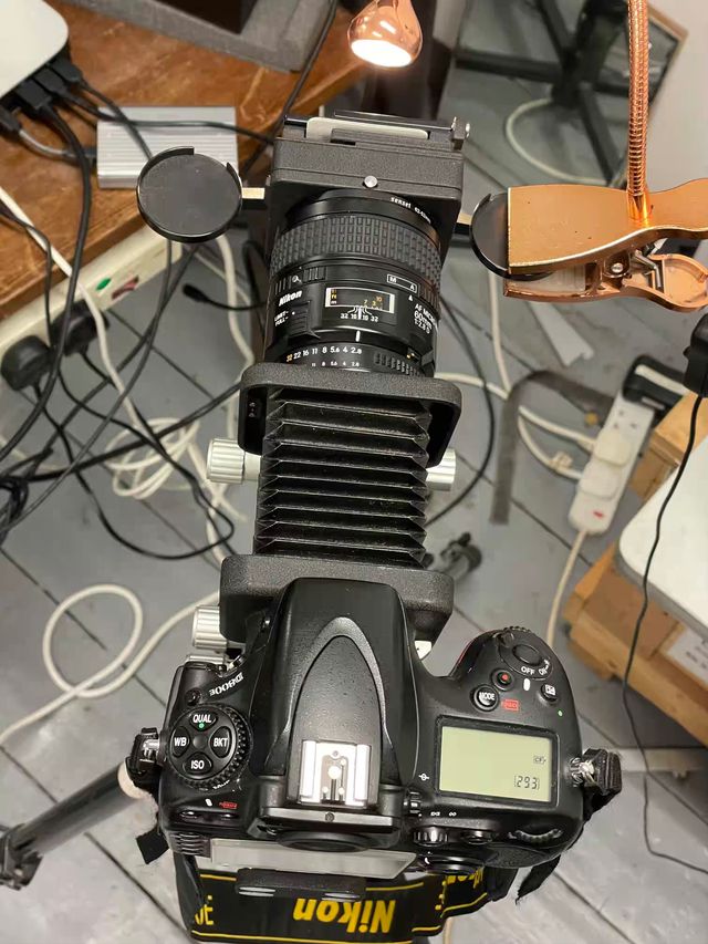

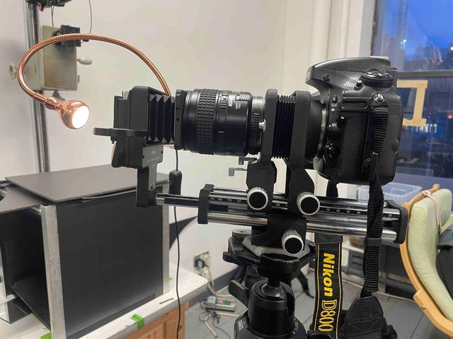

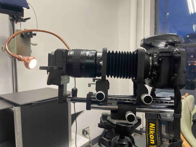

After reading this thread today, I very quickly took out the bellows and set it up with my D800, and 60mm lens. I just used a clip on desk lamp as a temporary light source. I would normally use a flash gun. I could easily shoot a 35mm slide, albeit a lousy out of focus slide, but it was what I had to hand. The first image attached is the rig set for very slightly wider than 1:1 to include the full slide frame. The second image shows the setup where the 35mm is significantly cropped into, producing a reproduction of greater than 1:1 ratio. That's the lens basically front pressed to the PS-4 holder. Btw I use a 62-52mm step-down ring to allow the PS-4 in-built compendium shade attach to the micro-nikkor's 62mm filter thread.

Here are @Ardpatrick 's images.
The first one:
The second one:
And the third one - apologies if I've screwed up the order:
