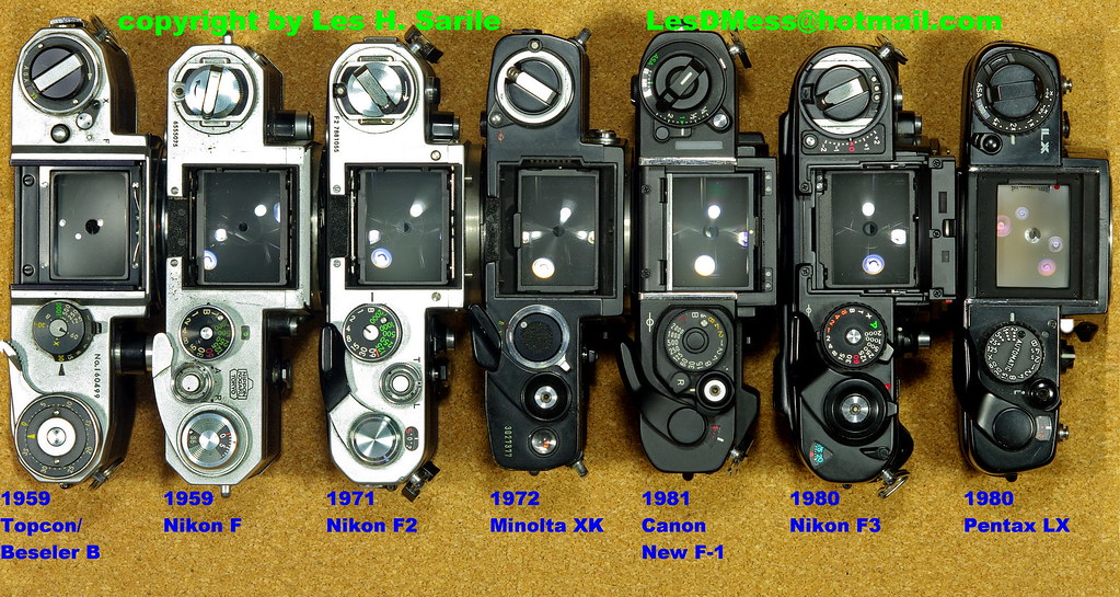

Selection 17 by Les DMess, on Flickr
The eyelevel finders (DE-2 & DE-3) have viewfinder blinds to keep stray light out that may influence the meter unintentionally and the WL - and others, do not. So be mindful of this.
