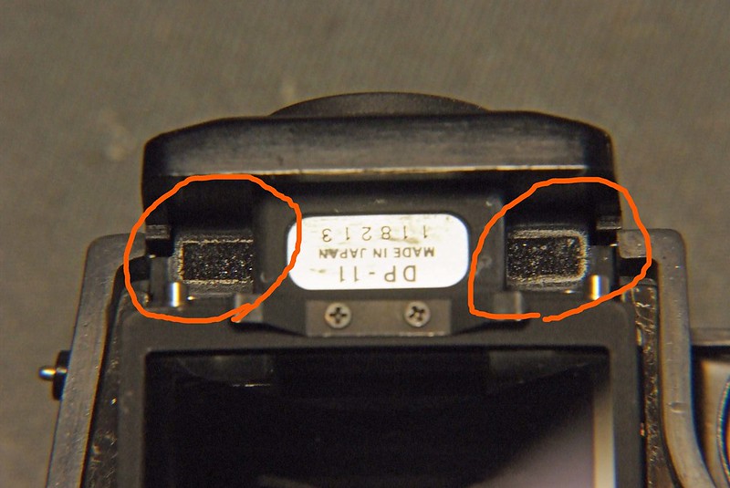

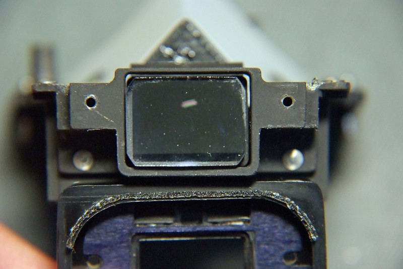

Here's a good example of what APS claimed they did-"Repair and replace DP-11 rubber seal and foam". I don't think so. This is the photo Sover sent me of where it was not done and he did the repair himself.
F2 7831745_6 by David Fincher, on Flickr
So what else did they claim to repair and not do? Even more.
Before...
DP-11 118213_3 (2) by David Fincher, on Flickr
and after Sover...
DP-11 118213_5 by David Fincher, on Flickr

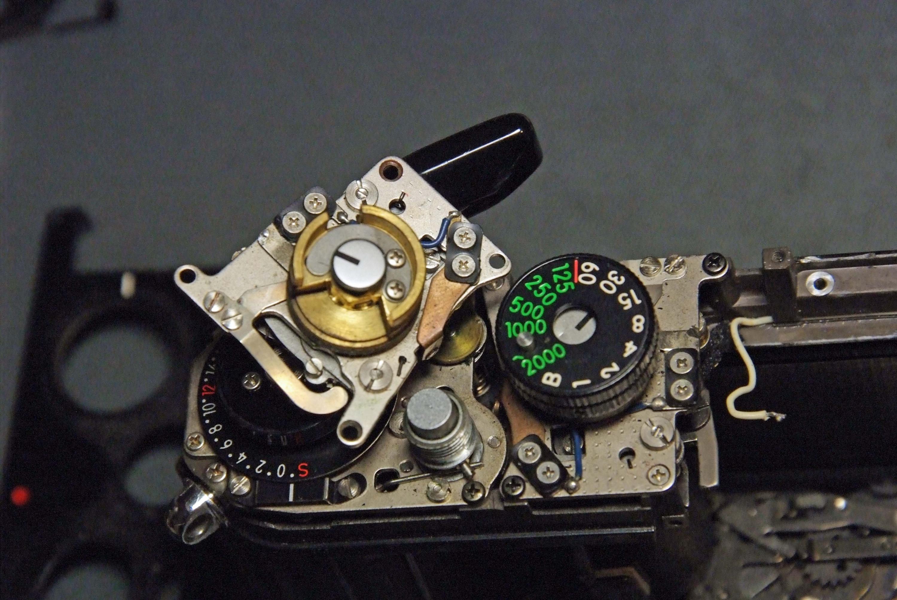

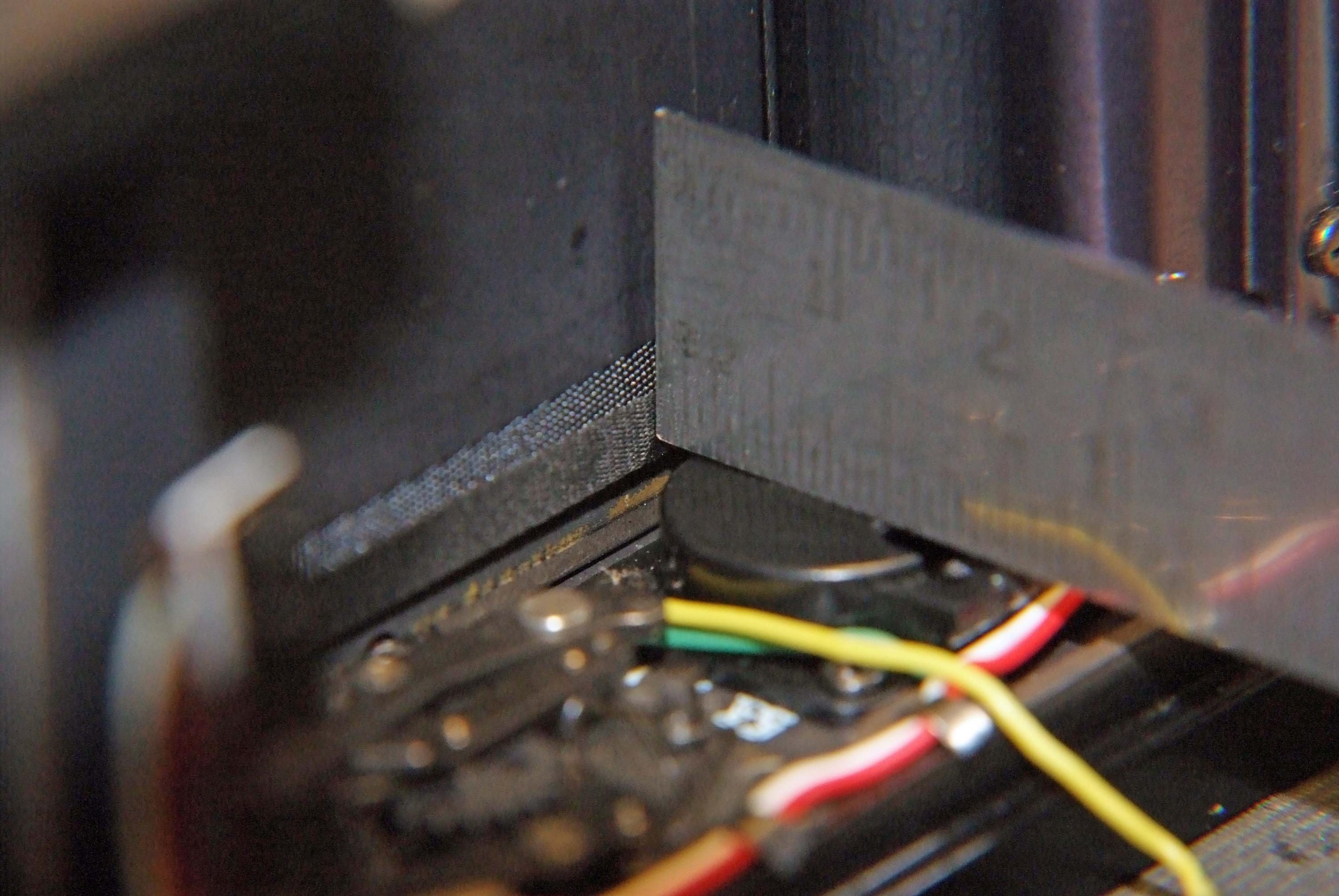

I don’t understand why you so detest my fixed price policy. I am currently repairing a F2 with a damaged shutter speed selector, and then entire mechanism has to be replaced at no extra charge to my customer. Additionally here’s a photo of the same camera showing that a broken top part from the F2 battery chamber can interfere the tape pulls the shutter curtain, contrary to what you are keep saying.
You are clearly offended by me, and despises me. I have no aversion against good and honest repairers. Some repairers, like Pete Smith, have gained my respect and I have sold some of my personal spare parts (DP-3/12 ring resistors and MD-2/3 gears) to other repairers in the US because they don’t have them and can’t find them anywhere else. As I said in my web site, anyone who is an F2 user, collector or repairer is a friend of my. It is clear that you don’t want to be my friend, and I accept that with pleasure.

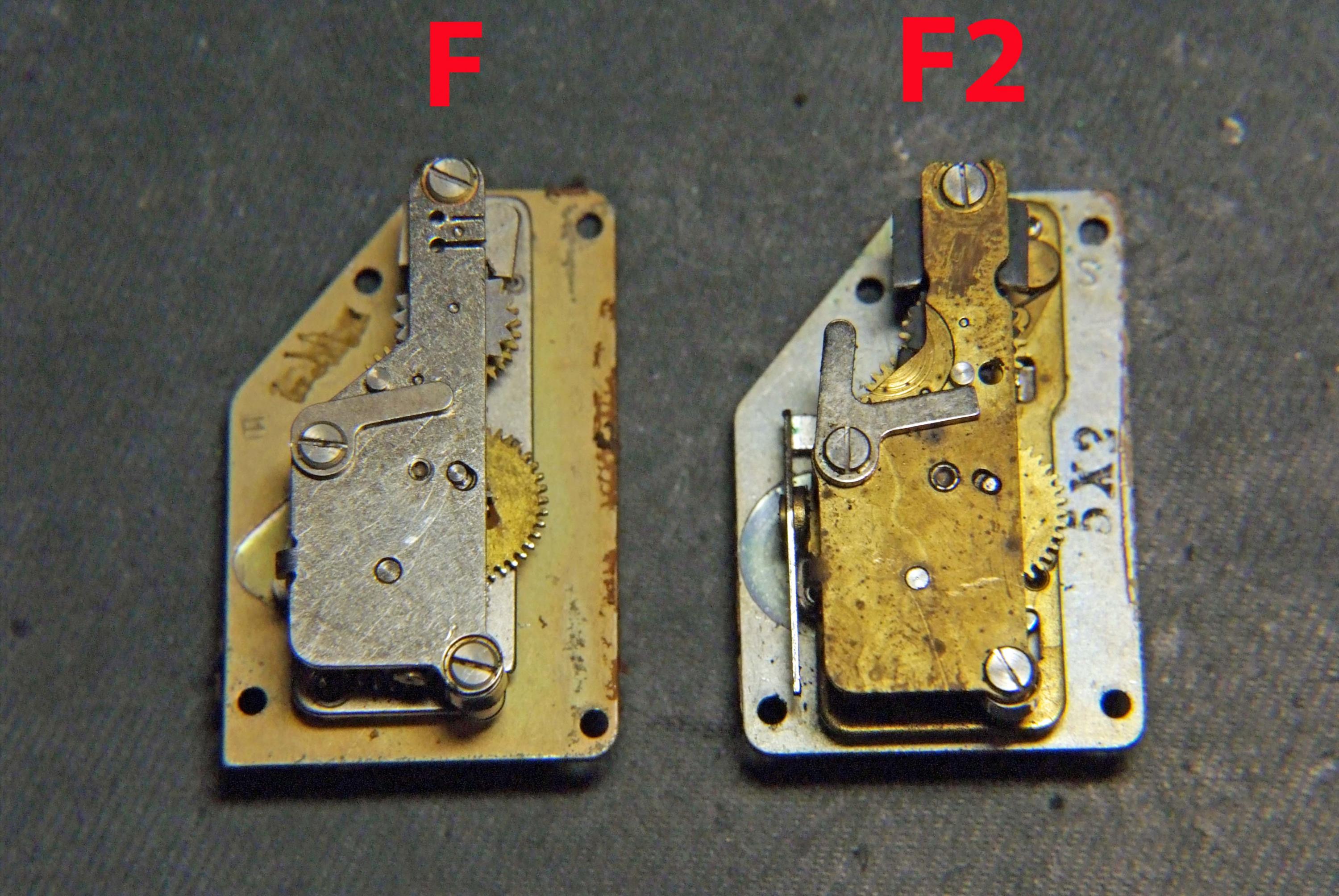

I only aware that the F shutter curtains are interchangeable with the F2. Can you tell me what other parts are interchangeable?
Curtains, selftimer including the plate, slow speed escapement, as well as a couple of the slow speed components..

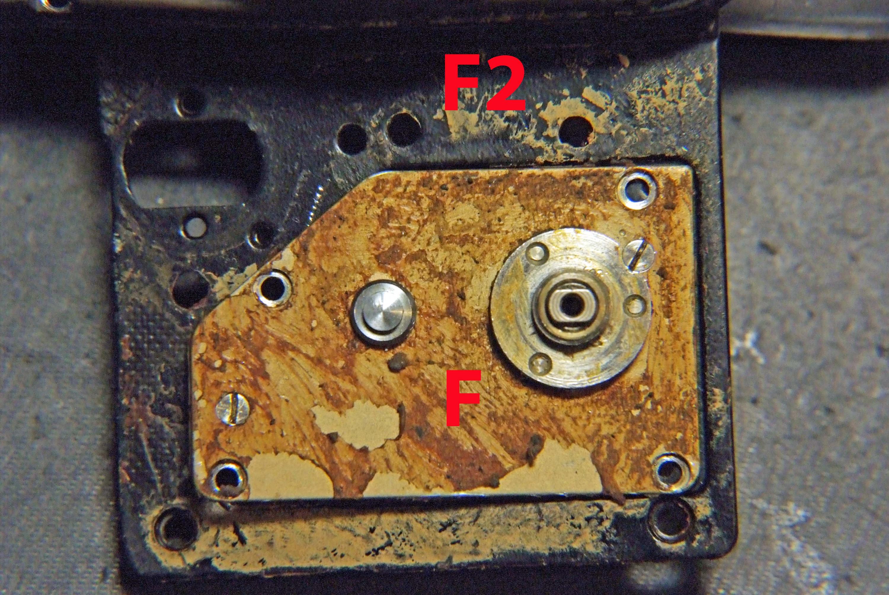

I am aware of the F brake spring, and it’s easy to replace it. I knew it can cause first shutter bounce, but I didn’t know that same spring can cause second shutter curtain bounce.

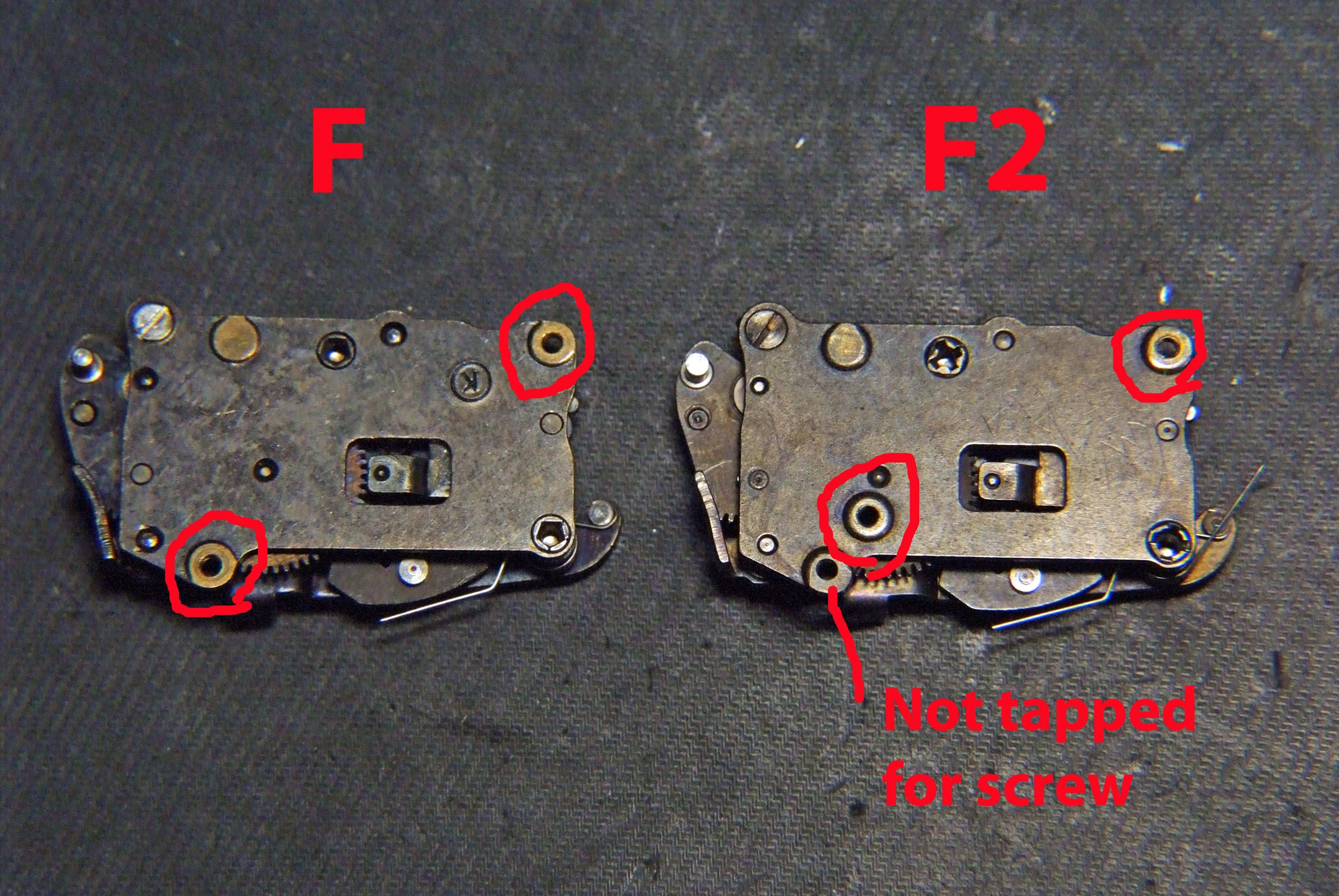

Your are wrong that the F and F2 slow shutter speeds mechanism and self timers are interchangeable. Mounting holes on the F and F2 slow shutter speeds mechanisms are at different locations :
The front plate of the F and F2 self timer mechanisms are different in size and their mounting holes are not aligned. It is not possible to mount the F self timer mechanism onto the F2 front assembly :
No doubt a cowboy would adapt the F self timer and slow shutter speeds mechanisms onto the F2, and vice versa, but I have new and used F and F2 spare parts here.
