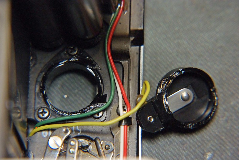

Before exercising the shutter, make sure you haven't left a battery in there for any length of time. I had an F2A that had it's battery chamber cracked and consequently the shutter curtain tape was sticking and there was a space between the curtains maybe 1/16th inch. there's not suppose to be any space but an actual overlapping. If you advance the lever in that condition you're guaranteed a wrinkled shutter curtain and it's useless.
Someone I bought this one from left a battery in too long, cracked the chamber and somehow caused the curtain tape to stick. When you advanced the lever slowly you could see the gap between curtains. Advancing it more would only wrinkle and tear the curtain. Guess how I know this? Mine was sent to Sover Wong along with some pictures and he managed to fix the problem. This is what it looked like going to him.
_DEF5144a by David Fincher, on Flickr
That gap actually got a little larger as I tried advancing the film advance lever...I stopped before things got worse. Sover sent me this picture where the curtain tape had gotten trapped. Moral of the story is don't overlook anything before getting an old F2 back into service. Letting them sit around for years is the worse thing to do.
I can assure you that the battery itself had nothing to do with either issue..
The battery chamber cracking (which is common with the F2) is the result of placement. There are wires that are placed under the tab and the chamber was screwed down which placed stress on the chamber tab causing it to eventually crack..
As for the shutter tape: the most likely cause based on over 40 years of camera repair experience was a sticky shutter spring which allowed for slack to develop which in turned caused the tape to slip over the shutter lathe.
Not according to Sover...
" -The battery chamber cracked completely, probably due to swollen batteries in the past, see Photo 2
- A shutter curtain pulling tape was trapped, probably caused by the broken battery chamber, see Photo 3"
This is Photo 2
F2 7831745_2 by David Fincher, on Flickr
At any rate, he fixed the problem.

Sover Wong says a lot of things I don't agree with...and I have been servicing cameras since before he went into the business..
Two things that cause the breakage in your image is as I said the routing of the two (green and yellow) wires. The person who built this camera was not paying attention or was in a hurry (Japanese QA was not always up to snuff contrary to popular belief). Or a combination of the wires and the battery contact being bent up too far which puts excess pressure on the fragile plastic... Nikon eventually admitted these issues and fixed the problem in later models of the F2. If battery swelling were to cause something like this, it would have to swell considerably since there is room for expansion.
In 1975 I bought a new F2 and discovered the same breakage as in your image 3 months later and there was no swelling of the batteries..
Going by your image it looks like someone tried to epoxy the two parts back together but epoxy does not work for long on this type of plastic.
The Nikon F had far superior QA than the F2...

- A shutter curtain pulling tape was trapped, probably caused by the broken battery chamber,.
In order for the shutter tape to have been trapped in the battery chamber it would have had to come out nearly half an inch which is impossible with a camera in supposedly working condition. The mirror box contains light trapping and prevents the tapes and curtains from going that far out of their track..

"Sover Wong says a lot of things I don't agree with...and I have been servicing cameras since before he went into the business.."
I haven't been on APUG for years but someone pointed out this thread to my attention. leicarfcam can you elaborate the many things I said (from where?) that you don't agree with? I would like to learn from you, as I don't know everything. Can you tell me who you are and where do your work?
As for that battery chamber, it was not previously repaired by epoxied and I have not seen a battery chamber broken like that before. It was the loose piece from the battery chamber that dislodged the tape which pulls the shutter curtain.
Please explain to me how the loose piece dislodged the shutter tape since it is protected by the mirror box. A piece that large cannot get between the tape and mirror box to do so..

Under the F2 mirror housing, there is a small gap for a thin piece of material to move around. That F2 had no corrosion, and it’s almost mint.
I agree but the pictured battery chamber part was too big to fit through the gap so it did not cause the tape issue. Without having seen the camera I would venture to guess the issue that caused the overlapping tape was caused by a sticky spring that allowed slack to develop which then caused the tape to overlap.. There could have also been an obstruction somewhere else bu again without having seen the camera it would be simply guesswork.
