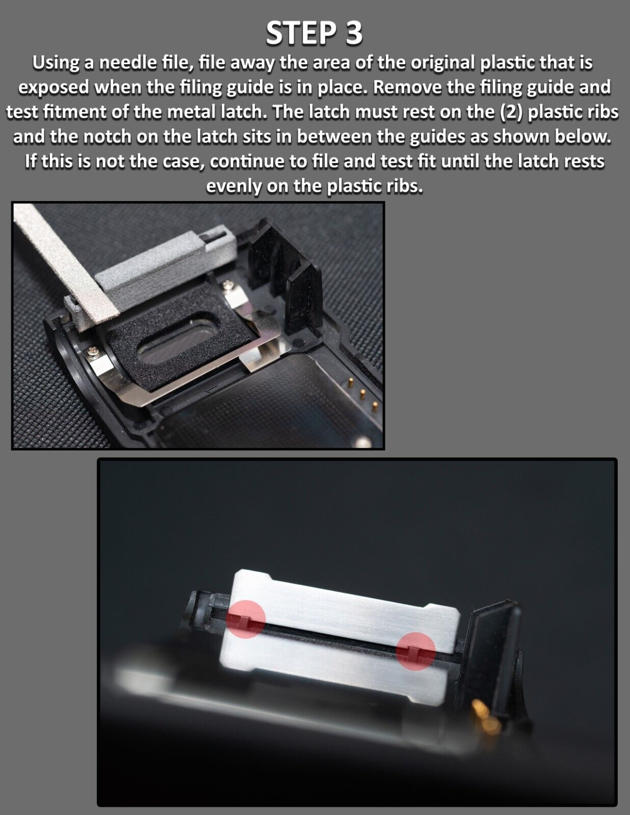

As a update; The N80 purpose latches should be ready for shipping in 2 weeks. Just got word they are done being machined. I will be making a new purpose made instruction manual for the N80 as I have a N80 with broken latches that I will be working with for step by step pictures. I have already used the new filing guides and they set the height perfect to where a purpose made latch is not needed. I am mostly doing the N80 latch for cosmetic reasons. Once all that gets sorted I will split the N80 to a new eBay listing so I can better keep track of orders.

New latches for the F80/N80 are in and I test fit on my N80 with broken latches. Works like a charm. Price for on forum buying is that same as the F100, 32 shipped for domestic shipping.

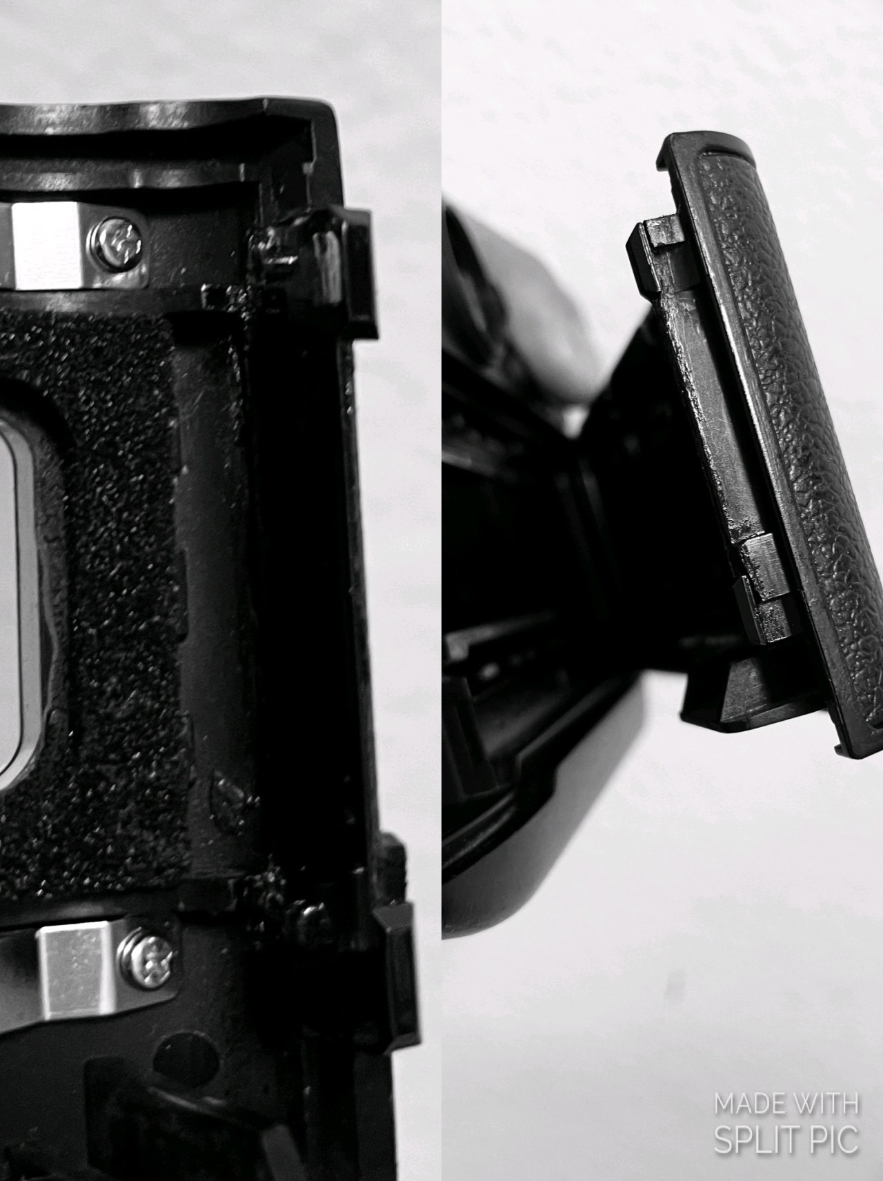

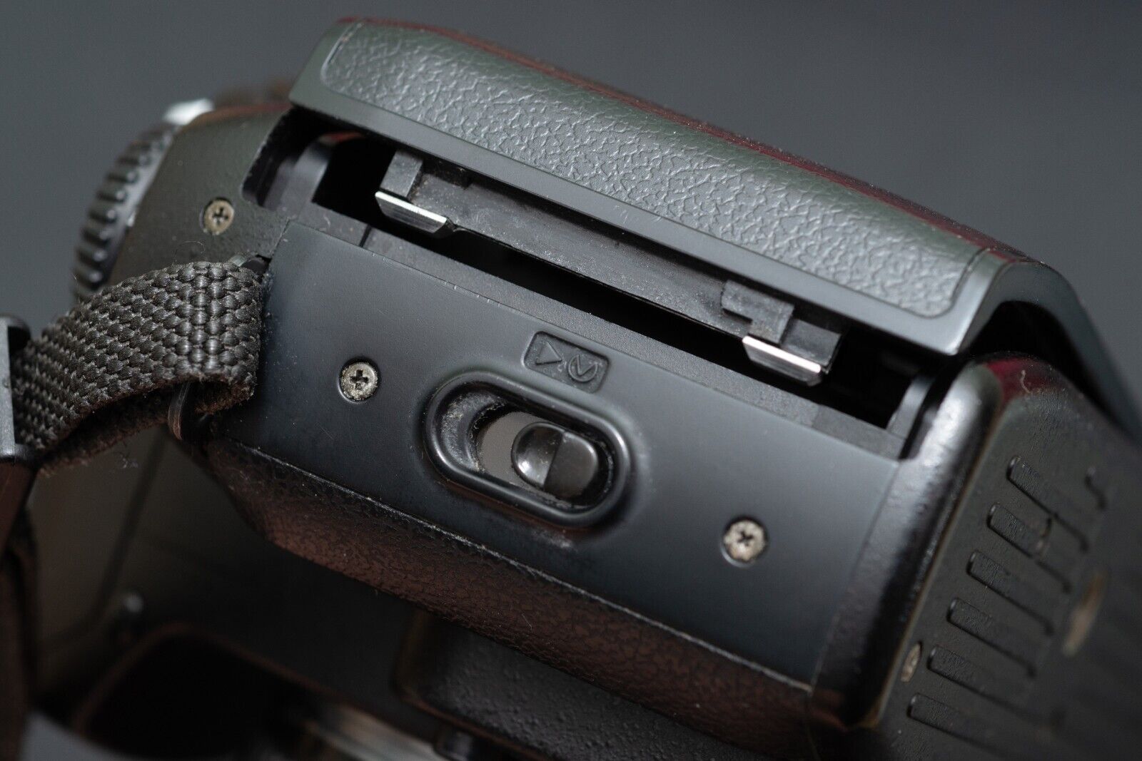

I have updated the latch design slightly for the N80 and the F100. I increased the thickness of the latch protrusions so I could get even more of a chamfer on them. This increased chamfer makes for reduced friction between the inside latch and the new metal latch and makes the door close even easier. Like before, machining marks are removed with a fine file and (3) grits of sandpaper for a nice cosmetic look. The updated F100 latches have been shipping for a couple of months but the updated N80 latch is now shipping as of last week.
See below for installed pictures on my F100 and N80.
