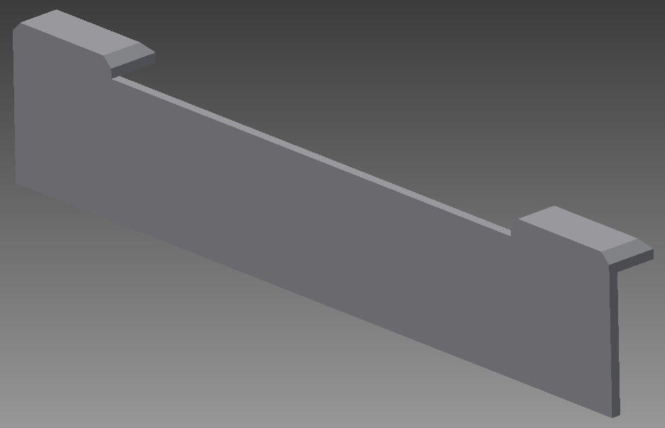

I want to share my attempt at creating a long term solution to the Nikon F100 and the plastic latches that fail on the film backs. This started a couple months ago with a F100 that I won at a estate auction with a broken door. My primary F100 served as a reference to lock in the dimensions of the metal latch that would be needed to fix the issue. After my initial prototype proved to be successful, I placed a order for 100 of these metal latches to be machined out of 1018 mild steel. I also designed a 3d printed filing guide that makes removal of the plastic quick and easy. It essentially masks off the plastic so you only remove what you need. So far I have installed (2) of these and another individual as successful installed one. Since I am new member I cannot PM or receive PMs but please feel free to e-mail me at Olympus9595@yahoo.com if you would be interested in a kit.
Hopefully I can help save more film backs so they do not end up in the trash.

I suggest using a stainless steel instead, as 1018 can develop a patina of rust. It doesn't hurt its function, but it doesn't look good. Free-machining SS, (303 for example) are easier to machine, if that's an issue.
Or, just as good in this application, black oxide treatment on the 1018 would resist rust well, and also be black to match the body
Good points. Stainless is more expensive and it is harder to machine thus the unit price would be more. 303 Stainless is more machinable but its corrosion resistance is inferior to 304 due to the sulphur and the price would still be more than 1018. I was also worried the hardness of the 300 series stainless family might start wearing the internal latch mechanism. Given the location of the latch, and if corrosion was a worry, a very thin layer of grease would do the trick. Only application of grease would probably be satisfactory for years.
I also did think of black oxide but they come in with a as machined finish. I use a variety of sandpaper grits to produce a brushed finish. I would not be able to do that with the black oxide finish although the machining marks would be orders of magnitude less noticeable. There are so many ways to skin the cat as they say.

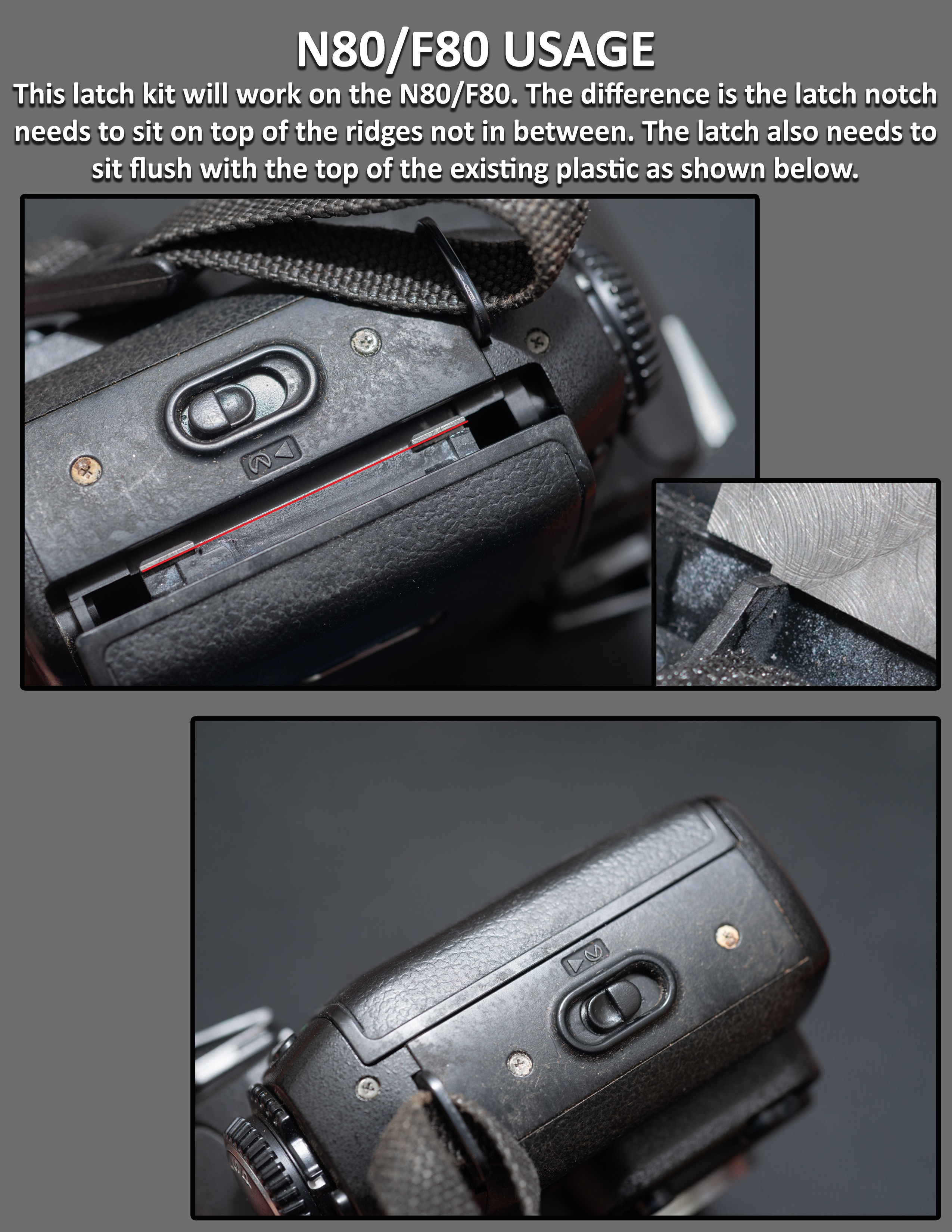

So I acquired a F80/N80 because I had one issue with a buyer who was having trouble. I identified the only real difference between the F100 an F80/N80. The latch needs to set basically .5mm higher and that is it. I am going to work on making a filing guide for the F80/N80 which will basically remove .5mm less material. In the meantime I can ship these with a .5mm strip of plastic you put under the filing guide to raise it up during filing.
Yes, I had to do modifications to get it to close properly on N80. I didn't post too much about it, as I figured you would address it or make a separate one for N80. '
Yep. Most of the time the latch is going to sit correctly due to the 28mm tab being too wide to fit into the recess between the (2) ridges like on the F100 which is why it worked for the vast majority of people. The latch ends up sitting .5mm higher than the F100 just because of that. The issue though is the other side of the latch can dip into that recess and potentially cause a issue.
So, my goal is to just make a purpose N80 latch kit. The first step is to ship the F80/N80 latches with the new filing guide which I should be getting next week. The filing guide will shave .5mm less material than the F100 filing guide.
I have a new design for the F80/N80 which basically just removes the tab and makes the latch .5mm taller. The new metal latch will not be ready until around mid March. That should take the guess work out of it.

The new latch specific to the N80 still is a couple of weeks out. Filing guides are coming today. You can always use the older guide just do not file all the way down to the guide. Keep test fitting the latch until you are riding on top of the ridges and you will be fine.
My plan, on eBay, is to wait until the new latches come so I have a specific guide and latch for the N80 and provide a drop down option for each specific camera on the eBay listing. If you buy from me direct I can easily provide a new filing latch with the F100 latch in the meantime.
Filing guide is in. Pretty much makes it so the F100 latch fits perfect as is on a N80/F80.
