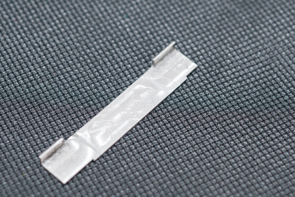

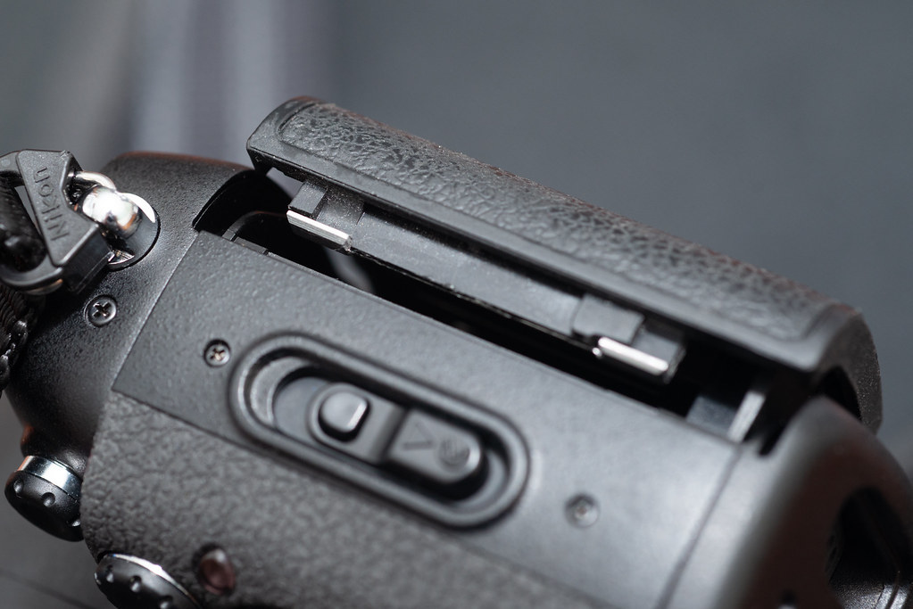

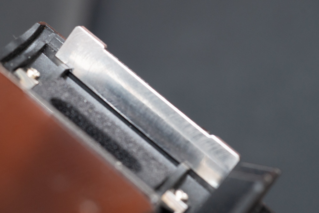

I want to share my attempt at creating a long term solution to the Nikon F100 and the plastic latches that fail on the film backs. This started a couple months ago with a F100 that I won at a estate auction with a broken door. My primary F100 served as a reference to lock in the dimensions of the metal latch that would be needed to fix the issue. After my initial prototype proved to be successful, I placed a order for 100 of these metal latches to be machined out of 1018 mild steel. I also designed a 3d printed filing guide that makes removal of the plastic quick and easy. It essentially masks off the plastic so you only remove what you need. So far I have installed (2) of these and another individual as successful installed one. Since I am new member I cannot PM or receive PMs but please feel free to e-mail me at Olympus9595@yahoo.com if you would be interested in a kit.
Hopefully I can help save more film backs so they do not end up in the trash.

It took me about 5 minutes and I designed it to be pretty straightforward and easy. Biggest thing to remember is make sure you file enough of the plastic so that latch fits on the two ribs flat. The instructional manual should have you covered. As long as you can use a file and use superglue it is a piece of cake. The filing guide really takes the guess work out.

I just installed one of these on my F100, and it worked great. What a fantastic solution! The only issue I had was that there was still a piece of the broken plastic latch in the body latch recess that was preventing the door from fully closing. Once I got that out, it worked like a charm. Thanks!
