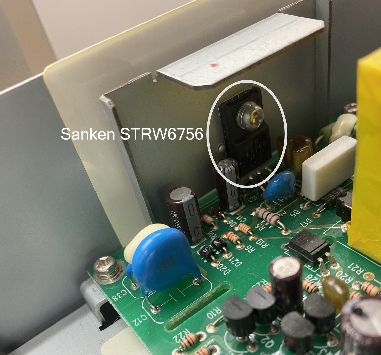

My Coolscan 9000 refused to switch on a few days ago, after having been used as normal the previous day. This website: https://www.shtengel.com/gleb/Nikon_8000_9000_power_supply.htm - suggests a particular integrated circuit is usually at fault.
https://www.semicon.sanken-ele.co.jp/sk_content/str-w67xxseries_an_en.pdf - if anyone else has suffered this problem on Photrio - is there anything else that is likely to have gone wrong? - the continuity of the internal fuse is fine.
I've seen recommendations for https://lincolnscan.co.uk/ as a repair option but it would be useful to have some more general idea.
Assuming the actual power switch works OK (test it with a continuity meter):
Start by checking the electrolytic capacitors; observe if any have a bulging cap and/or have started to ooze electrolyte either from the cross shape at the top, or along the legs. If so, these will need to be replaced.
The controller & switching IC is a logical item to replace; you might just give that a try and see if it helps.

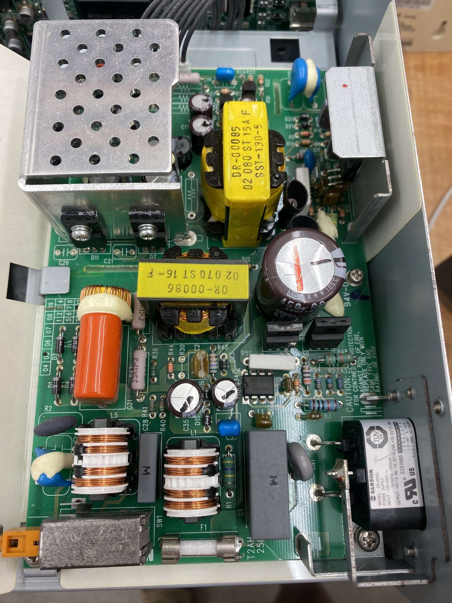

Thanks. I'll take a closer look. I've attached a photo showing the general visual condition of the power supply.

It looks excellent. There was a massive problem with electrolytic capacitors around the time this unit was manufactured, however it clearly does not affect your power supply. I'd put my money on the IC you mentioning having given up the ghost after 20 years of service.
- this article suggests the problem persisted for a several years. https://en.wikipedia.org/wiki/Capacitor_plague
Yes, indeed; I had to deal with it back then quite extensively. I've replaced many capacitors on computer mainboards, which was an application where the problem popped up early on given the high ripple current loads and high temperatures the caps are subject to in such a context.
What makes me state with confidence that this particular concern is not applicable to your power supply is the lack of visible damage (no 'popped cans') and the fact that if the capacitors in your scanner would have been from the many affected batches, the problems would have popped up about a decade ago at the latest.
Mind you, ultimately, all electrolytic capacitors fail. But most will take many decades before that moment comes.
I've just had another look and cannot see any visible damage. I also checked the continuity of the power switch and that is fine.
Good work! Looks like the next step would be to get one of those IC's. I checked earlier today; they're around 1 eurodollarpound/pc if you get a handful from China.
Yeah, if this is your first time doing work on a PCB, you'll have to learn a thing or two. Maybe get your hands on some old/broken equipment and practice on that. Or - see if you can find someone near you to do this for you.
The easiest way will be if you cut the leads of the old IC before trying to desolder them. Then get some desoldering braid and flux, and use that to suck out the tin from the contacts. At that point, the cut pins should wiggle out of the holes fairly easily - provided you can get the tin sucked out well enough (from both sides of the PCB!) With the pins out, clean up the holes a little more with the desoldering braid so they're nice and open. Then slide in the new IC and solder the joints.
The hard part is removing the existing pins from the PCB so as not to damage the PCB and leave clean through-holes for the new IC to fit into.
Looks like a slow-blow fuse in the bottom of the picture. Have you checked continuity across it? I had a failed power supply for a Leitz Focomat V35 enlarger with a dead fuse. You can't check by visual inspection.

That is an integrated circuit with a powerful switching transistor, which I wanted to replace when my Coolscan 9000 stopped working 10 years ago.
The main switching transistor in that IC had a shortcut, I found this IC on the web and I replaced it.
After reassembling the coolscan 9000 the IC went shortcut again, immediately after power on.
So I asked some technician who has much knowing of switching power supplies for help.
He assumed that the power transformer had a shortcut within its coils what caused the shortcut in the IC.
So I searched the web for a complete power supply for the coolscan 9000 and found the last one in Russia for some hundred US-$.
That was about 9 years ago and I don't think there will be any parts of a coolscan 9000 available today.
Yep, there's always the question why the IC blows up. Then again, if the transistor was shorted out, you would have also had a blown fuse, no? The transistor switches the primary of the transformer. If that's shorted and the transistor shorts, the fuse would blow as well. Did this happen on your device?
In any case, there's always the chance that the IC just died for no particular reason. Replacing it is often the cheapest diagnostic. This is one reason to purchase a handful, not just one (the other reason being that they're generally a lot cheaper that way).

I remember that there was a resistor of some Ohms between the ground pin of the IC an the real ground of the circuit which was blown.
The picture in #1 shows it - the white rectangular thing in the right upper picture corner is it, I think.

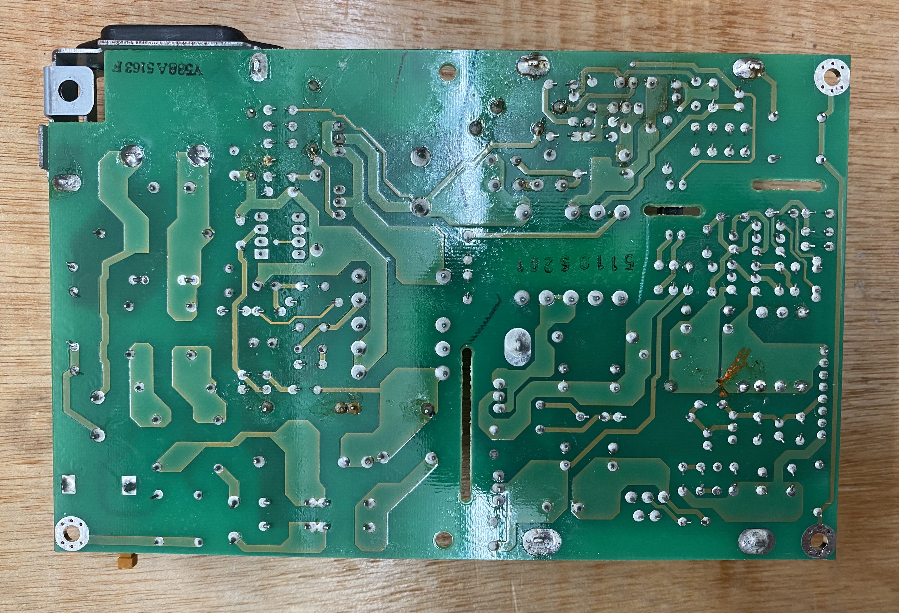

I've done some more investigating and have removed the power supply board from the scanner. Attached is a photo of the underside of the board. All the resistors I've measured so far have been okay, although with a couple the measured resistance increased over time, assume this is related to contact between the probe(s) and component.
This is usually due to a capacitance parallel to the measured resistance slowly charging, which affects the readings.
The PCB looks OK; I wouldn't have expected to see any damage here. It looks almost as if someone did some work on this unit at some point.
I should probably check the voltage of all the capacitors then, I'm learning as I go here. The high voltage capacitors were at zero volts when tested.
I see what you mean, which is why I included the photo. However, I've owned the scanner from new in autumn 2006 and it hasn't been serviced previously by myself.
No, don't worry about this. The gist is just that measuring resistors (or any kind of component) within a circuit only works to an extent. There's not all that much you can do about that - or at least not much you need to do in this case.
As to the work on the PCB: this could just as well be a minor correction at the end of the assembly line; e.g. some joints that didn't come out nice from the reflow solder bath that they touched up manually. The board looks fine in any case.
