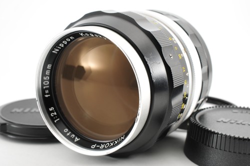

Which 105/2.5? Older Sonnar type or newer double Gauss type?

There are two different optical constructions and the earlier one, attributed to be Sonnar-type, has a smaller rear element. Like this one:
All the later ones are of the same double-gauss construction as far as I have been told. The later one worked very well as a portrait lens when i used it as such.

Agreed that it is worth seeking out the Nikkor-P Sonnar version, and especially the last run (serial number range 234140 - 286451) as there was a Nikon factory AI kit for them, so you can find them AI'ed but not filed-down by hand. Later Xenotar non-AIs are easily available with factory AI kits already installed as well, but if you're going Xenotar, you might consider the cosmetic changes Nikon made to be a determining factor (sliver vs black nose, metal vs rubber focus-ring, f/32, etc.)

A link to the older Sonnar-derived version has been posted above. It can be identified by its smaller rear element and btw. they all have silver parts on them.
Large rear element = Xenotar
Small rear element = Sonnar

All the Sonnar lenses had a silver-snout, but some Xenotar lenses also had the silver-snout, so that isn't definitive. The best visual indicator is the size of the rear-element: The Sonnar design is notably smaller and inset from the black light-baffle, while the Xenotar's rear element is the full size of the light-baffle.
Of course the lens' serial-number is an absolutely reliable way to tell, with the Xenotar starting in the 4xxxxx range (Sonnar is in the 1xxxxxx or 2xxxxxx range). For all this information, see Roland Vink's website.

Well, "coveted" might be an exaggeration! I would say that Nikkor-collectors like to celebrate the arcane history and lore of the more renowned lenses, into which category the 105/2.5 definitely falls. The fact that Nikon made the transition from the Sonnar to the Xenotar design (in 1971) while keeping the lens's mechanical design largely unchanged (the silver snout) means that if you are just casually looking through a selection of used 105's, you might not even realize that some of them were Sonnars unless you really knew what you were looking for. Clearly, Nikon updated the design to improve the lens's optical performance, so they felt the old Sonnar layout could be bettered, but better isn't always what you want, and some photographers preferred the rendering of the older design, and sought out copies of them and "told their friends". As noted above, the Sonnar is noteworthy for its Bokeh, and pleasing rendering wide-open at portrait distances.
Of total non-AI production, approximately 130K copies were Sonnar design, and 190K were Xenotar, so the Sonnar certainly isn't uncommon (for that you would be talking the early 9-blade aperture version, or the super-rare "tick-mark" copies), but I think for sure any fan of the 105/2.5 should consider owning (and using!) a copy of the Sonnar.
