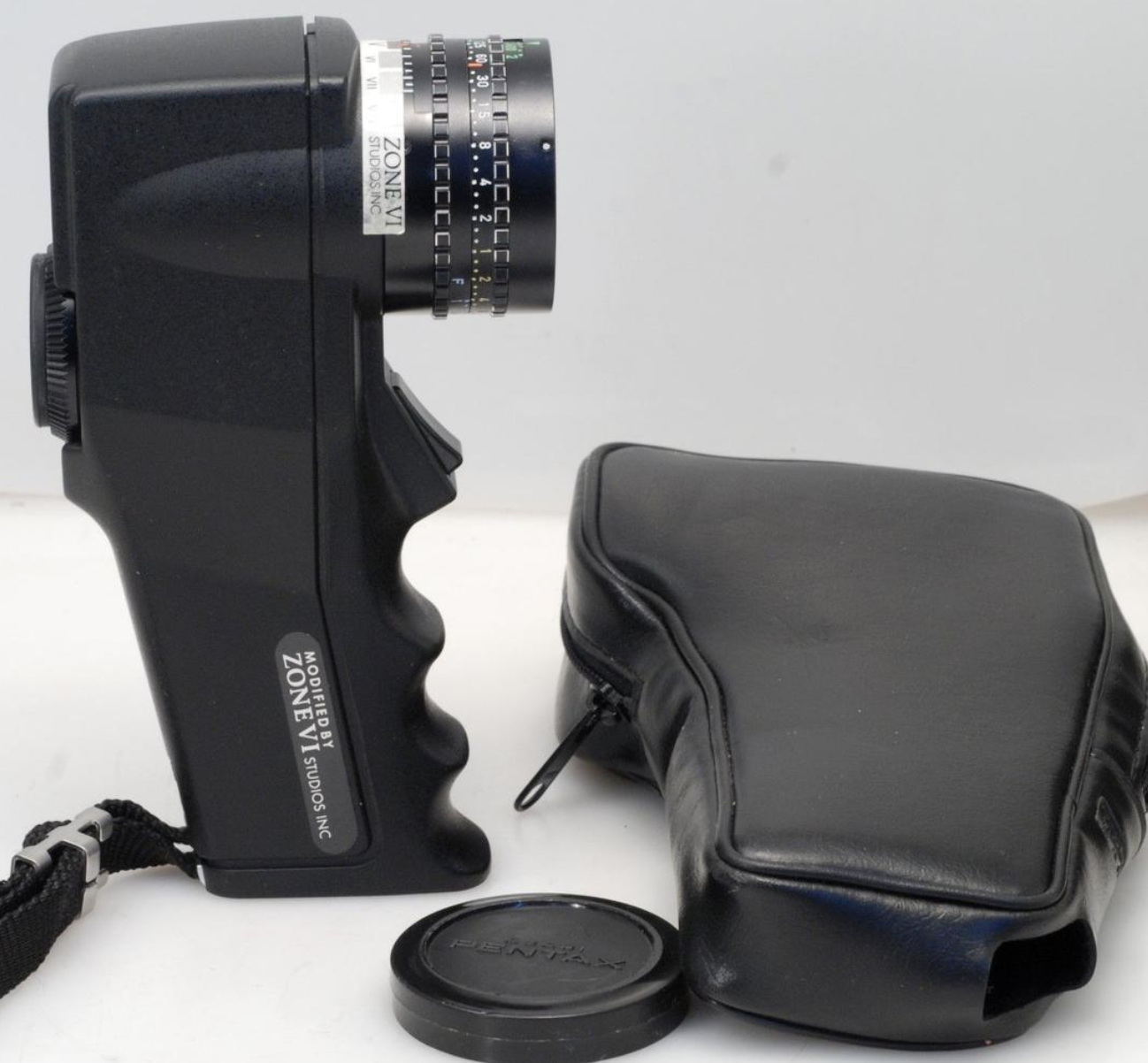

try to return it. Zone VI modified meters are terrible. The plain Pentax Digital is much better in my opinion. my modified meter was thrown off by warm colors too.

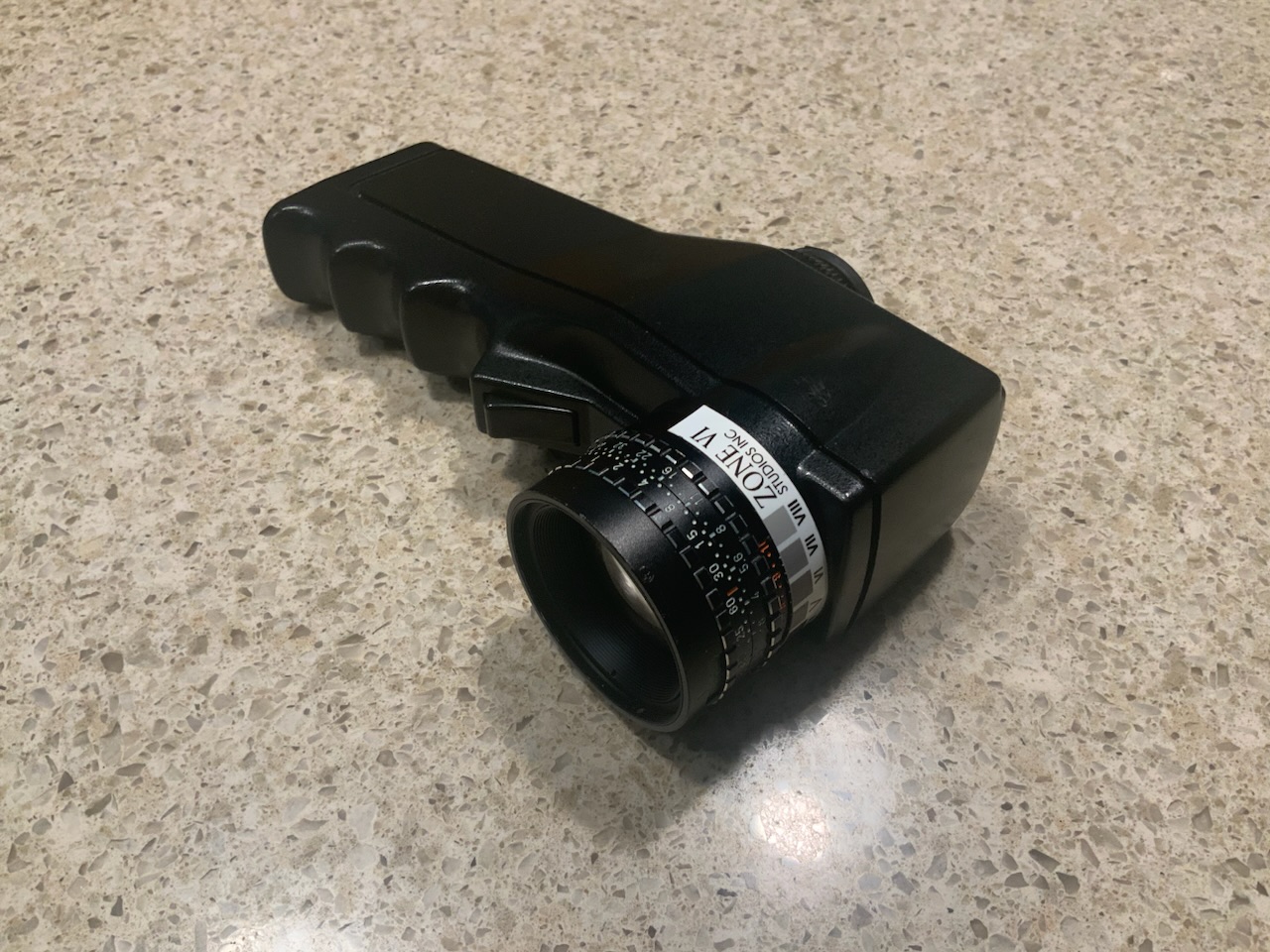

Ralph, I don't see any confirmation that this is a modified meter. I bought the sticker from F Picker for $1....they were widely available for various meters.

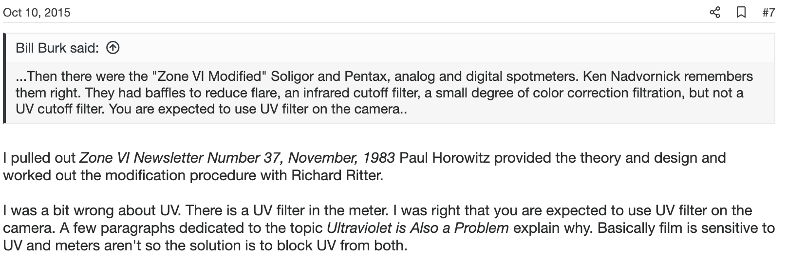

The modified meters, I believe, were clearly post-labeled as such. Lacking that, and the presence of the Zone scale only, it's safe to assume it's unmodified.
I had no idea there were modified and unmodified meters. Drew mentioned a post lable and I see no labels or markings. I thought the zone sticker was for connivence. My understanding is if I take a reading of a dark area I want in a particular zone I just line the EV number of the reading to the zone I want it to end up in, right?
Exactly...... but Zone VI sold labels for various light meters to make metering for the Zone system easier.... & they also sold meters with internal modifications

FWIW I have a Pentax V Spot Meter with the Zone VI scale on it. And it's a genuine Zone VI scale as far as I can see, it's far better printed than the knock off's, and doesn't fit as well as the knock off's (which is a sign the fakers are trying too hard). But the Pentax V meter when modified had another label on it by Zone VI on the opposite side of the camera saying 'modified by Zone VI' (and mine hasn't). So if the precedent is set the additional label should be the decider for a modified meter. Alas mine isn't modified but is still extremely accurate.
250. I have an unmodified Pentax Digital spotmeter. I bought the Zone VI sticker from Fred Picker....tells you how long I've had the meter. It has travelled many thousands of miles with me & still works like a charm. I've thought about sending it to Richard Ritter for re-calibration.... but my negatives are always good. The Pentax Digital is a fine meter in my book!

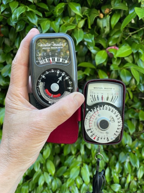

Left: Master II. Repaired by swapping parts. Not yet calibrated. Has the most active selenium cell in my collection but feels like it overdrives the ammeter.
Right: I didn’t even know there was a Master 6.
see? A modified meter!(how unfortunate!)
