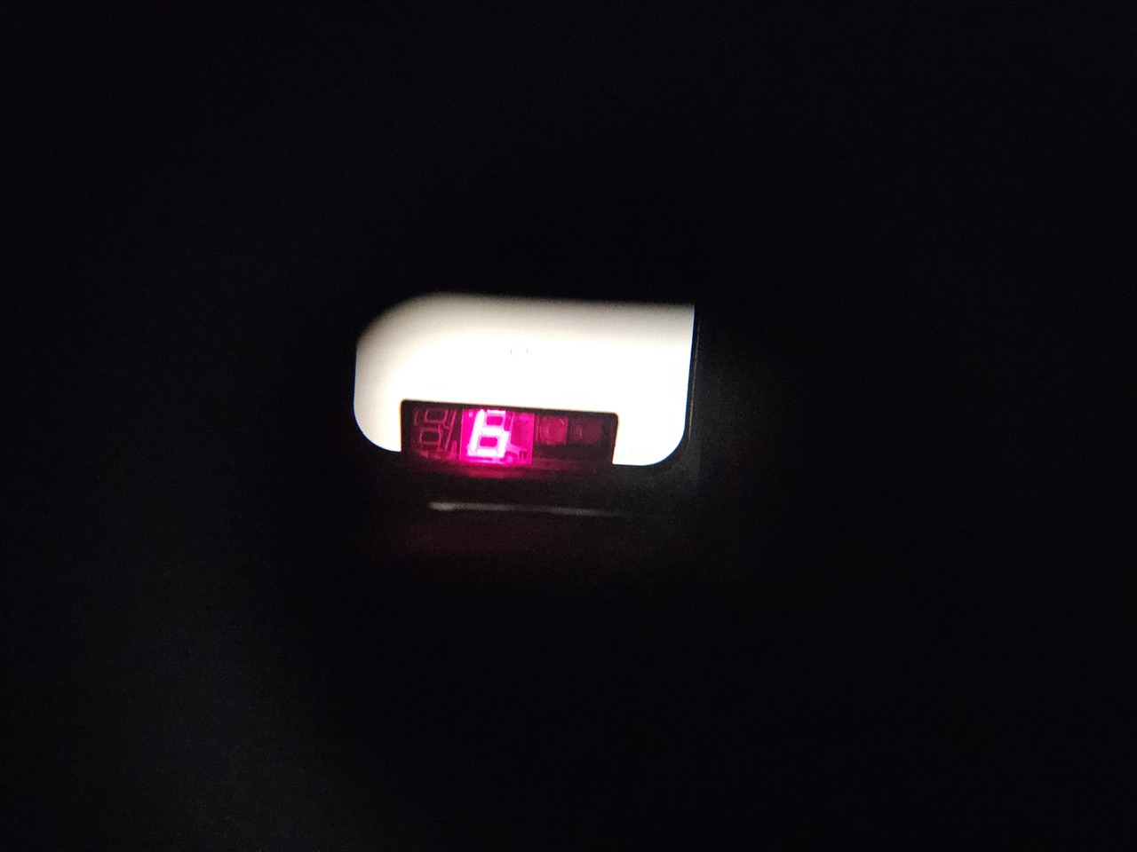

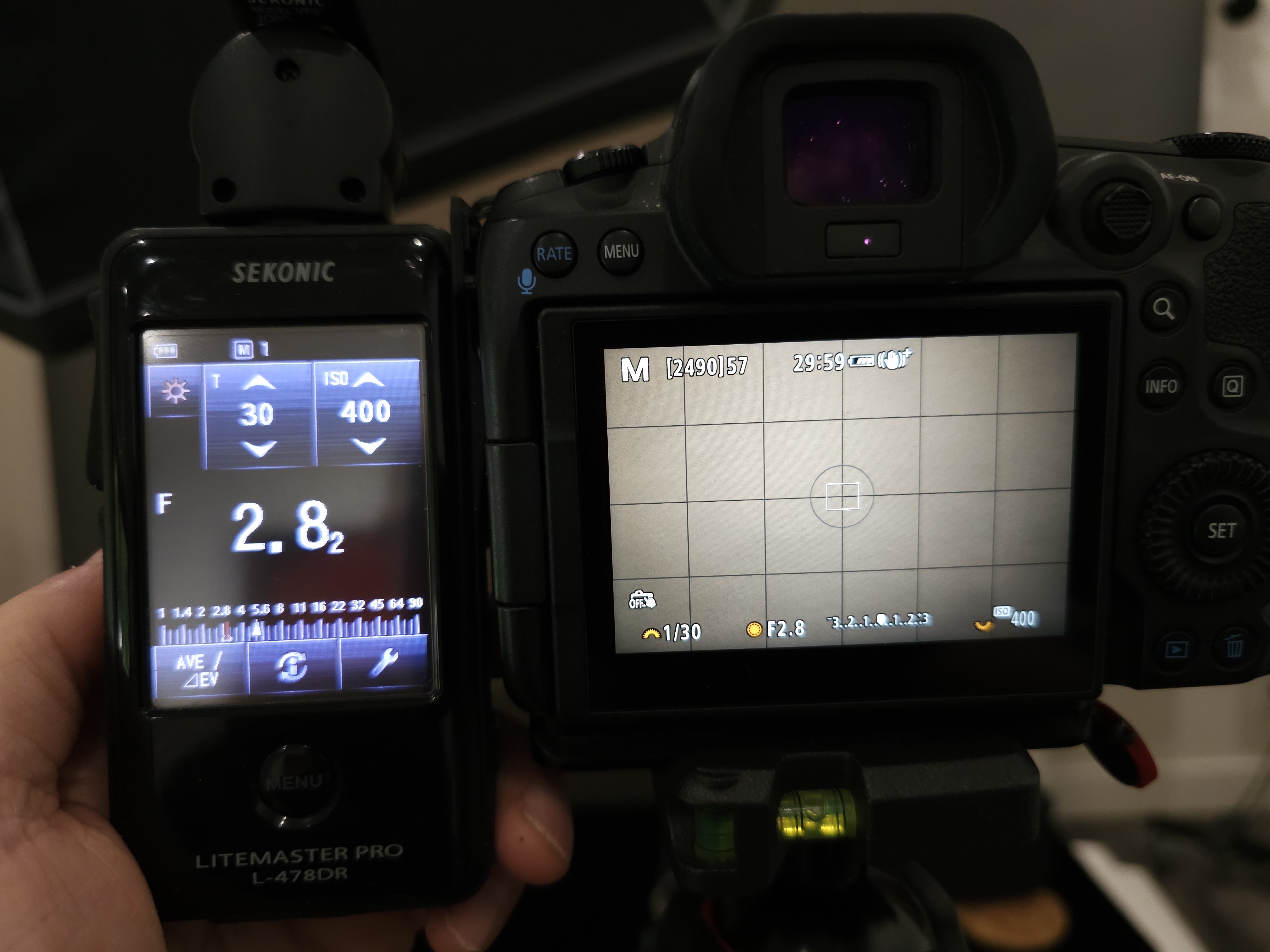

How much off is it?
Wow it’s only off by 1/3rd of a stop now. When I first checked It was 2/3 to 1 stop off. I wonder if using it got the conatcts or whatever working better. I set up a gray screen with constant light in my studio and the R5, sekonik and Pentax all agree. Outside at balck top and gray house in shade all give the 1/3 stop under. I’m attempting to use this for black and white film in a 4x5 and maybe even with my 6x6 Rolleiflex occasionally. I will be trying the various developing types like n1 -n1 so I think it needs to be reliable for me to learn anything from it. Here are the photos of all meters agreeing in the studio.
