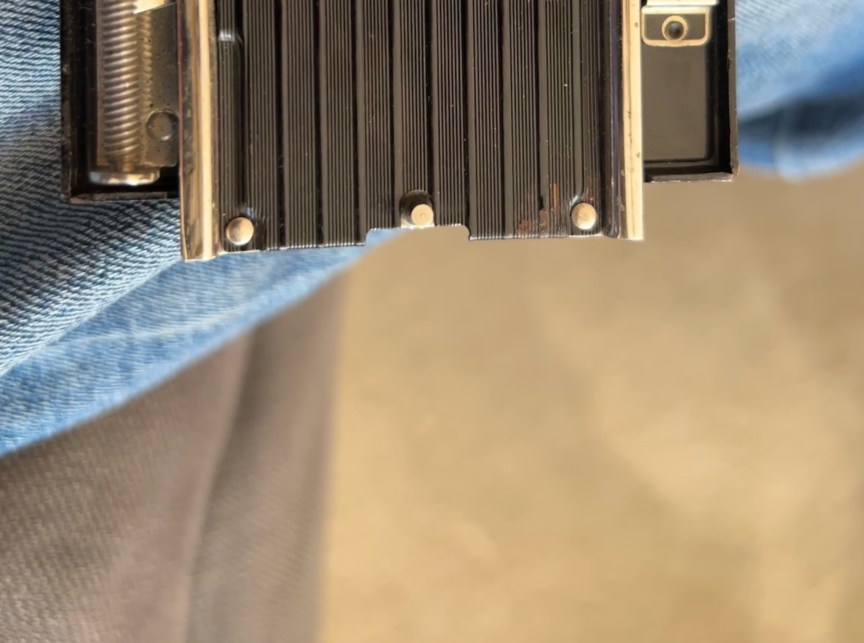

I’ve come on here to try and find out how to fix a broken No 1 Pocket Kodak that I’ve had for about three months and now the bed that the lens assembly slides on has somehow come loose. So the assembly moves with the bed and the bellows won’t extend fully. I’ve put a few rolls through it already (one still in there)

I think the front standard pulls out to the end of that bed (stops at the pin) and the camera is focused by moving the bed forward and back by the knurled knob on the side? There's a focus scale on the opposite side with a line on the bed to show distance - its travel is limited by a rivet in a slot behind the scale. Is it just coming out freely? You should still be able to lock focus using the lever behind the knurled knob.
A couple more photos might help.

I think that the focusing bed should be secured to the door with rivets, two of which are shown in your photo, there are probably another two at the rear. I suspect that the rivets have pulled loose from the door.
You will need to carefully peel the leathertte (?) from the door and see if there are holes in the metal where the rivets have pulled through the metal.
