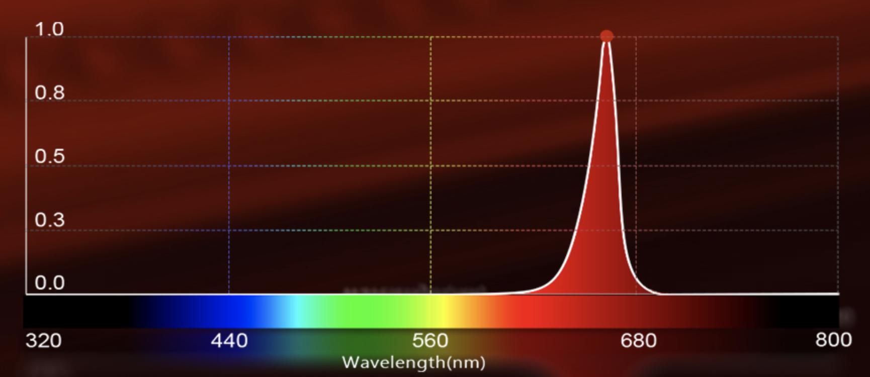

I'm using a 660nm LED strip mounted on the ceiling that's running at around 10w. Super bright and based on my testing as long as the paper is more than about 2ft away from the light it doesn't fog in any meaningful amount of time.

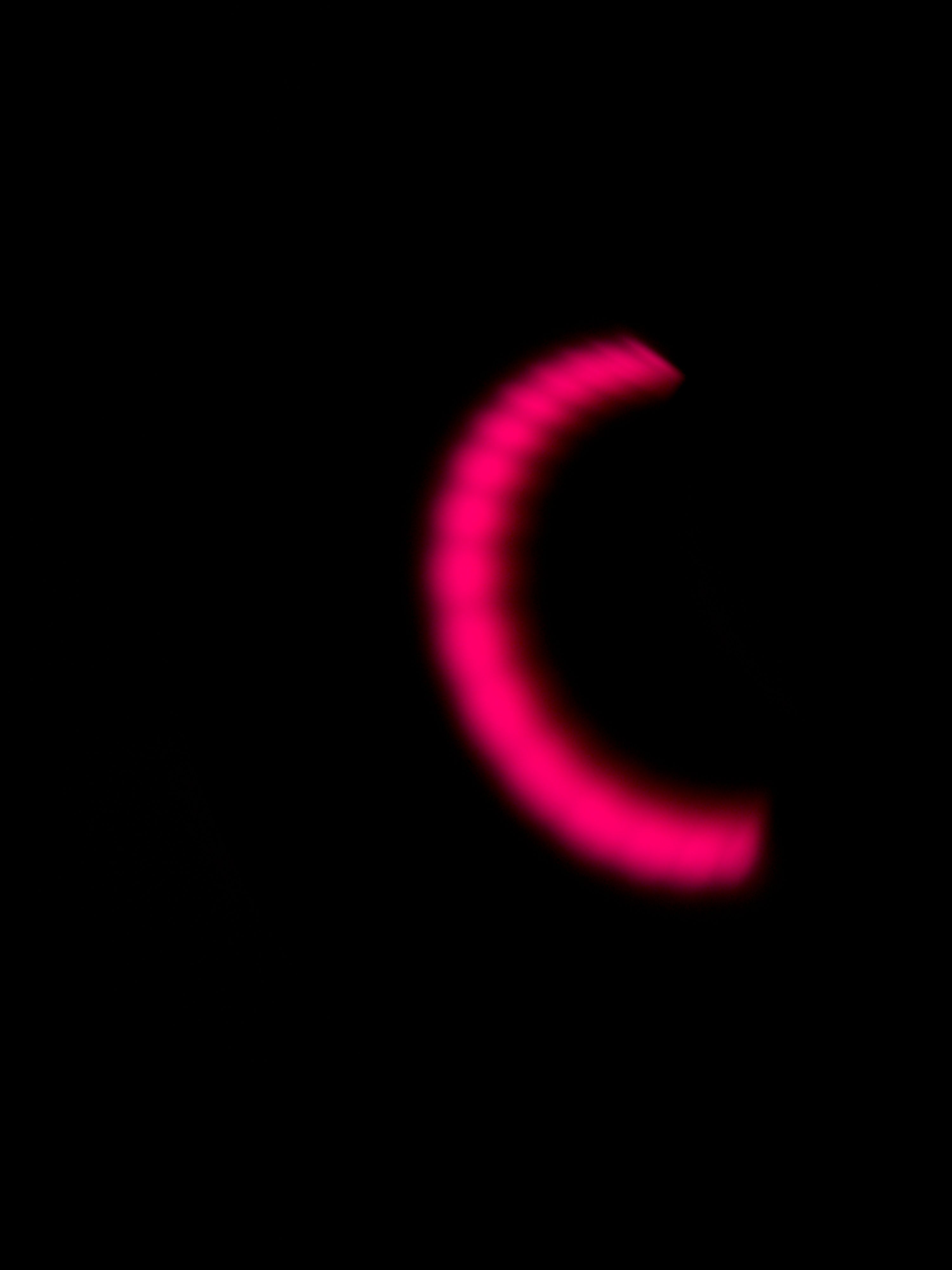

Using a CD (or DVD, don't remember) as a makeshift spectroscope, I could determine that, while the visual appearance was indeed "red", there was a small admixture of green light.
I just tried this and it's a pretty cool trick. Almost impossible to capture the results on camera but it's a pretty clean spectrum. By eye it extends slightly into the more orange-red that my previous 630nm light source was producing, but there's not a trace of visible green. IIRC the strip I bought was intended for horticultural use and uses Samsung LEDs

That looks pretty good!
Most red LEDs I've used gave a very distinct side-band emission in yellow-green part of the spectrum. Yours looks very clean, at least insofar as it's possible to judge from a photo.
Yeah, I had to use the manual exposure mode on my phone to get something that wasn't entirely blown out, but it seems pretty good. I'm gonna try doing the Kodak test now and see what that reveals, but I suspect given I haven't had any issues printing previously it'll be fine.

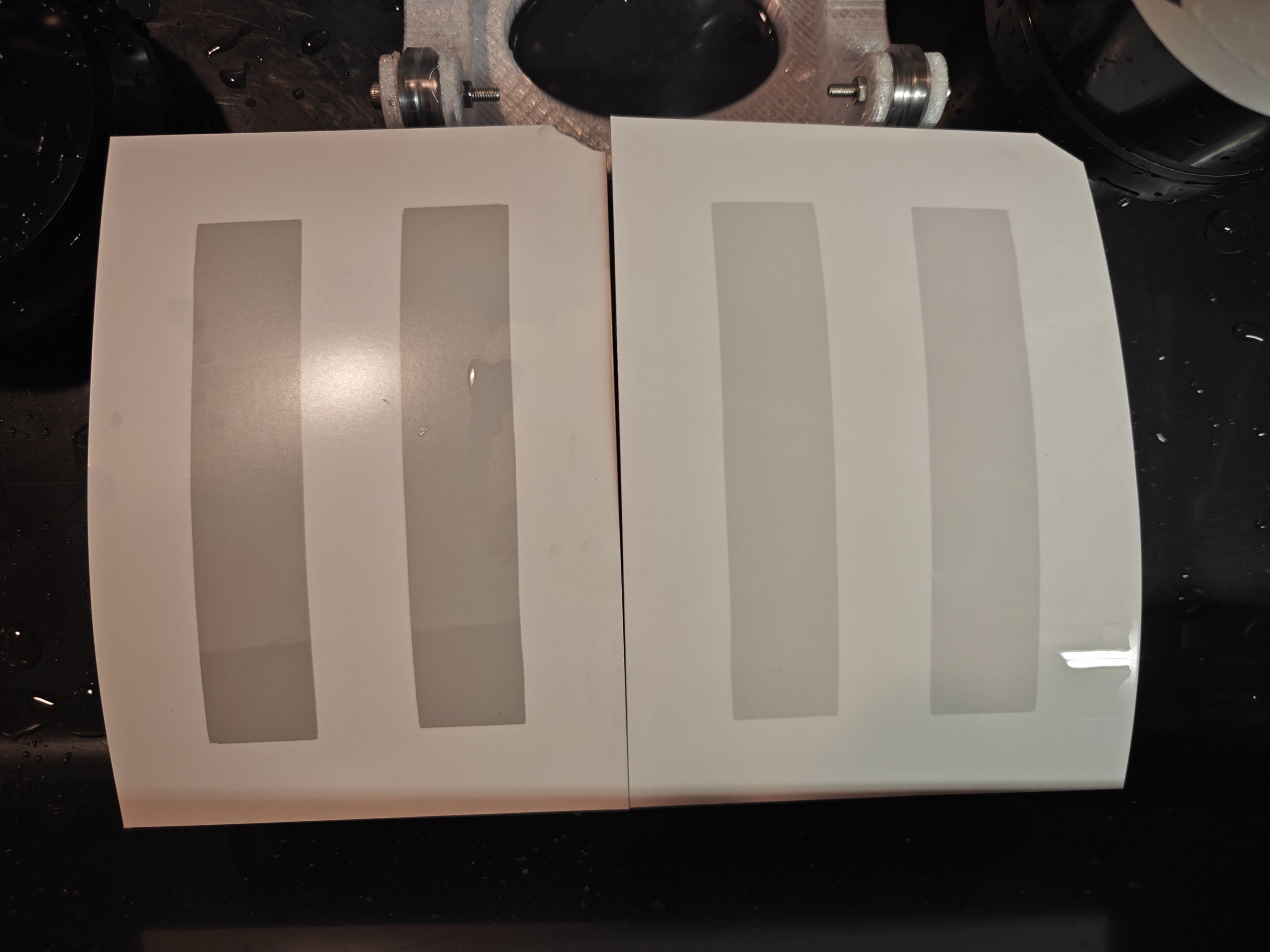

Alright, so my test results were a little surprising but not particularly problematic. I did two tests using fomaspeed variant 312.
Did a first test (1.5 second exposures) with the light where I've had it mounted (about 8ft away on the bottom of a joist with line of sight to my trays) and there's definitely a notable difference at 7 minutes. Given I'm usually into the fix within 3 minutes this wouldn't have given me any trouble. There's a tiny difference between 1 and 3 minutes but it's barely noticeable by eye and I don't think the camera picks it up.
I remounted the light bar turned 90 degrees on the side of the joist and did a second test (used a 1 second exposure to try and make any changes more obvious) and there's no visible difference in density across the strips. Even in this configuration it's still a far brighter safelight than I've used previously which is pretty convenient.

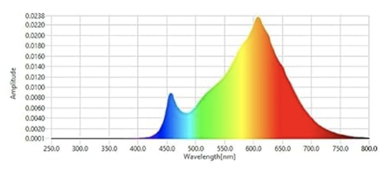

I'm still on the lookout for some cheap, small, red LED strip kind of light - have been reading quite a few times that some people apparently do well with christmas-type lighting, as readily available on eBay, amazon, etc. -
looking at the technical data sheets of those lights (if they are provided at all) I get the impression that basically none of them are strictly red-spectrum only, but they all are "predominantly red", like this:
..I suppose this is not suitable at all, right?
Basically, the only LED lights that are strictly red (around 650nm usually) are the ones some indoor gardeners are using
(yet they are quite expensive, and also way brighter / powerful than you'd ever need it in a darkroom : )
That's the spectrum for a warm white LED. You may be looking at an ad for LED products that are offered in various colors and the spectral plot you found was for a warm white type instead of the red variant you're interested in.
