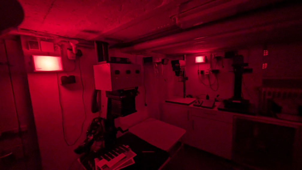

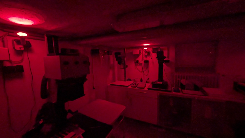

Hello @Tina Kino, sorry for being late, had to postpone my session to today. Her the pictures of my darkroom setup illuminated by SL-1 and the Adox safelight with clip lamps that are directed to the ceiling.
The SL-1 is bit brighter, but at the end both are very convenient for working.
Thanks a lot. What you see is a rock solid Homrich 4x5 color enlarger to the left, in the middle a Magnifax 4 with a Heiland splitgrade system and on the right a Philips PCS 2000 RGB enlarger that I use for color negatives and slides.

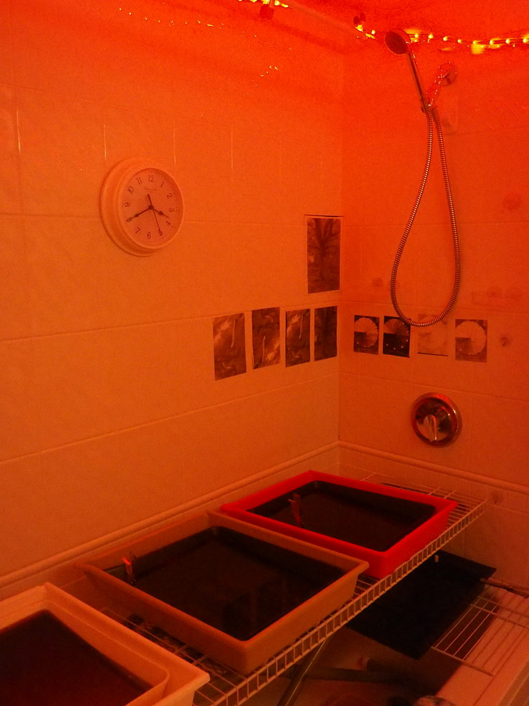

The 16 foot rope light/Christmas light/safelight in my temporary darkroom/bathroom that passes the Kodak safelight test with the Ilford and (old Agfa) and Oriental RC papers I use:
Some pretty murky chemicals you got there, Matt! What process are you doing, out of curiosity?
I nest smaller trays inside larger ones to help minimize splashes - particularly the fixer - and those inner trays happen to be black :smile:.
Ethol LPD developer, either Ilfostop or just citric acid, and either Ilford Rapid Fixer or Hypam fixer right now, although I've used lots of the Kodak rapid Fixer without hardener added in the past.
The lower tray is a print washing tray which drains into a further print washing tray on the bottom (which is hard to see in that photo) which itself drains into the tub.
As I use RC paper, I'm able to wash them 1-2 minutes in each wash tray - bottom one first, then top one next - which is enough for thorough washing.

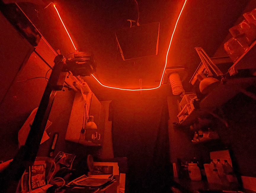

This is what I have been using for the past couple of months. I have a proper darkroom safelight, but this one is safer for the xray film that I use... Influenced by a darkroom group that I belong to (along with Matt!). I was quite impressed with the brightness level. By the way, I tested this rope light via Kodak safelight test (thanks @MattKing!).
