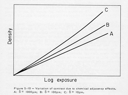

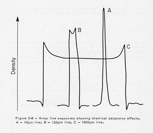

The qualitative examples shown in your references mean absolutely nothing unless suplemented by hard data.
I will post again here, the two pertient graphs from Mike Kriss' treatment of the subject. The entire paper is 60 pages long and mostly math.
Basically, the left chart shows the traces from edges of 10, 100 and 1000 micron lines, and the right chart shows the contrasts taken from a step wedge of each of these sets of lines. You will note therefore that contrast is a function of magnification as much as sharpness is.
This means that the greater the magnification, the higher the contrast, but this is offset by the magnification itself. At equal magnification, the increased contrast increases apparent sharpness.
This crossover between sharpness and contrast will confuse you if you don't have hard data, but of course pictures are more important than data. But it still proves nothing, it only proves what we percieve, not what is. That is why you need both in a side-by-side comparison.
To get more data, it is useful to do the line exposure by visible light and X-ray both to aid in determining actual sharpness and sharpness degraded by turbidity and inter-reflections from the base. This latter experiment is critical in the design of any film system.
PE
