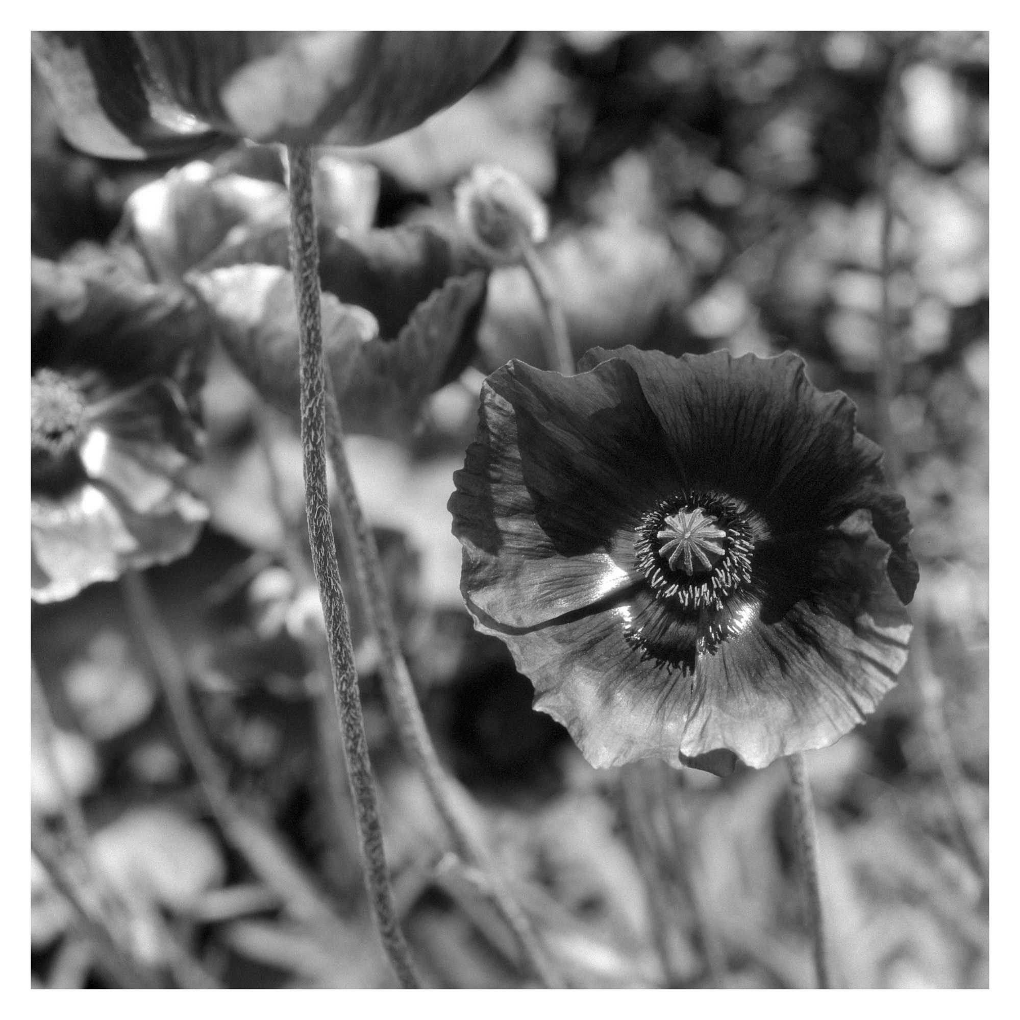

A sample of the new Foma Ortho: 120mm macro, Microphen stock
Red or at least a kind of. The photo has been taken at noon meaning very harsh light conditions.
Thanks. So the much lighter portion at the bottom is in fact the same colour as the top which looks much darker but it is the harsh light of the sun which strikes the lower half more that is creating this difference? On a day with no sun or if the whole flower was in shade then both halves would look the same?
pentaxuser
I guess this would be the case
Thanks Every picture I see of this film seems to suggest it may be more ortho than any others and render reds as more black Based on the Foma test pictures it also has quite a greater effect on yellows as well
Can I ask what speed you used this film at? Was it 400 or a lower speed?
Thanks again
pentaxuser
I’ve exposed it @ 200 combined with reduction of development time taking high contrast scenery into account
