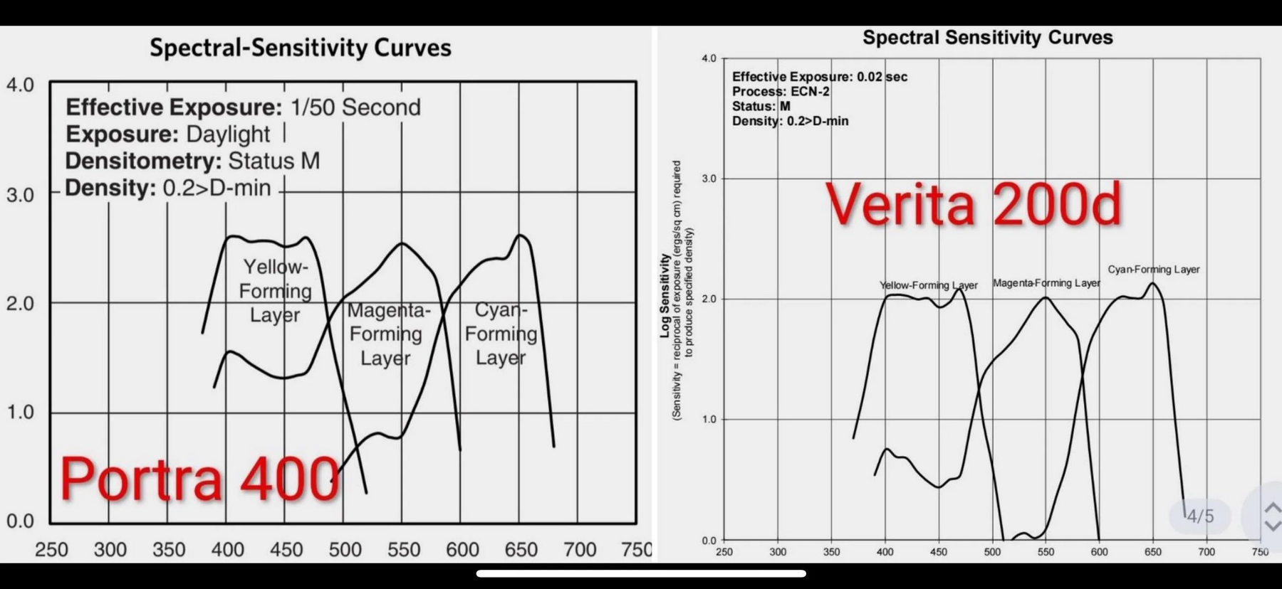

Well, what do I know. But there certainly has been rumors that there is a new Kodak cine stock based on an existing still film stock from insiders in cinematography circles over the past two years. Look at the second post here: https://cinematography.com/index.php?/forums/topic/102017-new-mystery-filmstock-from-kodak/
But that doesn't make any sense like I said before. He alleges it's a still film, and it's ECN-2. Which ECN-2 process still films has Kodak made, ever?
It's anyone's guess what he heard/read back then and how he understood/interpreted it.
Also, this is what he posted on the currently released film a few days ago:
To me it looks like Vision 3 200T honestly, I haven't found anything yet to make me say "oh that's radically new". The fall-off in the blacks is nearly identical to 200T. This doesn't look anything like the pre-release stuff from 2 years ago, which had a VERY distinct look and was WAY grainer. So IDK what happened.
A few posts up he says:
I'm pretty sure it's reformulated Portra 400.
So which is it...and whatever it is, it's apparently not what he was talking about 2 years ago.
Looks to me he's like guessing, feeding the rumor mill. People pick it up, repeat it, at first with a tentative "IDK but this guy here..." and before we know it, it's gospel.
well, let's be honest: if you take a portra and change the emulsion, dyes, couplers, formulation, edge markings, canister, logo you basically have a portra that becomes an ecn2 film. Or even a bicycle, with a few more tweaks.
And, if we are really honest, maybe if you take Portra, change nothing then process it in ECN-2 and you (just what it says on the tin) get pictures with a cross? I mean, that wouldn't be THAT different to taking V3 5203, changing nothing and processing it in C-41 (you get nice enough pictures with a cross).
I mean, I would at least try processing Portra 400 in ECN-2 before having a strong opinion on what this new Verita is or isn't.
I thought "motion picture film" was reversal film, not negative film.
i never tried crossprocessing portra, but that was a joke.
i can see why, in the current legal dispute about film names, Eastman would rename portra but then why create a new name and not simply use their brand new shiny Ektacolor (that we all know is our beloved Portra)?
It's an interesting experiment alright. I doubt it will yield Verita's curves, though. Looking at the, they're a little too wonky to be explained by a simple x-process. But who knows? I don't have any fresh Portra 400 to try it on.

There is some speculation on reddit that it's basically Portra 400. I will follow with interest.
Indeed it is. I am surprised just how similar the overall sensitivity of the layers are, Note the ~0.5D difference between C41 and ECN2 making a drop in effective speed apparent. The real difference, as one might expect seeing as there is a different CD at play, is the cross overs in the h&d curves. different dyes are being formed after all.
