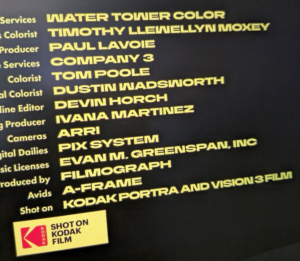

Euphoria Season 3 ep 1, now out, mentions being shot on Vision and Portra in the end credits.
