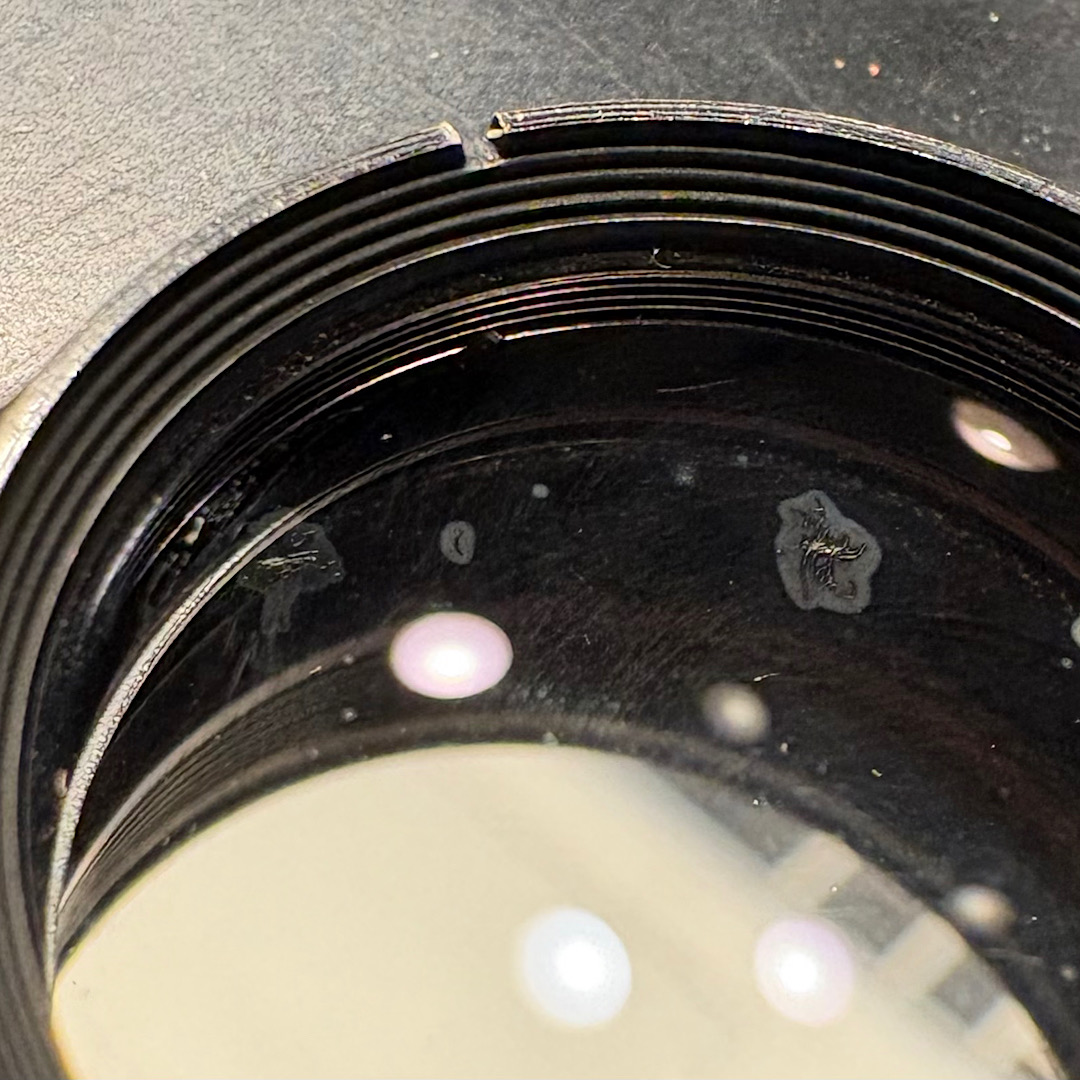

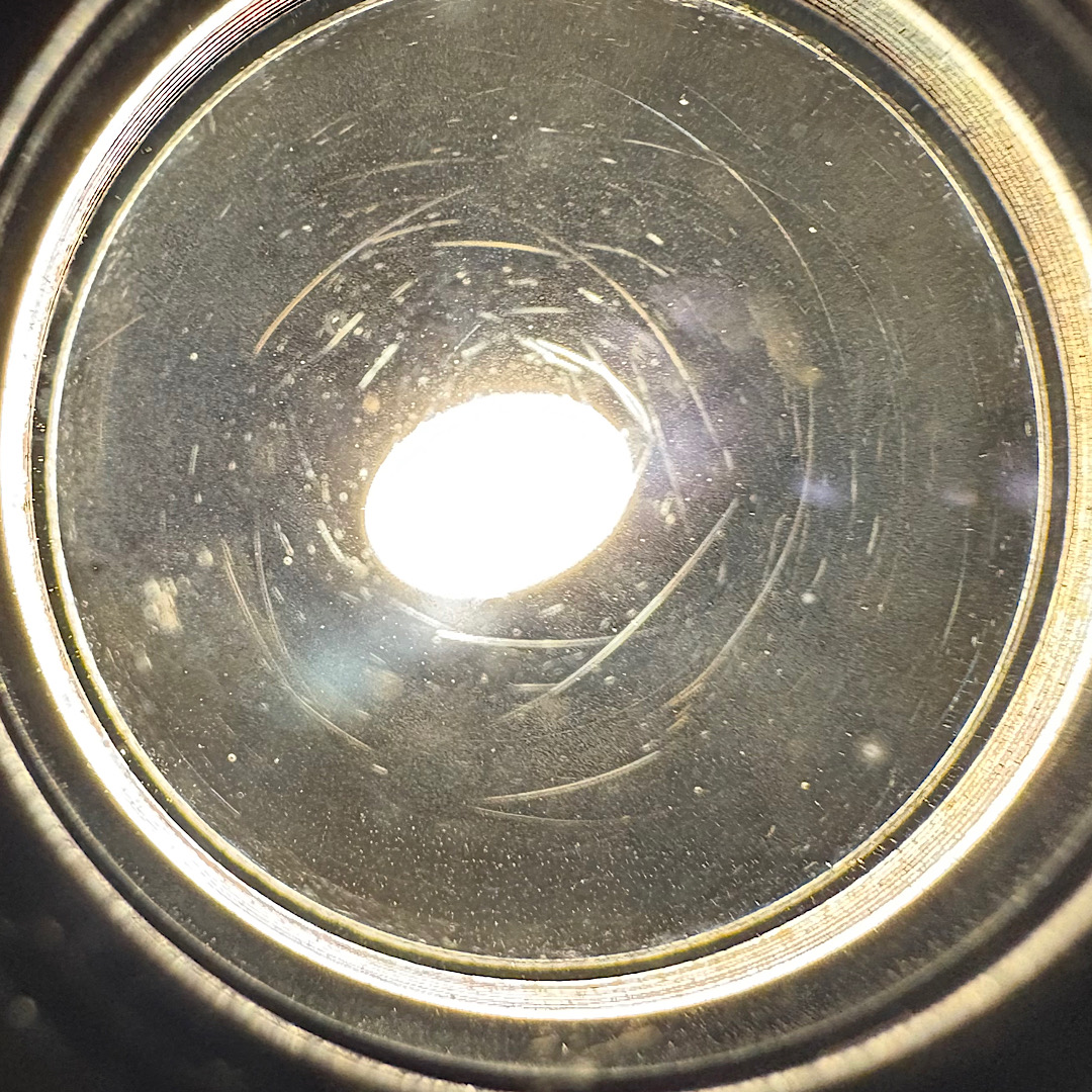

Now my main concern is the lens elements. Without even removing the lens board from the camera I can see that there are a few large specs inside the lens. Once I removed the lens board to inspect the back side of the lens, I could see lots of small particles of dust inside the lens as well. Additionally there appears to be something that I fear is fungus inside, closer to the rear element. (I will attach photos if I can figure out how). On top of that, there appears to be lots of fine, (and hopefully light) circular scratches on the front element. It looks like someone used their shirt to try to wipe the lens.
I guess the main question is this: Is this lens worth sending out for a CLA? Basically, is the value of the lens not worth what it might cost to get it serviced, especially considering the potential fungus? Or should I just shop for a different lens from ebay or some reputable online source?

You said your negatives are looking good. That's what counts.
Scratches will lower contrast and induce flare, but these issues can be minimized by shading the lens, wither with your hand or a gobo. Unfortunately, these cameras do not accept compendium hoods.
If the fungus is on the surface of the cells, you can easily clean it off. Just unscrew the cells from the shutter. If you are reasonably careful and can handle small precision tools, you can try and open the cells to get to the elements themselves. It will be good training to keep your lenses clean. This is an already damaged, inexpensive lens. There's nothing to be lost if you mess up.
The lens has an image circle of 161mm at f/16, so there isn't much room for movements. If your camera has a Graflok style back, you might consider a roll film holder and use it learn movements. You will need to be more careful while focusing, composing and determining near and far focusing points, but that is a good thing anyway. Or, you can let some areas go black and learn to compose within the illuminated area.
Use the lens until you're sure your images are suffering because of lack of coverage, lack of contrast or anything else.

Regarding servicing the shutter and lens… forget the value proposition of the lens/shutter “value” vs cost of another replacement and focus on the value proposition of how much a properly operating shutter will support your photography. Buying another old lens/shutter is a crapshoot; professional servicing of what you have will assure continued reliability for a long time.

As Mr Kumar suggested, remove the lens cells from the shutter, they just unscrew, and clean them. That does not involve taking the lens elements apart. Then take some shots! One tool I find invaluable for my many old leaf shutters is a shutter speed tester. I make a chart for each shutter with actual speeds as opposed to the marked ones. If the tested speeds are consistent I leave them alone. If not, I have the shutter CLA’d.
You will need a shutter speed tester off ebay. And you need to clean the glass wherever your skill allows you to gain access. Judging by the front element scratches, the shutter itself needs a CLA, and find a new lens to go in it. As for any replacement, f you choose that route, simply find a used lens identical. One thing I can assuredly tell you, is that any shutter will need CLA, or you will be in for nothing but heartache. You'll never be able to pin down proper exposure.
I don't follow how the mild cleaning marks say anything about the condition of the shutter. There's no relation between these things whatsoever. The cleaning marks, btw, look very mild for a lens this age. They wouldn't bother me in the least; they can simply be ignored. I'd just clean up those two bits of fungus.
I also don't see why there would be a need to purchase a shutter tester. In a pinch, a smartphone with its sound recording can be used to verify shutter timings to verify how far they're off. Yes, that's right: not verify if they are off, because they are for sure! Just how far they are off, so this can be kept in mind in the field.

I figured out that I can easily unscrew the front...cell?...of the lens. Once I did that, I was able to open up the shutter blades and access the surface of glass where the fungus was growing. I guess that would be the rear cell? The fungus was on the inner surface of the rear element of the lens...that is to say, the glass that sits directly behind the shutter blades. I zapped it with the UV conservation light at work today and am about to use some lens cleaner and a lens cloth to remove the residue of the fungus...which should be dead by now.
