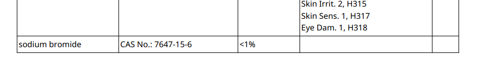

By the way, the MSDS for Part A of the developer includes this:
The developer that comes in the 5L kit we’re discussing does NOT have bromide in it.

Editing: Looks like they did finally post the SDS for our kit and it does show that. That’s good
But all that does is make it match the developer replenisher exactly then.
I.e. there is no trace of actual starter in our kit developer. It’s just replenisher.
yeah actually if you read the top of the SDS for our kit, they literally call it Developer Replenisher. They’re not giving us starter.
