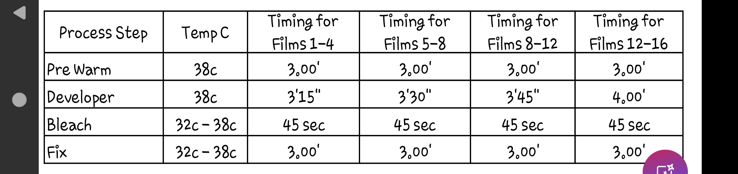

To OP: did you increase the color developer time after several rolls to compensate? For example: Bellini C41 kit, 1L work solution can be reused for up to 16 rolls of 135 film. And in my experience, it is true.

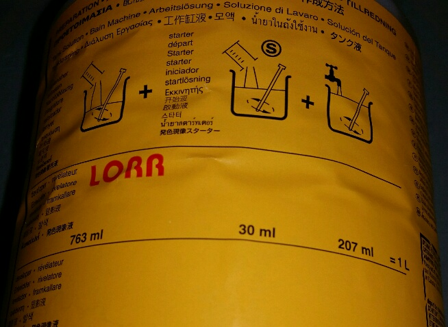

Above is the label from my bottle of starter
763ml of replenisher, 30ml of starter and 207 ml of water prepares fresh working developer.
I have not mixed the Kodak 5L chemistry yet, was planning to do it this week.
Yes I did! My test today came out actually consistent with fresh developer. I’m thinking the major color shift came from shooting at blue hour. But I figured I’d still ask the question because I’m curious how I can use the replenisher. And it sounds like I can just start replenishing my current developer.
