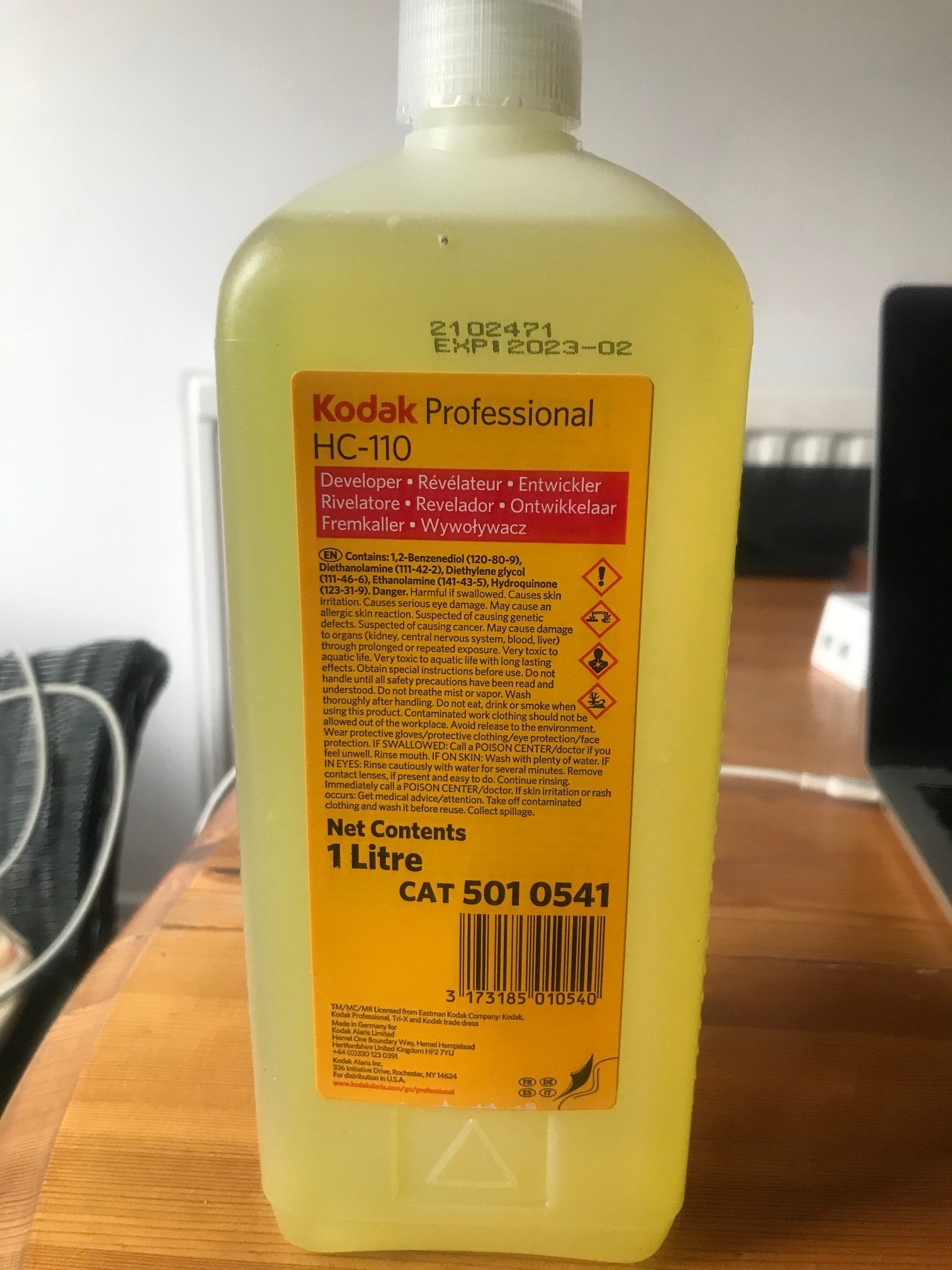

That is what my bottle looks like (USA). I bought in 2018, supposedly expired in July 2020. So far it is still good (last used in July).
Well I got my new bottle today and it expires in 2023. So either Kodak is still making this stuff somewhere in the UK/EU or that the new formula is only targeted in the US due to their environment regulations, just like how Velvia 100 is discontinued.

Is that stuff syrupy and viscous, or thin and watery? If the latter, it's the new formula in the old style bottle.

It's the syrup stuff. If you look at the production number it's like 10,000 more.

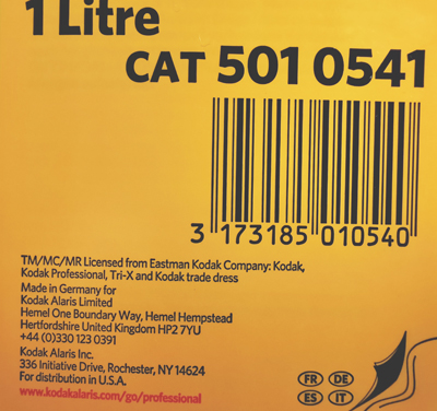

In the UK , I received my bottle of 501 05141, 2016 msds today.
It is marked "Made in Germany for Kodak Alaris" "Expiry 2023"
This link from 2019 notes that "Today Kodak's cash cow developers Xtol and HC-110 [were] produced by Tetenal":
https://petapixel.com/2019/02/01/a-closer-look-at-tetenal-a-photo-firm-thats-too-important-to-fail/
Here Matt notes production of many Kodak Chemicals [but not Ilford] was moved to the US after the Tetenal bankruptcy:
https://www.photrio.com/forum/threads/would-we-agree-about-xtol.183124/page-3#post-2406311
So it seems that [but is not positively proven] that the Expiry 2023 product still available in the UK may be the last of the traditional HC-110.
The Ilford chemicals appear to be made by New Tetenal.
I put a few drops from my new bottle on a piece of film emulsion for 20 minutes, there was no detectable development, the 2016 msds product appears water free.

To add to the potential confusion, note the words on that label: "For distribution in U.S.A."
