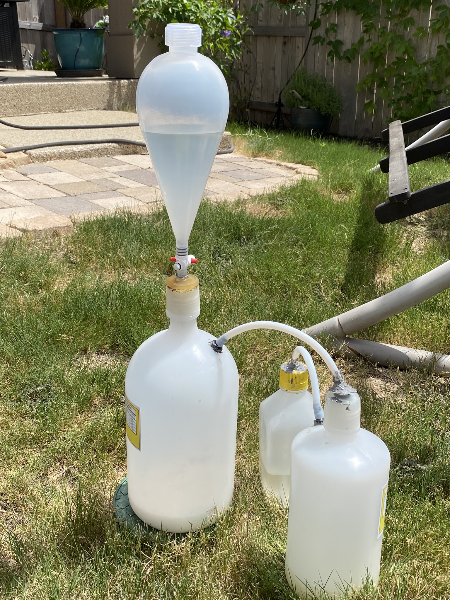

Sulfuric acid 33% slowly added to sodium sulfite (first bottle) in a closed system. Bubble it through a 99+% diethanolamine (2nd bottle). Third bottle is a scrubber that captures any overflow SO2 so there’s minimal release. Takes a few hours on a Saturday afternoon the grad cylinder shows the final result

Sulfuric acid 33% slowly added to sodium sulfite (first bottle) in a closed system. Bubble it through a 99+% diethanolamine (2nd bottle). Third bottle is a scrubber that captures any overflow SO2 so there’s minimal release. Takes a few hours on a Saturday afternoon the grad cylinder shows the final result View attachment 335044View attachment 335045
Awesome!

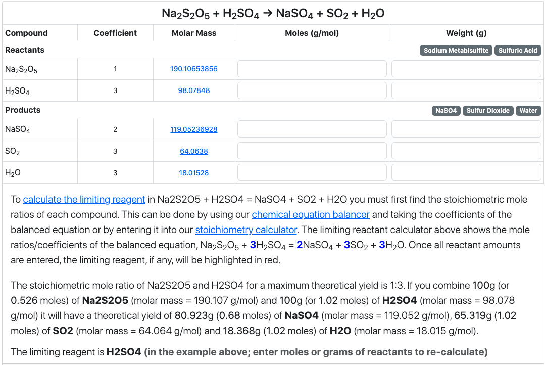

I think the hydration factor of the DEA adduct can in principle be neglected. Firstly, little water is released to significantly affect the properties of the adduct obtained, and secondly, the final composition of HC-110 contains ethylene glycol and diethylene glycol, which themselves are very good dryers. On this basis, it seems to me, this factor is negligible.
p.s. However, no one prevents to pass the resulting SO2 through an additional vessel with concentrated H2SO4.

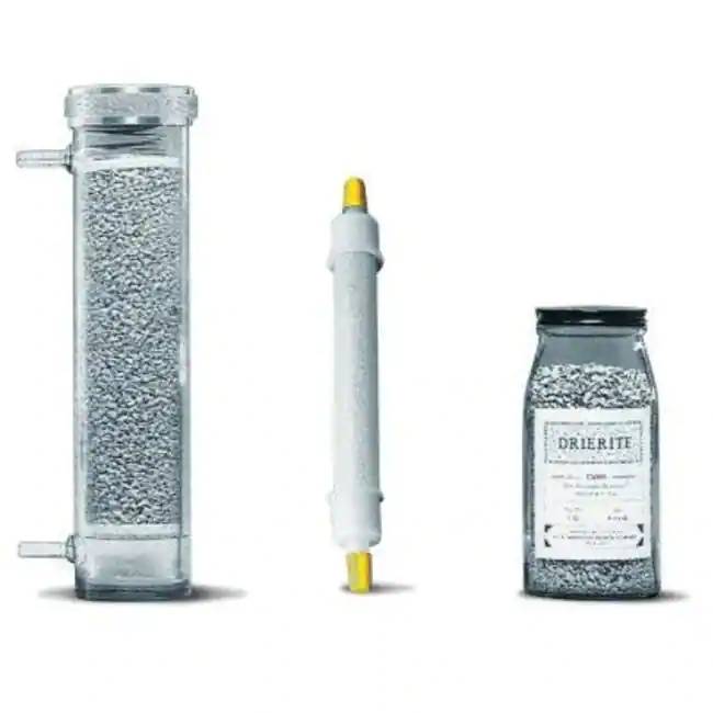

Granular anhydrous calcium sulfate is a good drying agent, and I doubt if it would react with SO2. It is the desiccant in the product product known as Drierite. There is an indicating form of Drierite that can be obtained that is blue when active and red when exhausted. If Drierite becomes exhausted it can be regenerated by spreading it out on a cookie sheet and heating it for an hour at 425F (Reference: https://secure.drierite.com/catalog3/page19b.cfm). I don't think it would be necessary to use the indicating form if one simply regenerated the anhydrous calcium sulfate prior to each use.
I think the best way to use a desiccant like Drierite would be to pack it into a column. A couple of examples are shown in the attached image. You can buy columns packed with Drierite, but I'm sure that one could make a DIY column without too much trouble.
You might be able to make granular anhydrous calcium sulfate, starting with the dihydrate of calcium sulfate in powdered form. I won't go into that in detail right now, partly because I don't know the specifics. However, I think a basic process might be to make the a plaster, let it harden/dry, break it up into granules, sift the granules (to get rid of the powder), and heat the granules to convert them anhydrous calcium sulfate.
Gypsum is one form of calcium sulfate. It is the main ingredient in sheetrock, although sheetrock contains other additives as well. However, I suspect that the other additives would probably not interfere with a DIY desiccant made from the core of some discarded sheetrock using a process similar to the one I outlined above. Of course I am somewhat guessing here.
I have focused on calcium sulfate disiccant here. There are other desiccants as well.
A cold trap is another possibility that might work as a substitute for a desiccant column or as an adjunct to a desiccant column (https://en.wikipedia.org/wiki/Cold_trap). Note: an earlier form of this post discussed a cold finger instead of a cold trap. A cold trap is what should be considered, not a cold finger. The two devices are closely related. One might think of a cold finger as an inverted cold trap.

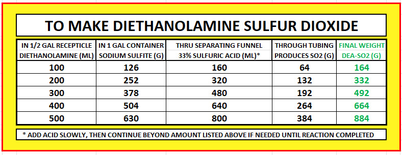

I manufacture the DESO by weight so I can tell you all how much so2 combines with the de.
The water bearing hc110 I am referring to is the current Kodak USA formulation with potassium sulfite and water. It is very thin and watery.
I don’t know how to remove the water vapor produced by this process. I suppose one could purify the so2 or just buy a container of so2 and run ot directly through the de.

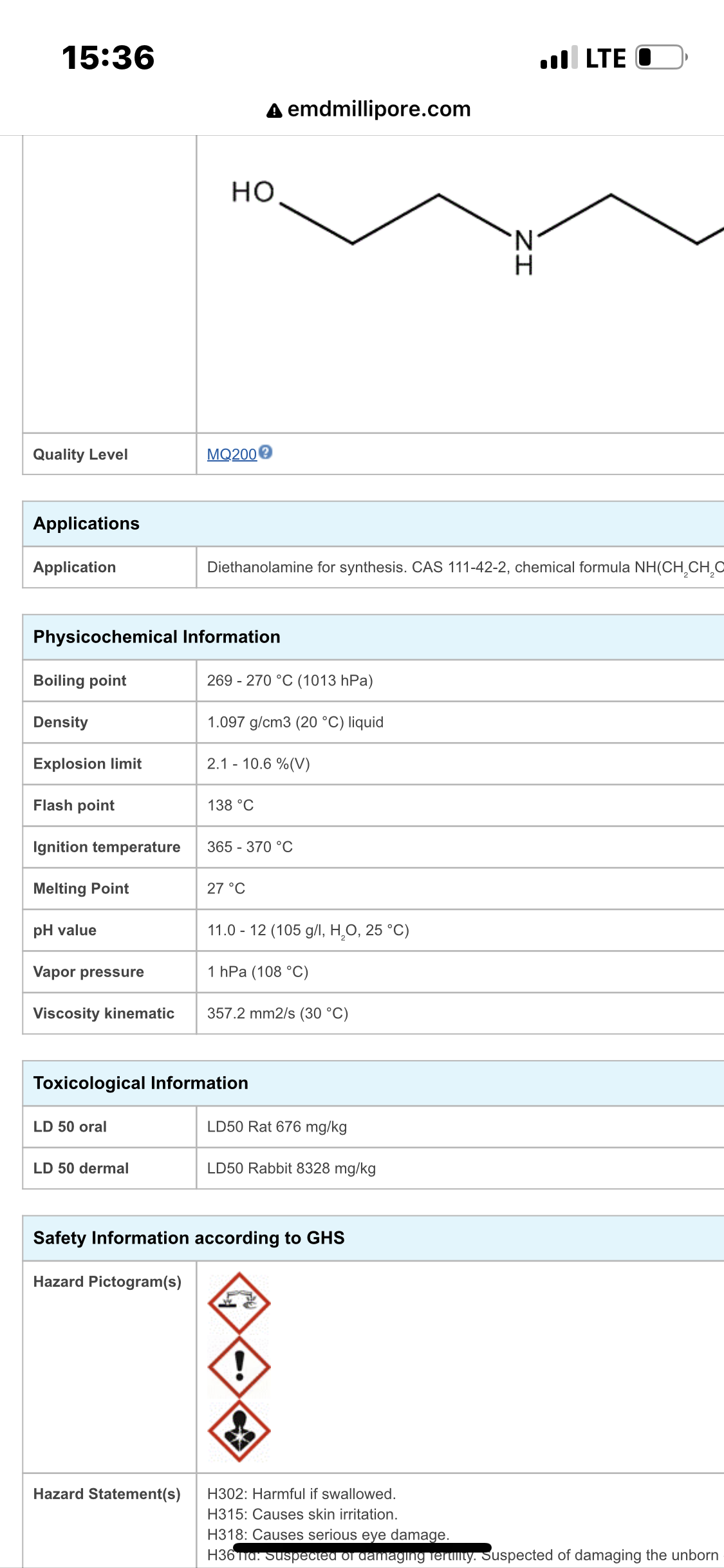

Here is what I found on the pH of 98+% di- and Tri-ethanolamine. It looks like diethanolamine has a higher ph (11-12) than triethanolamine (11) but this may shift as one dilutes it for developing use

Here is my worksheet to make DESO. It goes with the photo of the 3 bottles I use to generate so2 and capture it through the DE.

Here is my worksheet to make DESO. It goes with the photo of the 3 bottles I use to generate so2 and capture it through the DE. View attachment 335557

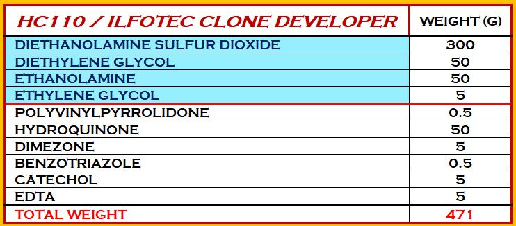

Here is my worksheet to compile the "final product". All the ingredients are present in the original Kodak patents. The PVP was clearly cited in the Kodak patent as a good antifoggant even though it not included in the kodak MSDS. I added a bit more Catechol just because I wanted to. I opted to use Benzotriazole instead of Pot Bromide as I have found that BZT is a little bit better at suppressing fog than Bromide when Phenidone derivatives are used (some support in the literature for this too). I have a bottle I made last spring that has been about 1/8 full with minimal discoloration and still effective at making a very nice set of negatives on Ilford Ortho, FP4+ and HP5+. If I can get a good pic of the concentrate I will send it up.
Excellent info. Thanks.

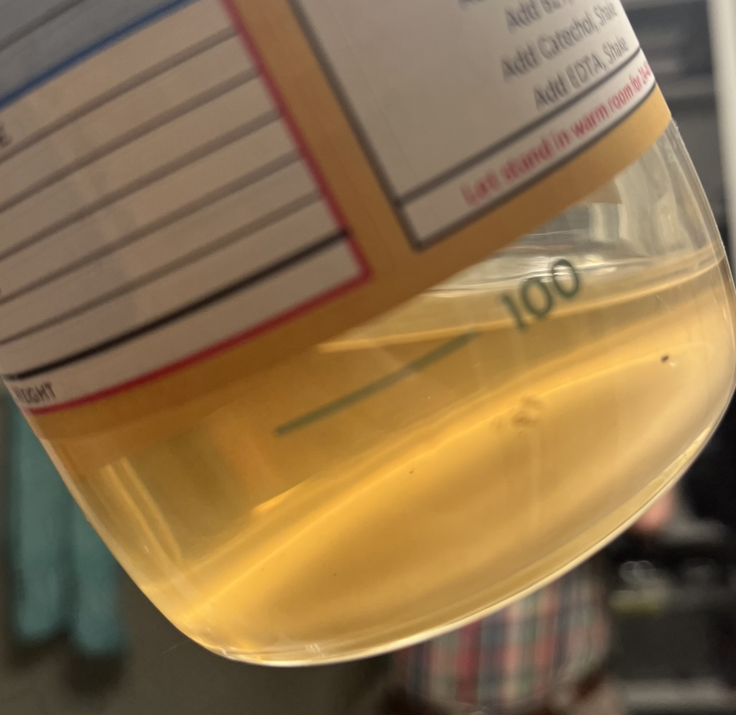

Here is the year-old concentrate I made.
