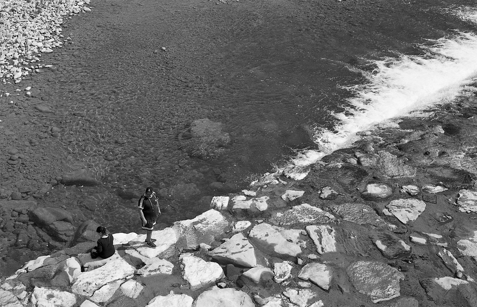

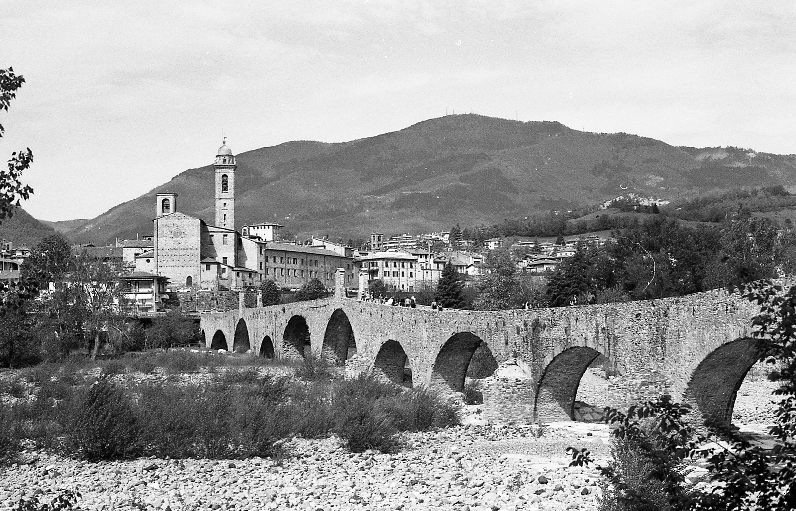

scan with epson V600, (2400dpi + scaling for posting: 1600X1029 jpg 1.4M) with active unsharp mask. No intervention in post (only slightly straightened).
i am very very satisfied. The camera is good, my Soviet lenses are perhaps not the best but I like them
Looks good.

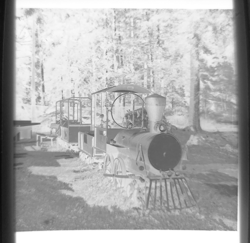

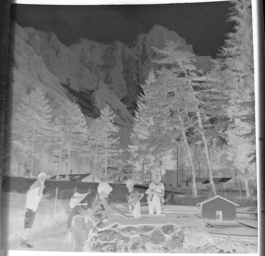

Mi sembra sovraesposto e sottosviluppato.
also for me it seems overexposed.
underdeveloped it doesn't seem to me.
If so, it means that I unknowingly used the "William Mortensen technique"🤣😃

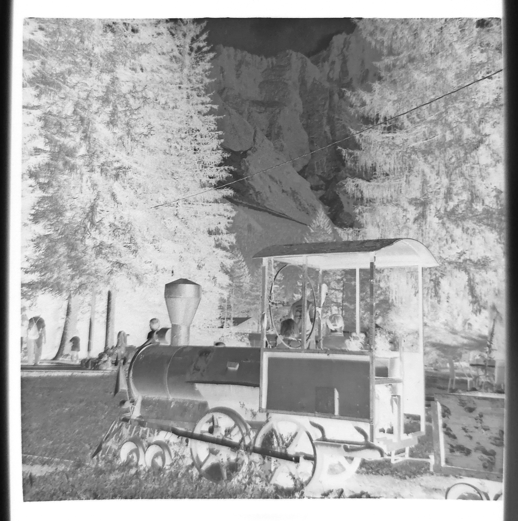

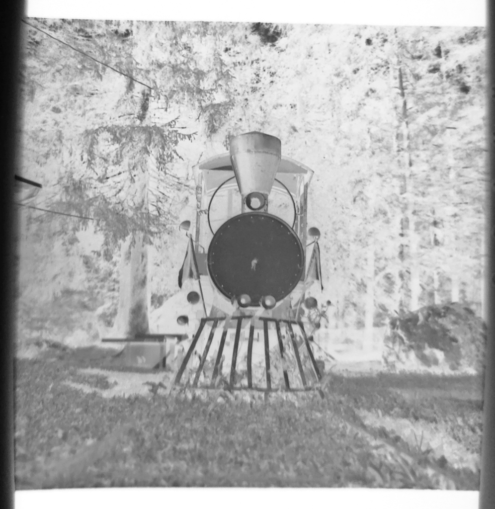

It is always tricky to evaluate a digital photo of a negative because the contrast is variable. The negs initially looked a bit flat to me, but when I copied them, inverted to positive, then increased the contrast they looked good.
We have to set exposure and development (=contrast) to suit our process. Those negatives would have suited my darkroom process.
I'm not a great printer, let's say I get along. In my experience they are negatives not difficult to print even with my old equipment.

Fomapan 200 @ 200 / 120 format / FX-55 .
The film is drying 😀 9 min. 30 sec. / 20 °C (Flexaret VI).
Soon I will do the usual illuminated film photography; then scan.
Again I think the FX-55 worked very well. Soon I should develop an Ilford Ortho Plus 80, but I don't have the slightest idea of the development time to start from. I think it's harmful to exceed 6 minutes and 30 seconds
I thought so, but the scans look good. And the negatives look fairly easy to enlarge.
Yes, certainly. I think those negatives will print like a breeze. The combination of overexposure and underdevelopment isn't always detrimental. Indeed, some people swear by it!
