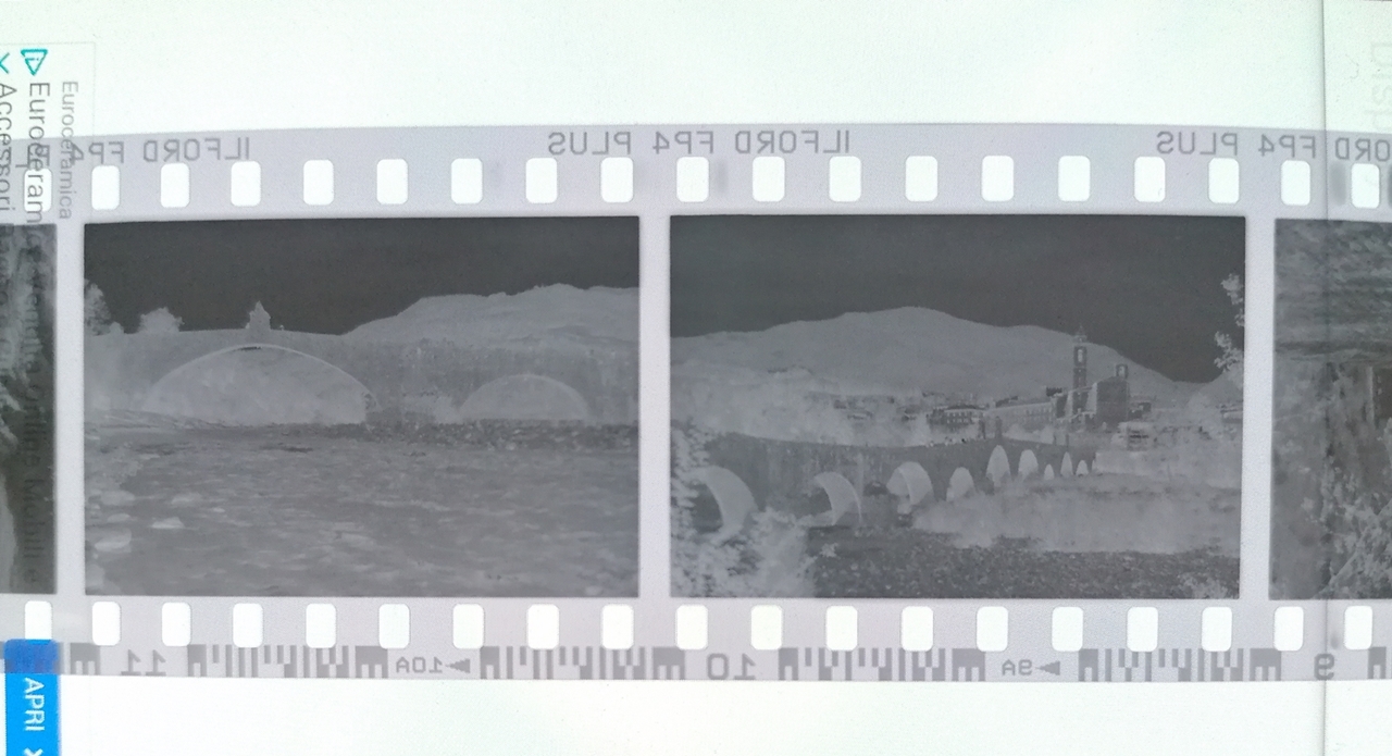

The roll is hung out to dry.
36 shots (trivial) excellently developed. Perhaps overexposed (1/2 stop ?), but I'm not a great expert on wet negatives. If they were overexposed, Crawley's theory might be valid (sensitivity gain) because I exposed the FP4 as regularly do the Contax AX (reflected light), for box speed (125).
When they are dry I insert the photo of the negative on a light source. Photrio experts will be able to evaluate. I developed for 7 minutes 30 seconds at 20°C.
It has been fun and educational to make and use this development; not as complicated as it seems.

fp4
Are the edge markings not as dense as normal? The negative looks fairly low contrast (but the scenes look like subdued light) - and definitely capable of being enlarged. Also looks like zero base fog. Looks promising.

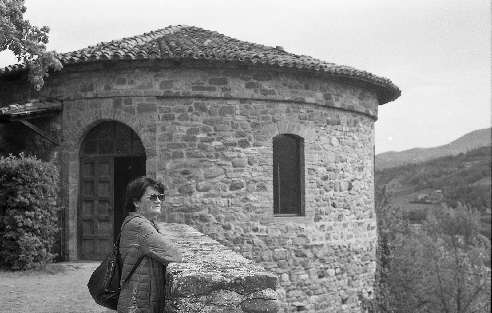

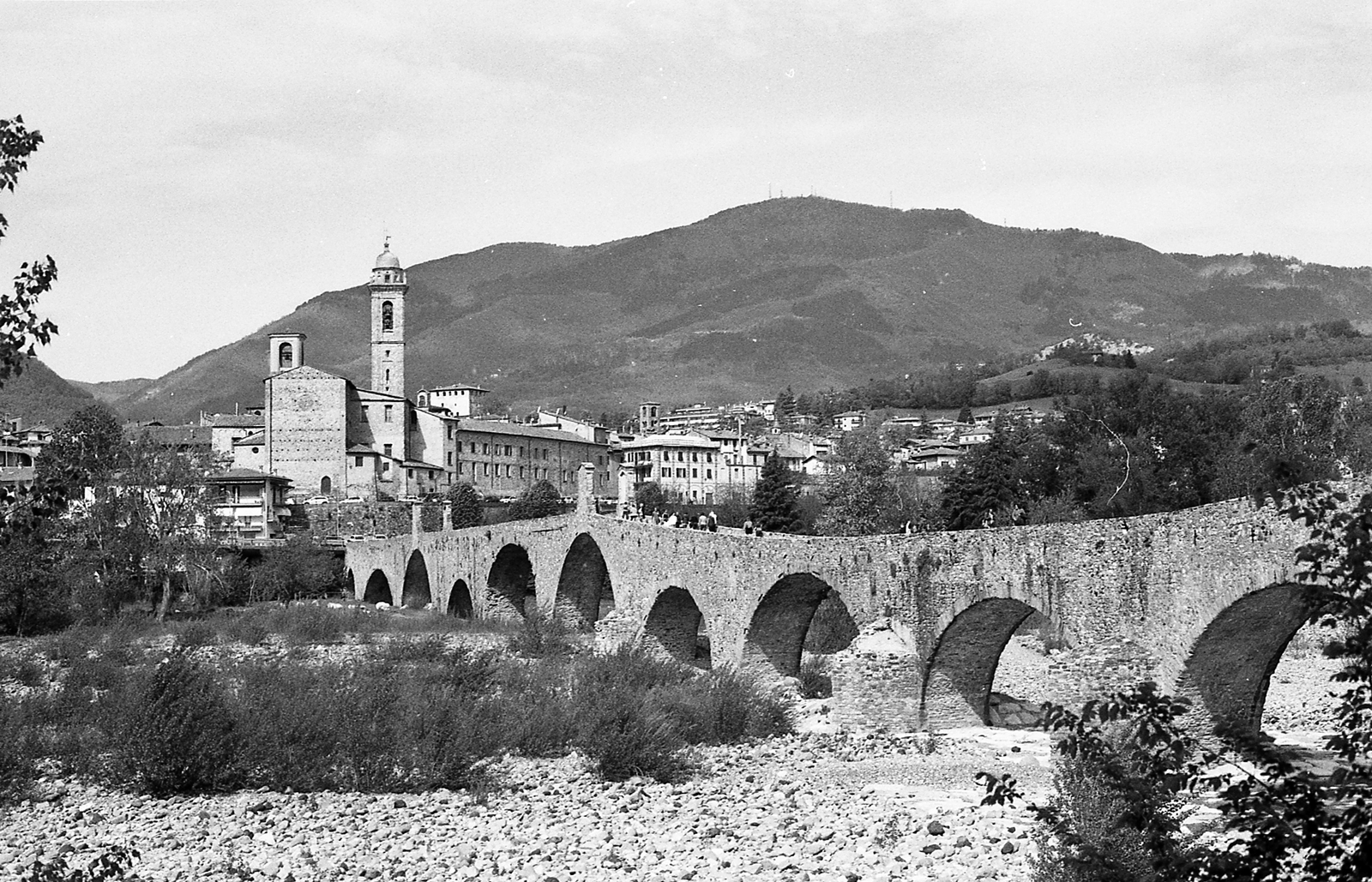

scan with epson V600, (2400dpi + scaling for posting: 1600X1029 jpg 1.4M) with active unsharp mask. No intervention in post (only slightly straightened).
i am very very satisfied. The camera is good, my Soviet lenses are perhaps not the best but I like them
