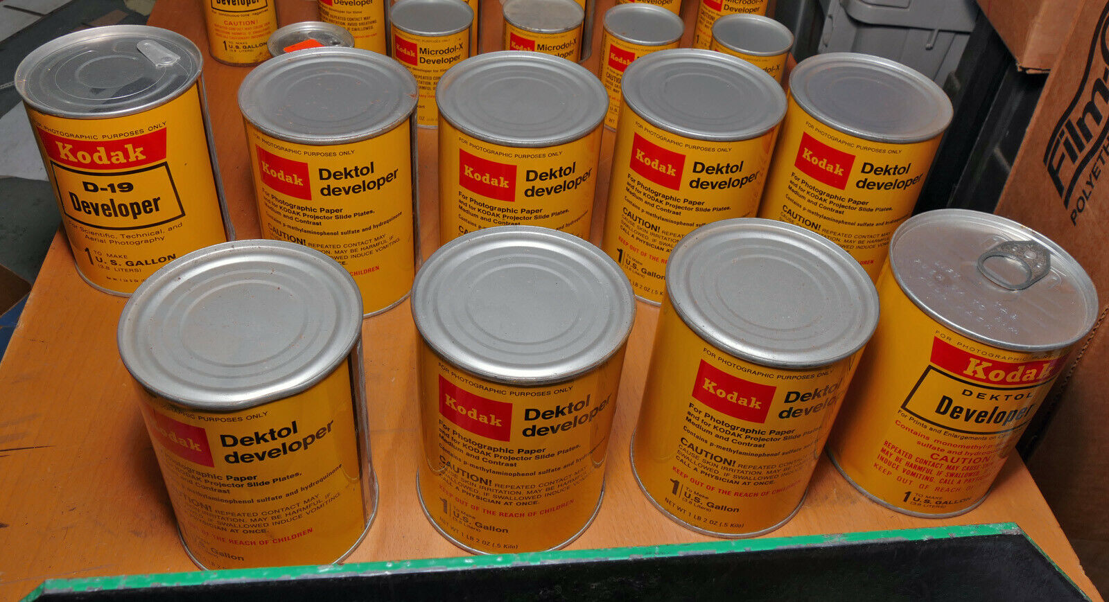

I purchased about 2 years ago a lot of original Kodak chemicals from an eBay seller. I got 9 sealed tin cans of Dektol in 1 gal size, some random other cans I won't use... likely from the late 70s or 80s and it was like $50 with shipping.
Somebody is selling some right now but won't ship it. There are folks trying to charge more to ship than to sell it also unfortunately.
Only offering it up as a suggestion. I have enough to last me for a while but I know the old Yellow Father edition in cans works perfectly.
Here is link 0- buy 5 gals for $60 free shipping.
