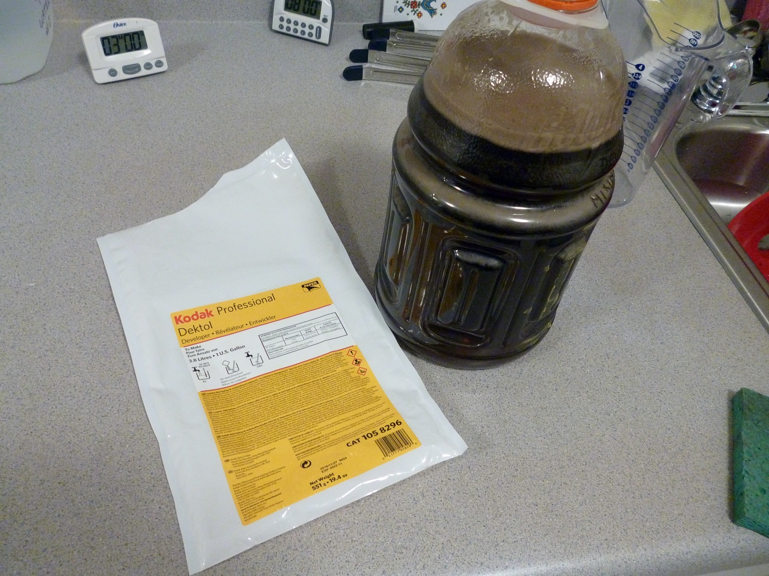

Hello, all.

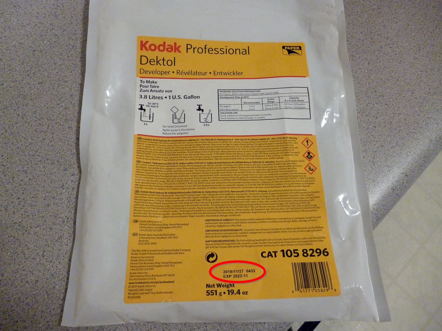

I mixed up a batch of Dektol yesterday and immediately noticed that the power didn't look right. It was tan colored. When I started dissolving it in warm (100F) water, something was seriously wrong. The color quickly became very dark brown and there was a foam froth. The package was marked with a 2022-11 expiration date and I had just received it from Adorama in February 2020. The package was not exposed to any extreme conditions.
Since I'd never seen that happen before, I figured it was a bad package. So, I opened another package (same expiration date) and got the same result. I've been mixing Dektol in this house for 34 years with no problem. Same bottle, same tap water, same temp, etc.
This is the first batch of Dektol I've ever made from the new cheaper non-foil bag and I think the product was bad. Coincidentally, every supplier seems to have Dektol on backorder which makes me think they have purged inventory.
Anyway, I'm wondering if anyone else has experienced problems.using Dektol in the new non-foil packages. I attached a couple pictures. I've searched the web, but have not found anything like this aside from forum posts from the early 2000s. I really don't want to switch to a PQ developer (liquid or powder), which means Dektol is it unless I want to mix my own, which is what I plan to do in the near term. I emailed Kodak and tweeted to their twitter account, and am waiting to see if they will respond.

It seems that this has come up before, but I just searched and didn't come up with much. As I recall, most said that the new stuff, although brown, still worked just fine. Maybe. I know i would not care for it.

I have not used this newly packaged Dektol, but this is how my stock D72 looks like after a week or so, I always discard it and never bother, because it is so cheap to mix..
That does not looks good....might work fine but, wow! not confidence inspiring.
Don't worry about it.
From Kodak Alaris' website:
Update: KODAK PROFESSIONAL DEKTOL Developer / Packet to make 1 gal (CAT# 516 0270)
Recent batches of DEKTOL with date codes of August 2019 or later have been coming out darker than normal when mixed.
This is due to a non-photo active impurity. This has no impact on product performance.
We are working with our manufacturer to quickly bring the color back to its normal neutral appearance.

Thanks for solving the mystery, Matt. For all the searching I did, I never saw that and that's exactly what I needed to know. Unfortunately, because of the horrid color, I already discarded both batches of Dektol that I mixed up and have no more left. On the other hand, it gives me an excuse to try D72.

just out of curiosity, despite how it looks, does it work?
hi Adrian -- mine did not work very well. thankfully the person who sold it to me gave me a refund. ...
